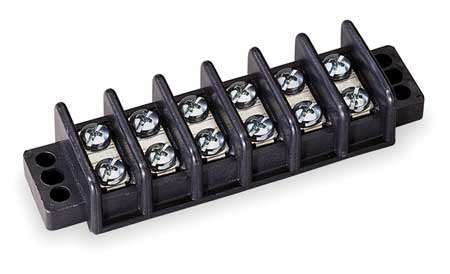

I have already soldered the cables from woofer/tweeter and that makes it a little tricky when installing the crossover, because when I remove the drivers to allow painting the cabinet and so on, I will be hard to solder them to the crossover board when installing them again (cabinet now "closed"). I could need some help how to do this the smartest way. I will put the crossover on the bottom panel since it is rather big.
