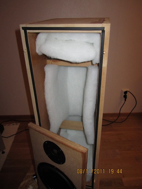

Ouch this will make my head spinn lol, but I will read and consider all suggestions. After the baffle is glued in place with braces and the polyester filling glued into place (I am not sure I need to change anything but probably it can be better) I will putty it and sand it smooth. Then a primer layer and then color + maybe some laquer on top. I will also round the braces, maybe it has a little positiv effect. When ready I will post some pictures of the inside to get it right. For example, should the insides be covered with filling all the way to the front, or do you leave a little space to be sure it is not too close to the actual membrane of the woofer?

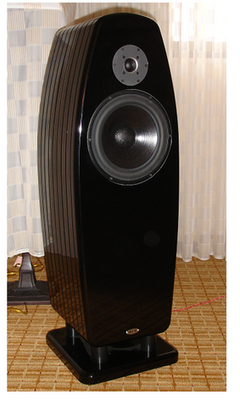

It seem ART from Scotland is using the same unit.Price 12500 GBP :Ohno:

Yeah Dufus, that is quite some asking price! Have not listened to it and maybe it is worth the money, who knows.
Salas: so it has some influence after all, good to know it seems ok to you as it is. It actually has a little thinker layer in the middle section than you specified I think.
First there is a layer going from bottom all the way up to top. Then in the middle a layer from side to side overlapping the bottom-to-top layer. And a little more than 6 cm as specified in the bottom but at the top above the bracing it is full. Se picture for detail:

Matters a lot especially in a reflex. Should work without hindrance. Else you lose much output.

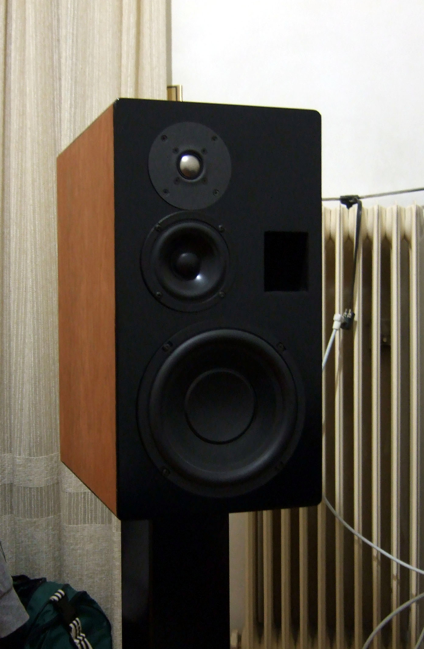

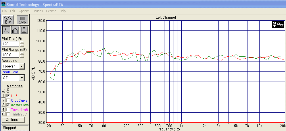

There is the back bounce that can smear your mids penetrating the cone. You should listen judiciously. Here's a speaker made for my brother, he has them stacked away now because he needed room. Maybe you like the color scheme. Good tone, goes deep, but needs drive. See how it dips Z due to car audio subwoofer type 8incher.

P.S. Found its FR chart to be complete since I mentioned it. Interestingly it shows comparable trend in a small room with a friend's Harbeth Super HL5 that I measured once in a different much bigger room at a later time. Red line must have had more octave smoothing.

Thanks Salas, I have a few things to investigate before I am satisfied.
First, the middle part filling, then I will listen to the contribution from the reflex port to make sure it is as good as possible, but probably it is in a good starting point right now.
