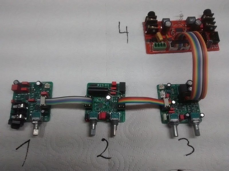

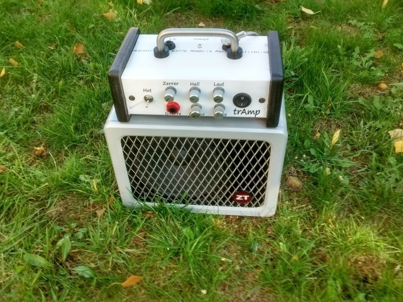

I have built my guitar amps from scratch for a lifetime going the solid state route. This includes circuit design, populating pcbs (SMD mixed with THT parts) and verifying. So I created several modules:
1. input gain stage with overdrive. Switchable "hot" channel for very high distortion (PCB 5x5cm)
2. Reverb/Chorus based on FV-1 chip from Steve Barr. (PCB 5x5cm)
3. Master channel with 1-knob tone control and soft limiter (PCB 5x5cm)
4. Power module based on TPA3118 from TI. Suitable for ca 8/25W into 8Ohms at 12/24V power supply.
Power supply may be any notebook power adapter, a 12V-SLA, 12V-car cigarrette lighter jack etc. ppp.
If you are comfortable with SMD soldering I could send you some bare pcbs.
You will find some useful circuits on ESP homepage.
