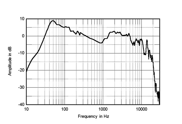

1. listen to plenty of ESL models contrasting pure "full range" designs like the Quad ESL-2912 versus woofer assisted hybrid designs like many ML's. Find out if the bass experience with panels is what you like (maybe better for acoustic then hard rock for some?).
Quad ESL-2912 bass can be terrific driven by the right amps, in the right room with some tracks as Stereophile reported: "Double basses were reproduced with tunefulness and subtle dynamic variations"
