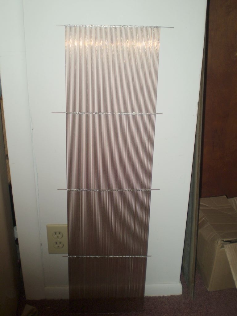

Since You are at the beginning of Your ESL adventure I recommend to follow proven concepts that guarantee a high chance of success.
The imho best in this regard is the use of a flat segmented wire stator, because of:
- easyness and low cost to source building materials
- unburdons You from the important(!) requirement to create a safe and reliable and well functioning stator insulation.
- building requires no special skills, but working precise and patient and every now and then following the tips of the experienced (even if they might differ with Your intuition)
- building doesn´t require highly specialized jigs and tools ... a large plane table will be Your most important and used tool
- allows for easiest ways to segment ... besides the positive effects on distribution character and amplitude response this effectively reduces the burdon on the amplifier. Non-segmented panels when driven through high-quaility audio trannies can be a real killer-load to the majority of amps.
