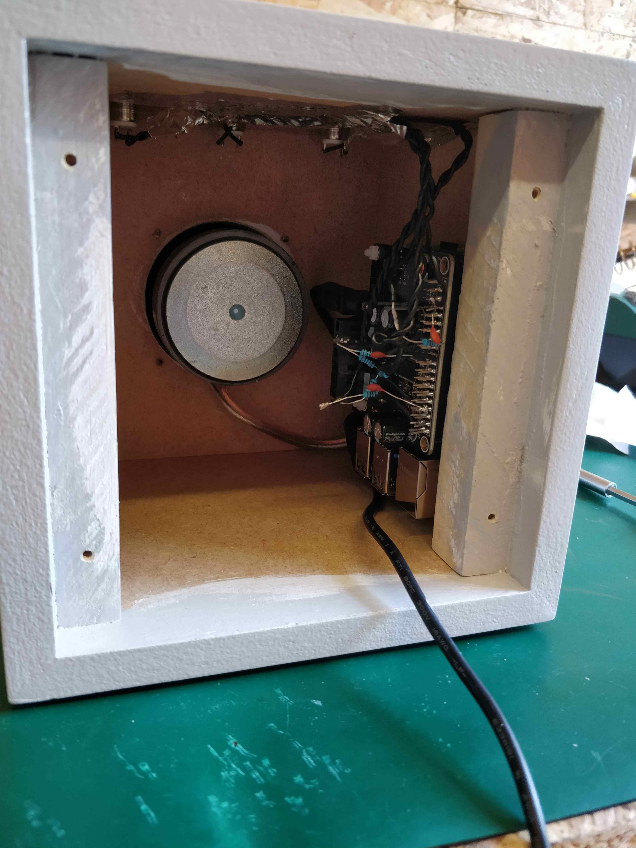

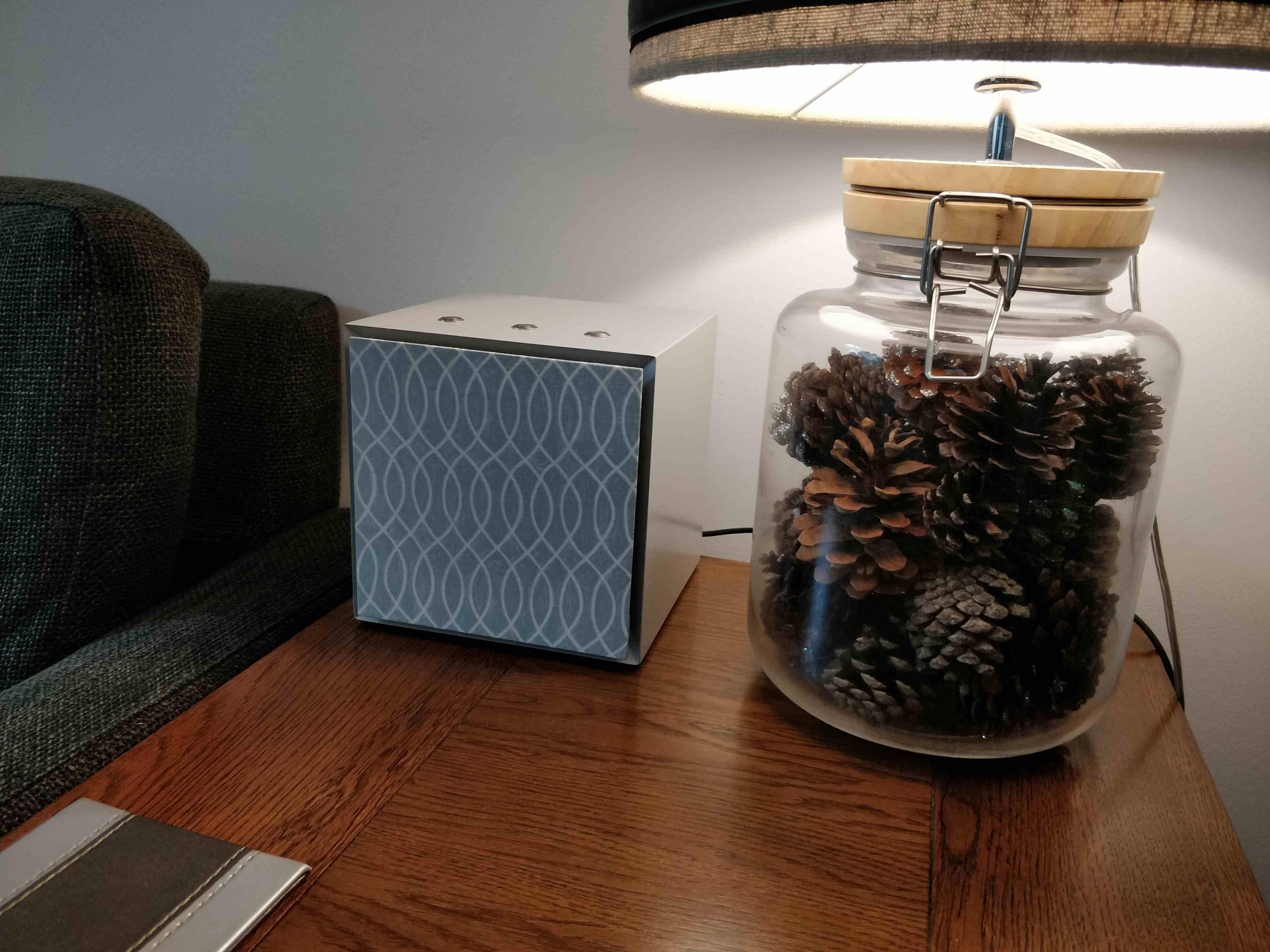

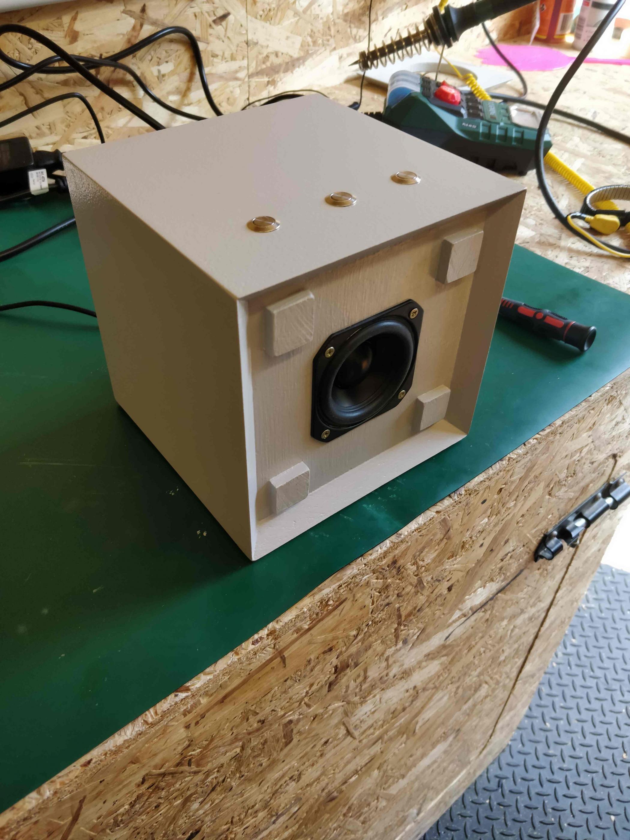

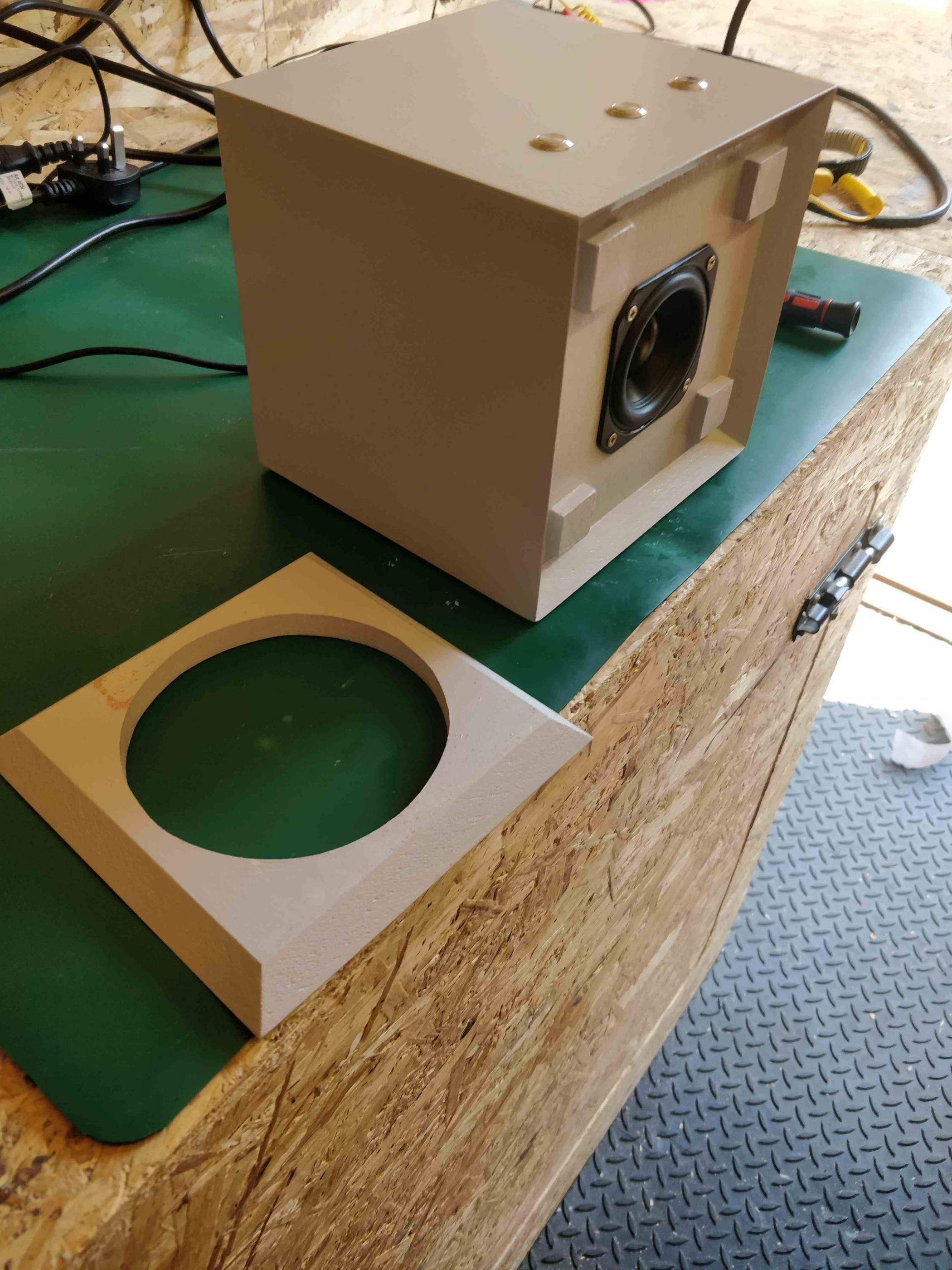

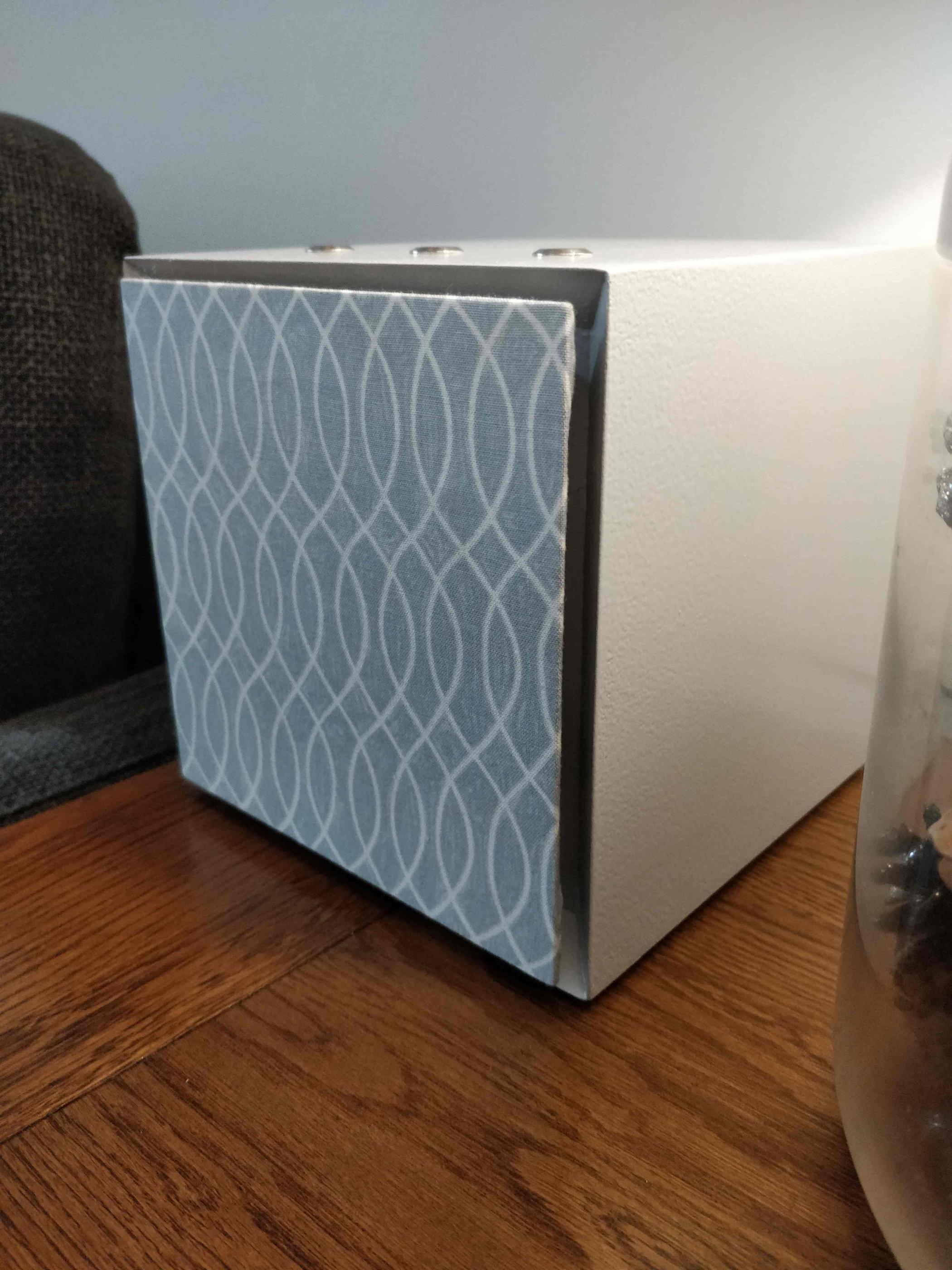

First time posting in this forum , I could do with some advice on how to improve my speaker build both aesthetically and with sound quality, if possible.
I built my speaker enclosure based on this design YouTube
I'm currently using a Raspberry Pi4 , a Hifiberry Amp2, a peerless PLS-65F25AL01-04 full range speaker driver and 3 Gpio buttons.

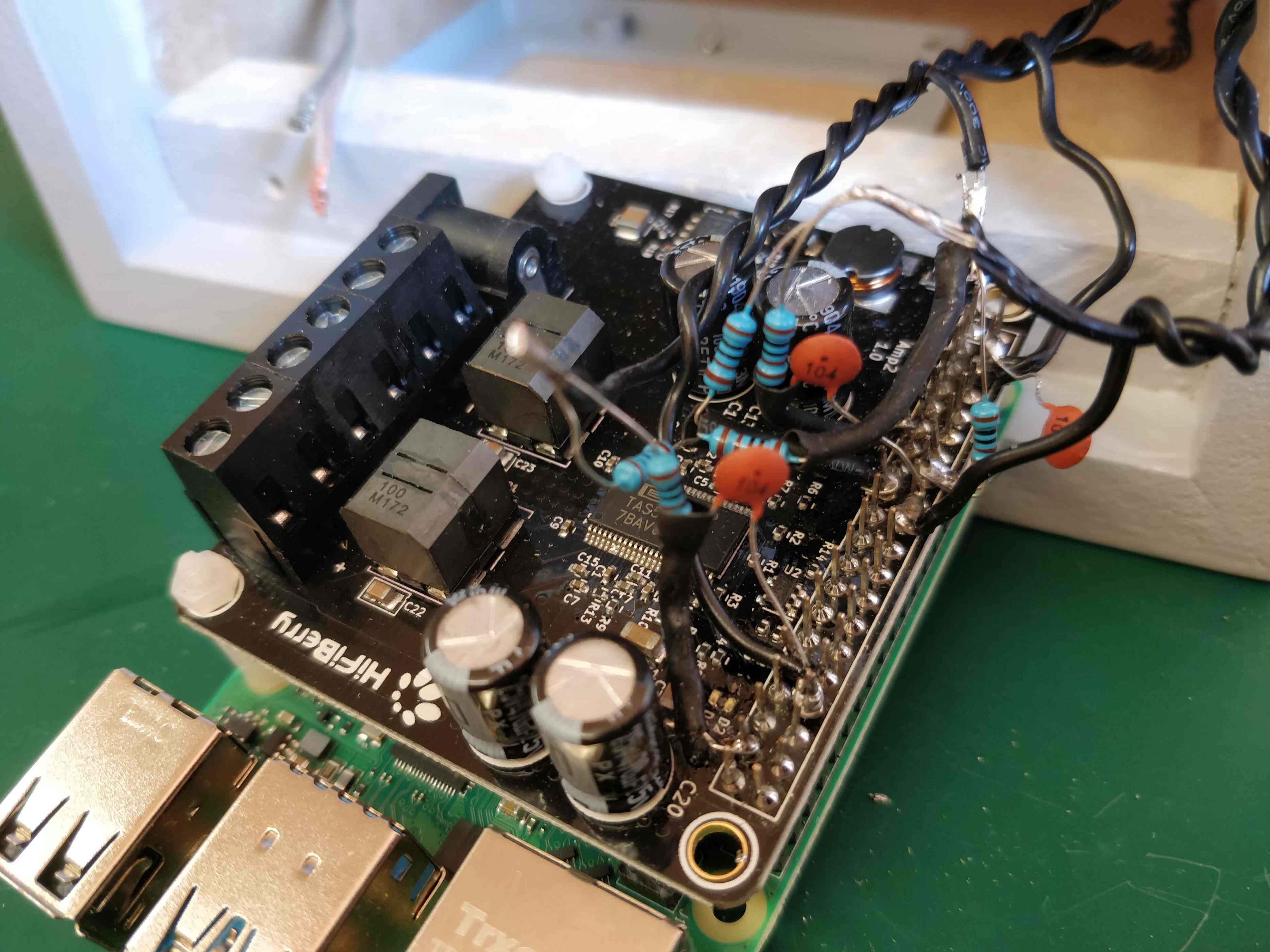

I am using Moode audio for the software side of things which runs flawlessly , I did have a few hardware issues with the Gpio buttons having false triggers , which I resolved by soldering on a low pass filter modification to the Gpio header of the Amp2, details can be found here on the Moode forum Small Speaker project, Gpio problems and how I solved them

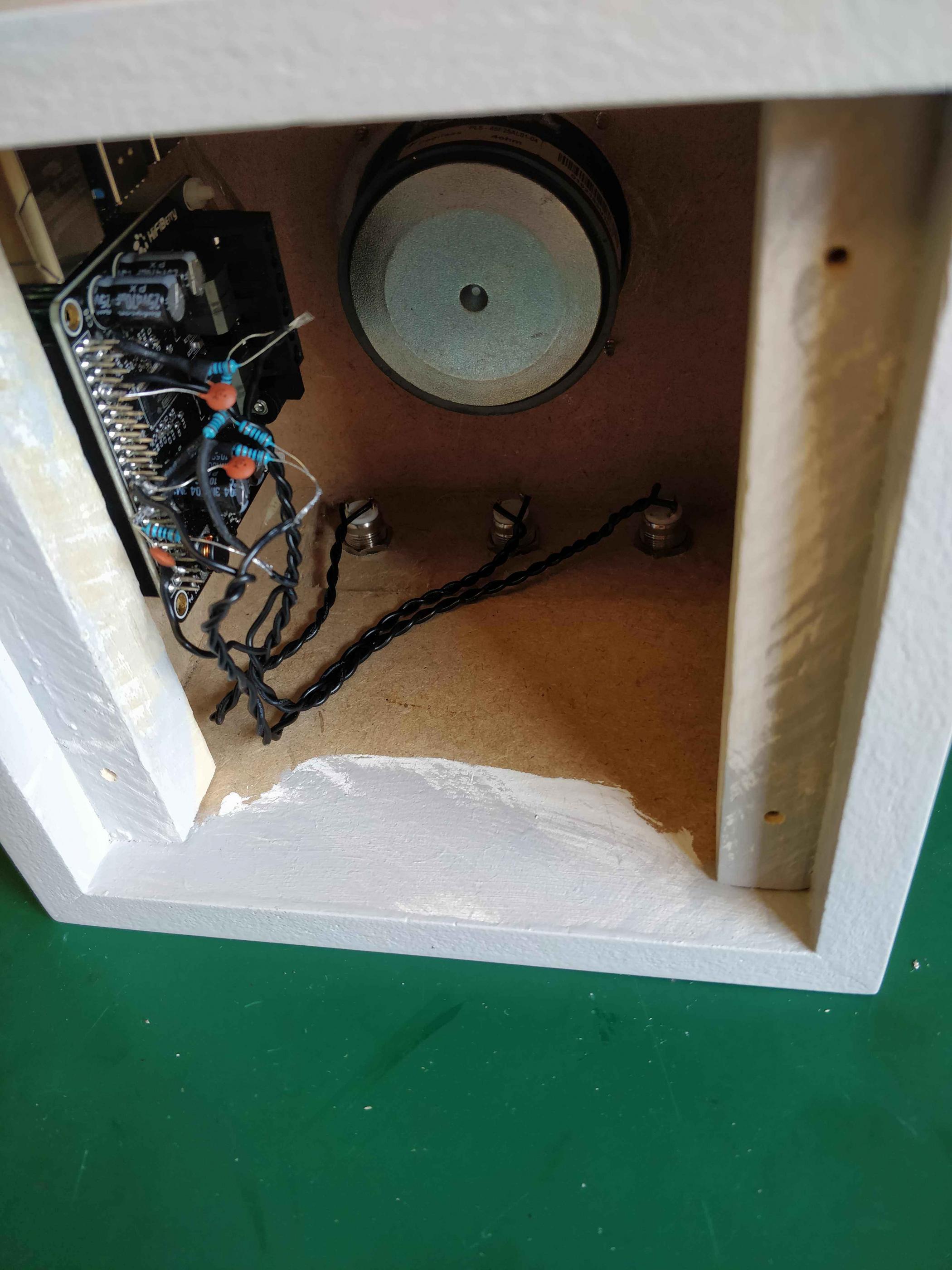

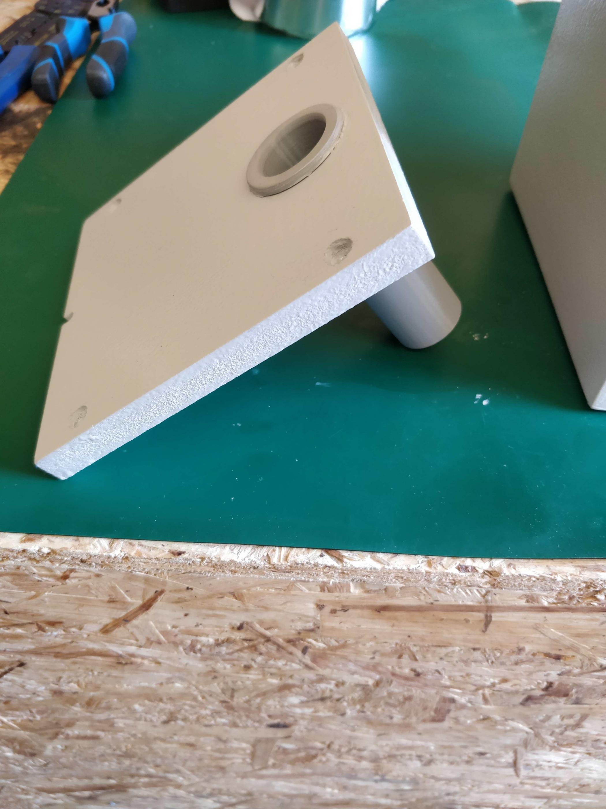

I built the enclosure a shade under the size required for the speaker driver , based on an online calculator, however the port is the recommended size. I don't think this impacts the sound quality to much as to be honest the speaker sound great.
Ok to the matter in hand , I could do with some advice on how to improve my build ! , my wife would prefer the enclosure to be smaller if possible so any advice on how to improve the enclosure aesthetically, how to make it smaller if possible , how to tidy up the low pass filter modification, a possible alternative speaker driver to aid making the enclosure smaller or any advice in general would be very much appreciated

Your speaker looks very nice, congratulations.
Now that you invested time and effort, with a good result, why drop it?
Buy your wife a bunch of roses or a box of chocolates instead.
And enjoy your build 🙂

a box with sloping edges looks more slim........
perhaps some damping material on the walls inside.......
Yeah I did have a thought about padding material but I worried it would reduce the internal size further ( for this speaker driver ) resulting in poorer sound quality .
Chamfered edges might provide an aesthetic improvement , I might consider that for the next iteration.
Rounded or chamfered edges also can improve the acoustics by reducing diffraction effects.
Its also generally agreed a cube isn't a good choice due to resonant modes all being the same, and its common to see all three dimensions different with drivers not mounted symmetrically too - the idea being to create lots of modes all overlapping to reduce any prominent peaks.

The horse's mouth.
http://www.dwdrums.com/images/moonmic/olson_direct-radiator-loudspeaker-enclosures.pdf

Generally spoken, to make an object appear smaller (or even to make it disappear), it is recommended to give it a dark or black surface. The blacker, the smaller...
This may not apply in a white environment, though. (think "2001 a space odissey")
If you try it, make sure that the color you choose harmonizes with your interior (a blueish black is awful in a wooden interior)
