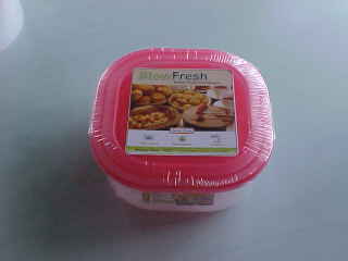

Third method is the glue used to coat sticker sheets, that sticks...we get stickers printed on coated sheets, which are then die cut, we peel off the stickers, and stick them to the containers.
The adhesive sheets are backed by release paper, it is white top, then adhesive, then backing paper.
For jewelry boxes, we used to make a laminate of velvet fabric, sticker adhesive, LDPE foam, release paper and die cut when dry (next day).
That is a sample...I make them off and on at my plant, no need to show off really.

The brand of sticker adhesive we used here was 'Emdilith", it looks like PVA wood adhesive, but smells different, and cannot be diluted with water, you need screen printing ink solvent to dilute it
No ties to the brand, it was given to help you find a similar product in your country if needed.
The sticker on top of the container was printed on ready 'gum sheets' which claimed to be coated with 'hot glue'.
Such an adhesive may be available in handy packs in your country, here the smallest I could find was a kilo...ask in shops selling printers' supplies.
