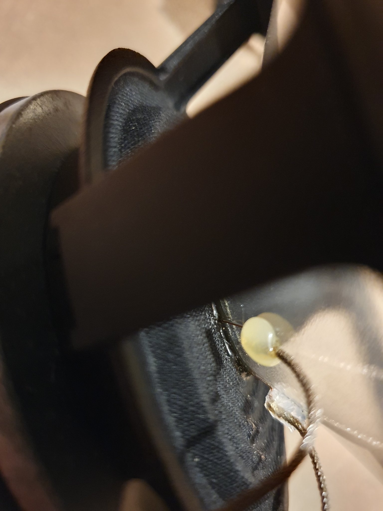

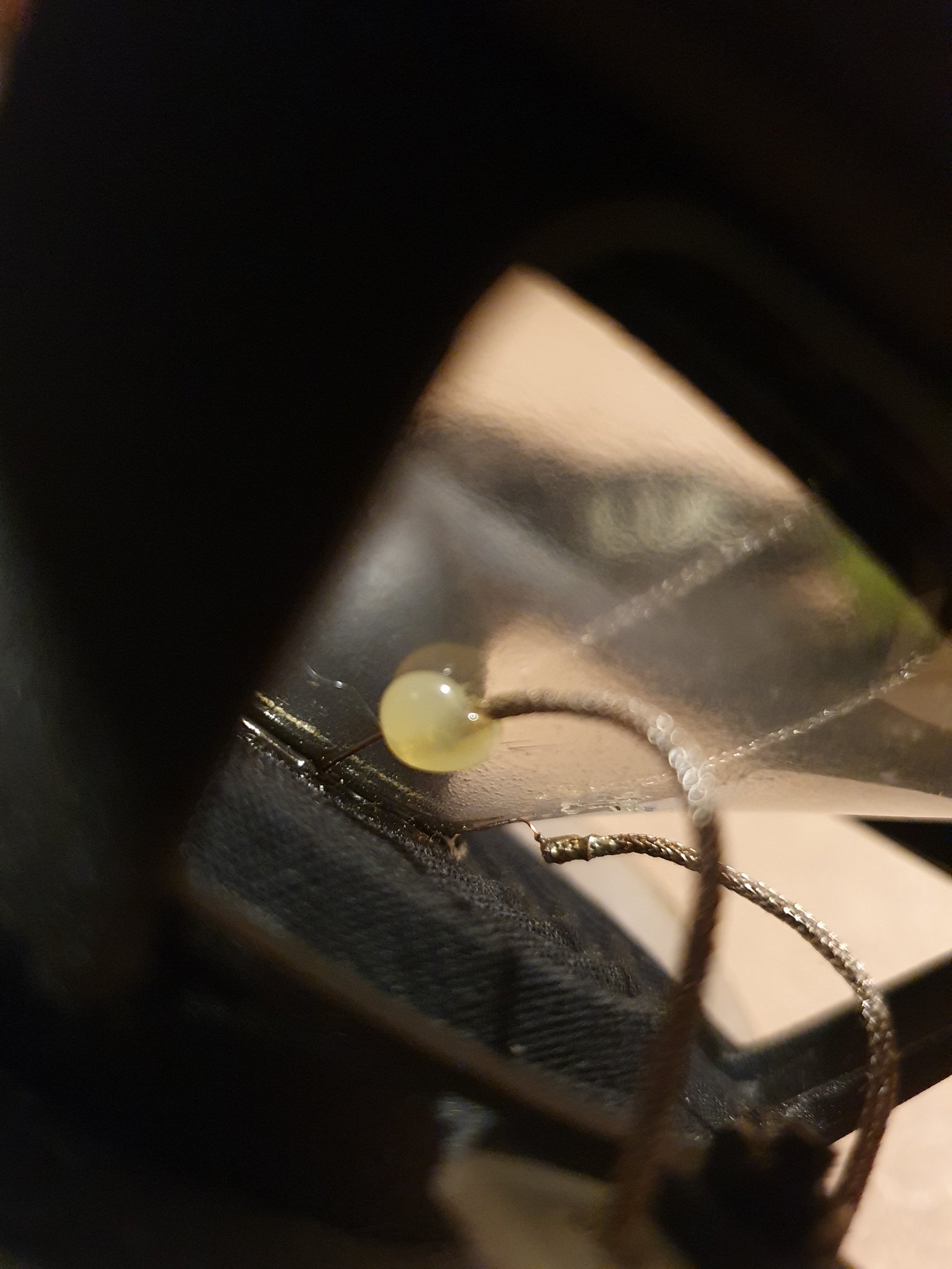

I have a driver that needs fixed, an Usher midwoofer from an S520. One of the tinsel leads has come adrift from the voice coil lead-out wire. Here's a picture:
The voice coil lead-out wire is glued to the cone, which is clear plastic of some sort. I plan to use a scalpel to scrape the lead-out wire to expose a little more copper, and also to lift the end of it clear of the cone, before attempting to solder the tinsel lead back onto it.
The tinsel lead has a big blob of yellowish glue on the end, which was supposed to hold it in place. That'll need to be removed, and when I've resoldered the wires together, I'll need to glue the joint down onto the cone with a fresh blob.
Have I got all that correct? Any advice? What type of glue would be best for regluing the joint to the cone?

If you have to remove enamel from copper wire scraping might do the job if the wire is thick enough. If it is not sufficiently thick and you are able to free the wire far enough, this is a trick to remove enamel.
Take a white Paracetamol pill (yes, the headache killer). Put the wire on the pill and your soldering iron tip on top of the wire. The pill starts to melt with the wire embedded in the smelt. After a few seconds your wire is clean. This also works for stranded enamel wire (Litze). As far as I know it is the only way for stranded wire.

The glue appears as hot glue to me. On a paper cone I use hot glue. On a plastic cone I am not sure. Silicone would do as well. Both have the advanage to be reversible. Hot glue more so.

I'd be wary of attempting to scrape the enamel off the thin voice coil wire with a scalpel for fear of damaging the wire.
That makes jlinkels' interesting enamel removing method sound very inviting.
For a polypropylene cone like that of the Usher S520, this particular silicone adhesive may prove more effective than hot glue:

I'd also be wary of any normal silicone that includes acetic acid. That kind is not typically used on delicate electronics since it can corrode copper. If you're going to use silicone, look for one that specifically says it's electronics grade.
That would be a 'neutral cure' silicone which releases alcohol on drying rather than an 'acetoxy cure' silicone which releases acetic acid.

Well, good news - I think I've managed to fix it.
I didn't use paracetamol after all: when it came to the crunch, there just wasn't enough room to try it safely.
So in the end, having lifted the end of the lead-out wire off the cone, I just scraped the raised portion with the scalpel very gently. I managed to get a decent area of exposed copper quite quickly. I feel a bit of a numpty for not following any of the advice offered, but the scalpel felt like the least risky option.
The thing that took longest was getting the tinsel lead positioned correctly, in a way that still allowed the soldering iron safe access to the joint. The key was lots of practicing with the iron cold, until I was confident that I could get the solder and the iron into position without the tinsel lead moving. And when heat was finally added, everything stayed steady and the job was done in a flash. Here's a pic of the result:
And here it is with some neutral cure silicone added (courtesy of my local Screwfix 😄).
The voice coil is measuring a steady 5.2 ohms, at the terminals. I'm going to let everything cure overnight. Tomorrow I'll put the speaker back together and try it out with some music. Fingers and toes crossed!

Unfortunately, there's still a problem. After a couple of days playing the Ushers, (and marvelling at how good they are!) I started to get a buzzing noise from the repaired woofer last night, on bass tones.
I've removed the woofer from the speaker, this morning, and had a poke at it. The silicone blob seems rather loose and floppy. It's possible to wiggle the soldered joint around a bit, despite the silicone blob, which concerns me I'm wondering if there's an adhesion issue: polypropylene has 'low surface energy', apparently, and many adhesives, including silicones, don't stick well to it. On the other hand, it could just be that the silicone, a low-modulus type, is too floppy. I don't know exactly what's causing the buzz, but I think I need to have another go at this repair.
I'm planning to cut away the silicone blob. If I can get the cone clean of it, I'm thinking it might be smart to apply a dab of a suitable plastic primer to it, before re-gluing. Maybe this primer: https://www.amazon.co.uk/Rust-Oleum...xt&ref_=fplfs&psc=1&smid=A3P5ROKL5A1OLE&gQT=1 It's normally used prior to painting, rather than gluing, but it does at least seem to be suitable for use on polypropylene.
To re-glue, I'm wondering if I should invest in a little hot-melt gun, and try that. The hot-melt blobs on the other leads seem very firm, compared to the silicone - maybe that's the way to go?

I think the silicone may have left a residue preventing any other glues from adhering. The trouble is that you need pretty strong solvents (or commercial silicone removers) to remove it and they might damage the cone. But hopefully I'm wrong.
FYI, that yellow stuff definitely looks like hot glue and coincidentally I only recently looked at a pair of Peerless woofers (with polypropylene cones) in a pair of DIY speakers I made years ago, and they also had the same glue in that position. (I thought there was an issue with the wires but there wasn't).
You don't need to buy a glue gun. You can buy glue sticks and heat them with a flame, quickly transferring the glue to the leads using (say) a heated screwdriver to keep it melted. The gun might not fit anyway. I have a gun but use hot glue like this on occasion.
