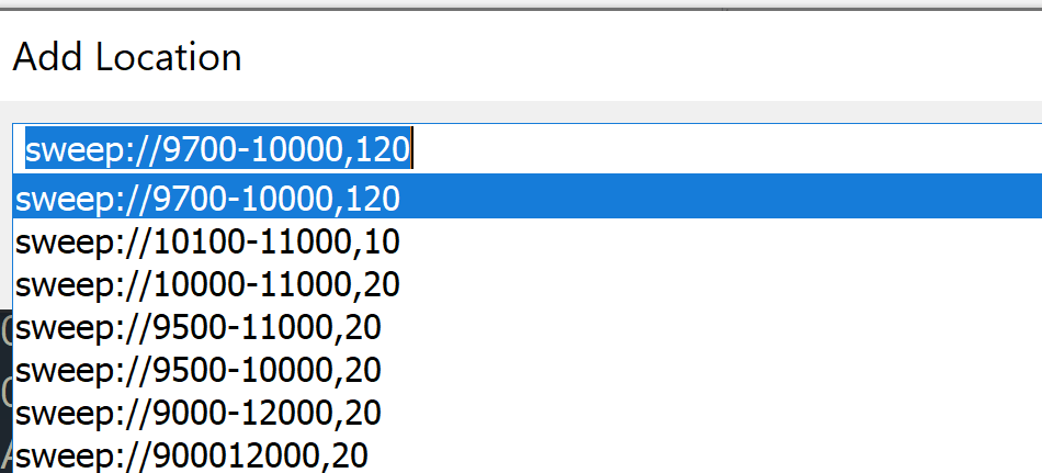

Id still recommend the Foobar sweep as it is highly configurable, eg you can dial in a sweep of say 7000-7160Hz over say 22secs ; then with a stereo DSP target the affected side.This is the online tone generator I use: https://www.szynalski.com/tone-generator/

With the Foobar sweep you can just go +1kHz above your hearing range to be sure its covered, but be very careful with the volume. Dont go above a volume comfortable in the midrange or your upper hearing range might rapidly decrease.

Foobar > File > Add Location > sweep://3600-5000,20It's actually multiple tones within about a 1000hz range, for me..around 3600-5000
