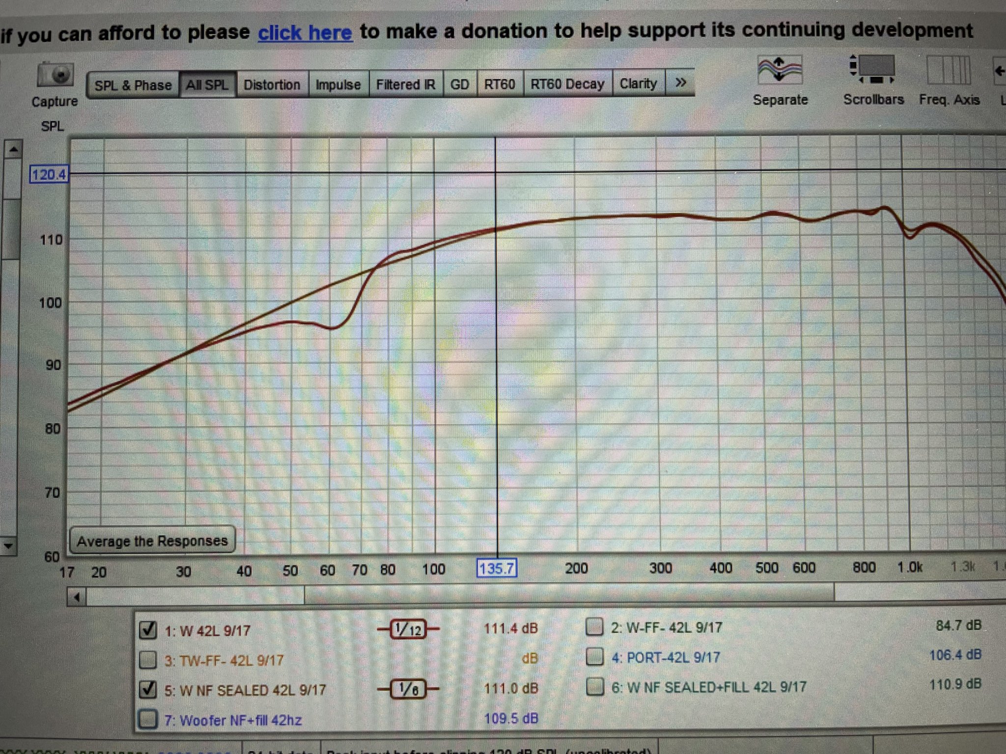

OK, finally sat down to do some computer work, and I want to show the results. The new configuration is a 42L box (earlier was 84L) with two 75mm ports, 36mm deep. 36mm is the baffle thickness, so I couldn't go shorter without arduous gymnastics but it seems alright. According to the above exchange, I compensated the port -6.8db, which is the original -9.8 reduced by 3db because there are two ports. No baffle step, but it's looking much better. The first photo is woofer/port/summed. The second shows sealed woofer vs ported. The sealed response is lovely and smooth but DOA in the bass department so I definitely think the ports are necessary. Third shot shows the earlier response in the 84L box, and you can see the 1-2db gain in the midbass ending with a plummeting response below 80hz, which it seems would eliminate the need for a HP filter on the woofer?
Looking good! Maybe tune port a bit lower if the system is going to be used in medium-to-smmall rooms or near the wall.

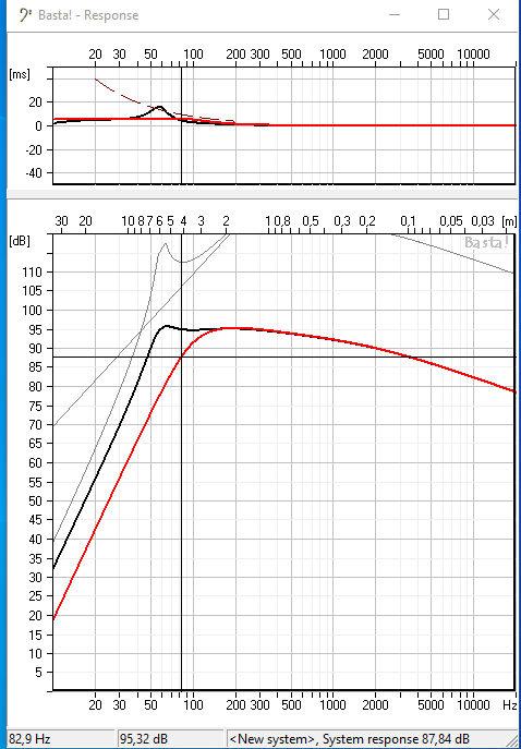

I added two sims, one of your ported system, black line = ported, tuning optimised to 60Hz (the summing of two ports adds 6dB not 3) and red line = one closed box 30l with active HP Q=1 fc=95Hz. What you can observe is that max output above 100Hz of both systems aren't far apart, 3-4 dB at 100Hz in favour of the ported enclosure. But this is sub territory still, so of practically no concern.
Also interesting is that the group delay of the ported system becomes problematic at 60-70Hz (audibility threshold of 0,8/f). Which is not a secret with higher tuned ported systems by the way.
One last thing, cone movement reduction. At just below 50Hz the closed box is behaving better in any way (meaning: for a given SPL, cone movement is less with the closed system than with the ported system). The active HP takes care of any excess cone movement. The red curve shows a lot more distance from the respective grey curve than the black curve from the grey curve belonging to the ported enclosure. I didn't notice any attention for better midrange performance (copper rings or caps or low Le design) in this driver, so I'd do a lot to keep cone movement to a minimum. But these are just my 2ct.

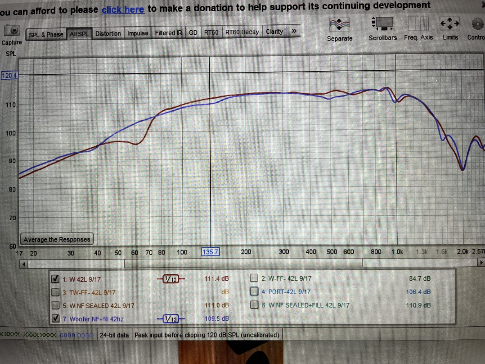

The simple approach to this is overlaying the port output on the woofer output output at very low frequencies <20Hz. They have to be the same, since the woofer is in fact shorted by the port at frequencies 1/2 of fp.
Your port curve however is (you guessed it) 3dB lower than the woofer curve. Remember that doubling a radiating area leads to doubling the SPL at some distance (about 5 times the size of the radiator).

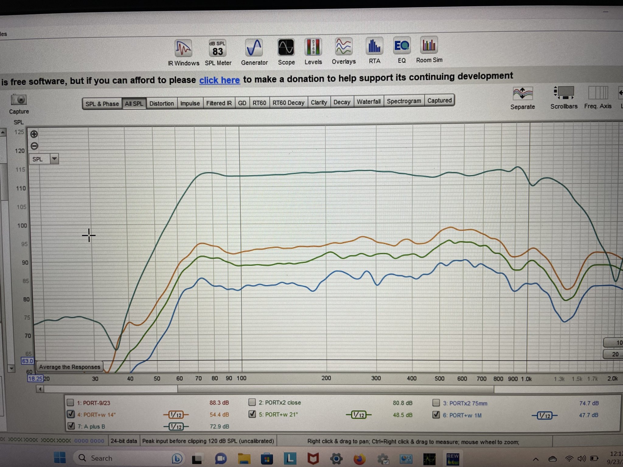

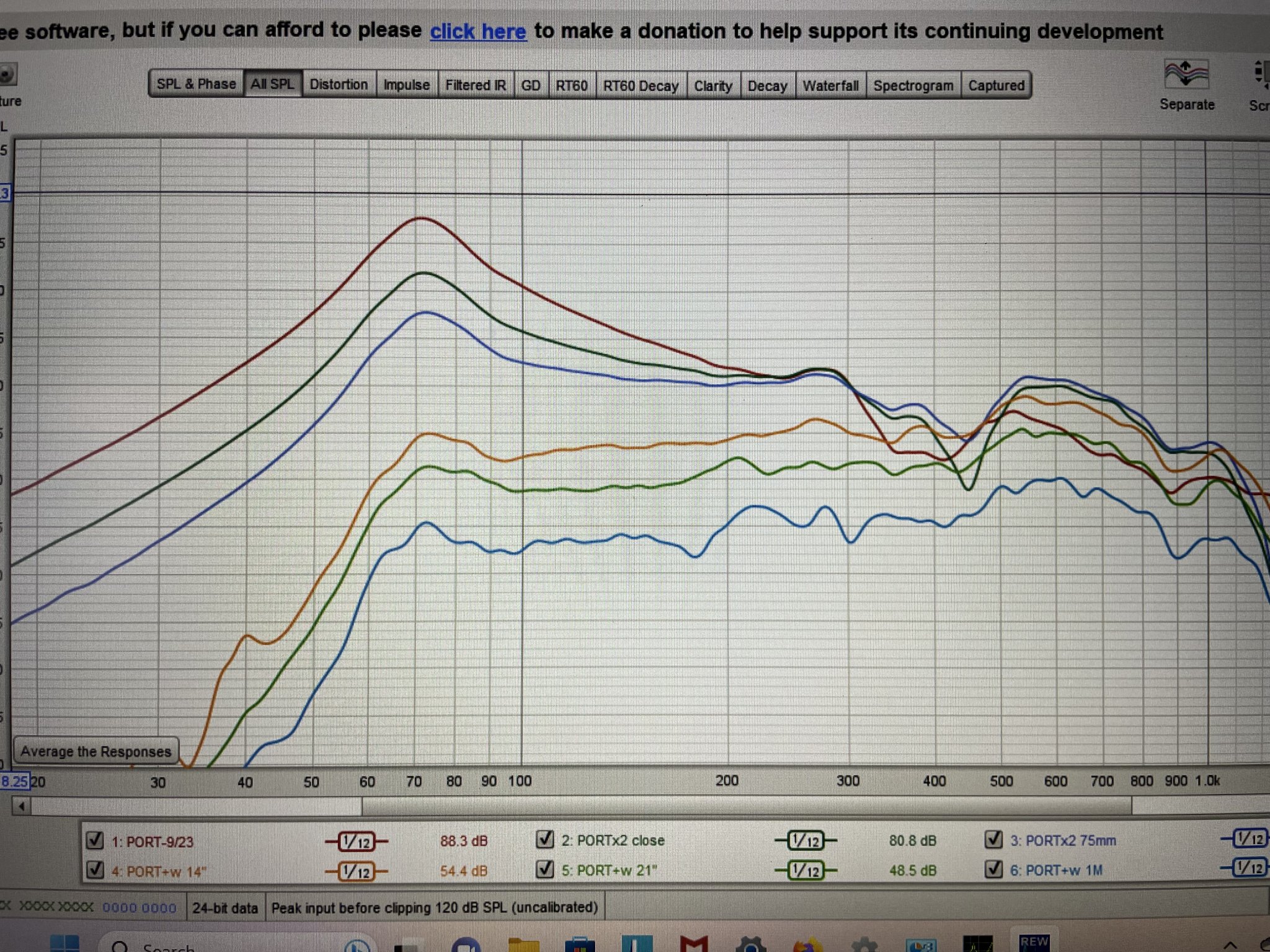

Alrightie, so I went and shot a whole bunch of sweeps just to compare what happens in various positions/combinations. In the first pic, from top to bottom, we have:
1. Single port, flush w/baffle
2. center between ports, 2.5cm from baffle
3. center between ports, 7.5cm from baffle
4. Port+woofer, 35cm
5. Port+woofer, 50cm
6. Port+woofer, 1 meter
What you can see is that the single port measurement is the loudest, and measuring between the ports has more of a cancelling effect than additive, which is what I would expect, so I'm discounting them.

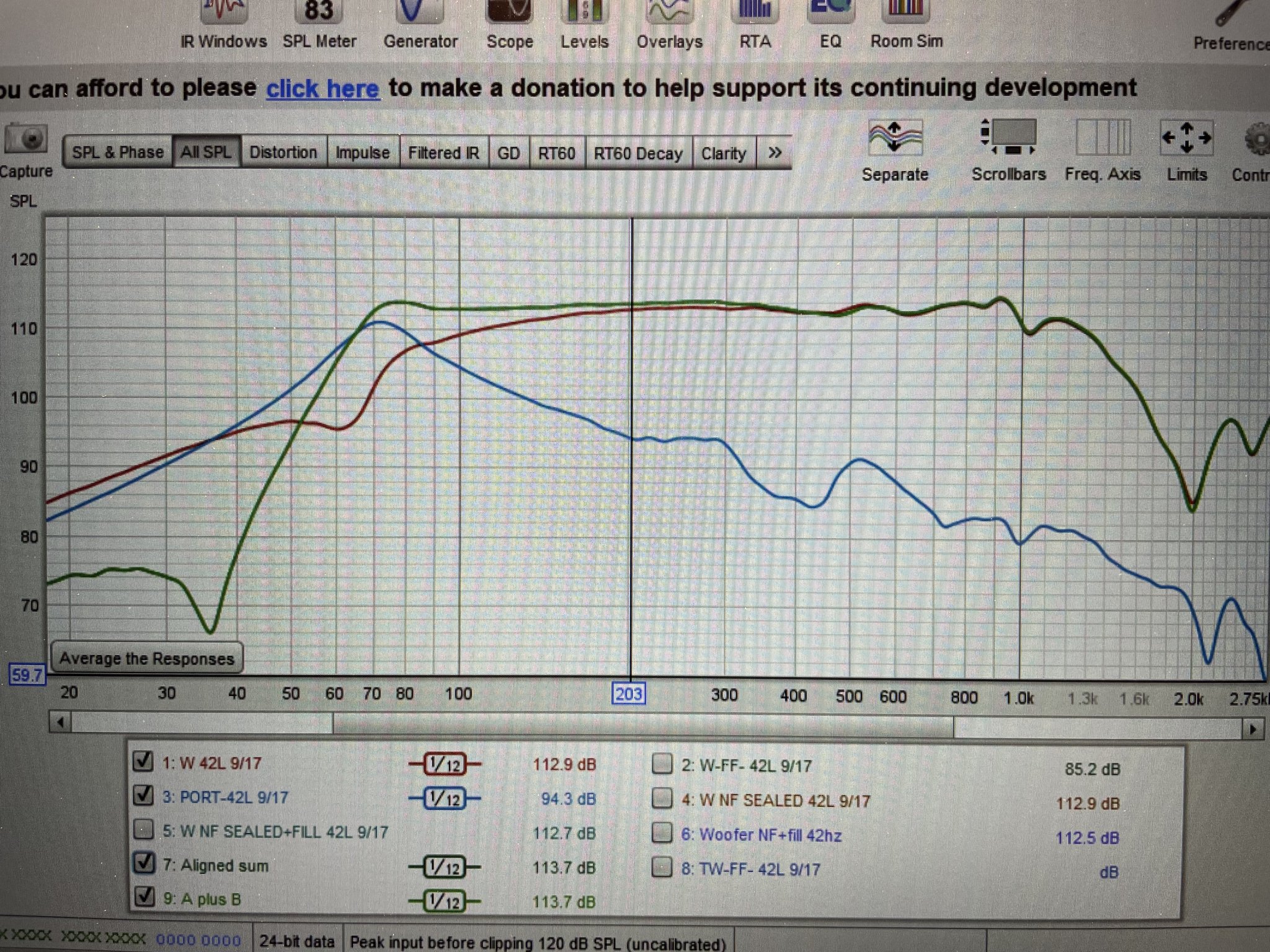

Moving to the lower three (combined), What I see is general agreement with the summed curve from earlier,which is shown in the second pic, with a bit of a sag above the port resonance, but not too bad. I'm concluding that my earlier summation is probably pretty close. The 1m measurement is showing reflections after 8.5ms, but the gated response does me little good right now.
I guess the midbass sag is telling me I need to tune the ports a bit higher, maybe 80-90, but I want to see if I can make this work.
