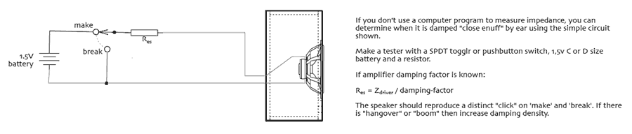

(Qts'): (Qts) + any added series resistance (Rs): http://www.mh-audio.nl/Calculators/newqts.html

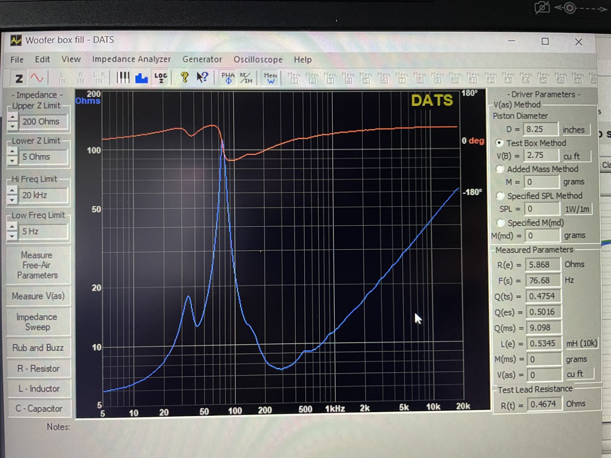

It looks to me like your cabinet has some extra damping (volume filled with polystuffing?) which is losing a bit of gain from the port. The dip at the port tuning frequency ought to come down towards the driver's DCR.
Also, there's something going on at 500Hz that might warrant attention. Likely a panel resonance, or maybe an internal standing wave.

Yes you're right Chris, I added a bunch of cotton and acoustastuff to tame a second port peak at 150 that was wreaking havoc, and to tame some internal resonances. It did the job on those issues, but it's not ideal and is definitely siphoning off too much energy.
But that setup is history now, I'm recalibrating with a much smaller enclosure, less damping, and different port tuning. I haven't had time to set up and measure yet, might be able to get to it tomorrow but Saturday for sure, I've got my fingers crossed.
I'm on the fence about what I'll do if I can only get a nice response down to 80hz, to me that's really high as White Dragon was inferring. Like I've said before, my little standmounts with 6.5" Satoris probably hit in the low-mid 40s, and I don't want to live without that juicy fat area 40-80hz, there's a lot of beautiful stuff happening there!

I assume none based on 'flea power', but these type amps typically have a high output impedance (low DF) which while it interacts with the driver's specs a bit differently than a simple series resistor we can design cabs using it; for example if it's a matching impedance it could have up to 8 ohms, which can raise this driver's effective Qt = 0.84! and higher if there's any wiring, XO components added resistance.
This makes the cab much bigger and in theory tuned much lower, but for max bass it must be tuned to actual Fs in box, which in turn can be quite 'boomy'/'one note' without some form of EQ/critical vent damping, so looking like it's best to use sealed, though need to know its actual output impedance to be sure.
