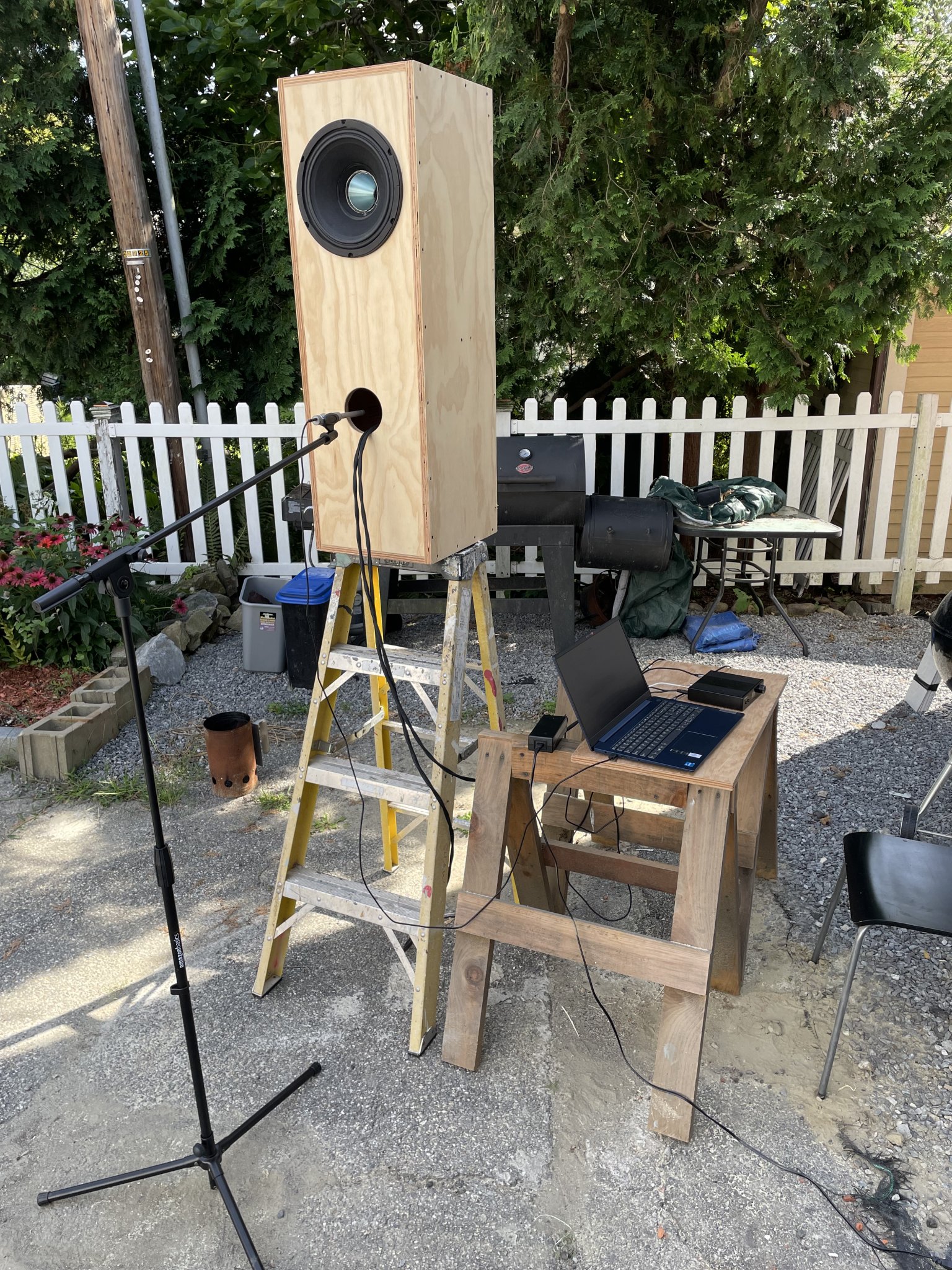

Hello everyone, I started a thread about this project several weeks ago, and the responses were very helpful, thanks. I'll try to be as concise as possible to present my dilemma.
This is my first scratch build. The goal was to create a pair of speakers with minimum 94db sensitivity using a coax driver, to pair with an Alan Eaton SET45 amp, which is the epitome of "flea watt" at <2 wpc.
I ended up choosing the Radian 5210, a 10" coax with a very good reputation. Even though it looked anemic below 100hz, even 150, I thought with proper port sizing and fill I could get it to work and be pretty solid from 50hz and up, and since I use a sub I wasn't worried about these being bass monsters.
I've worked very hard on this project, all the while thinking that the satisfactory response curve was there to be found, if only I could dial things in and measure them well. Yesterday I did another round of measurements, as I'm getting more competent with REW and wanted to start clean and really see what's happening with these speakers.

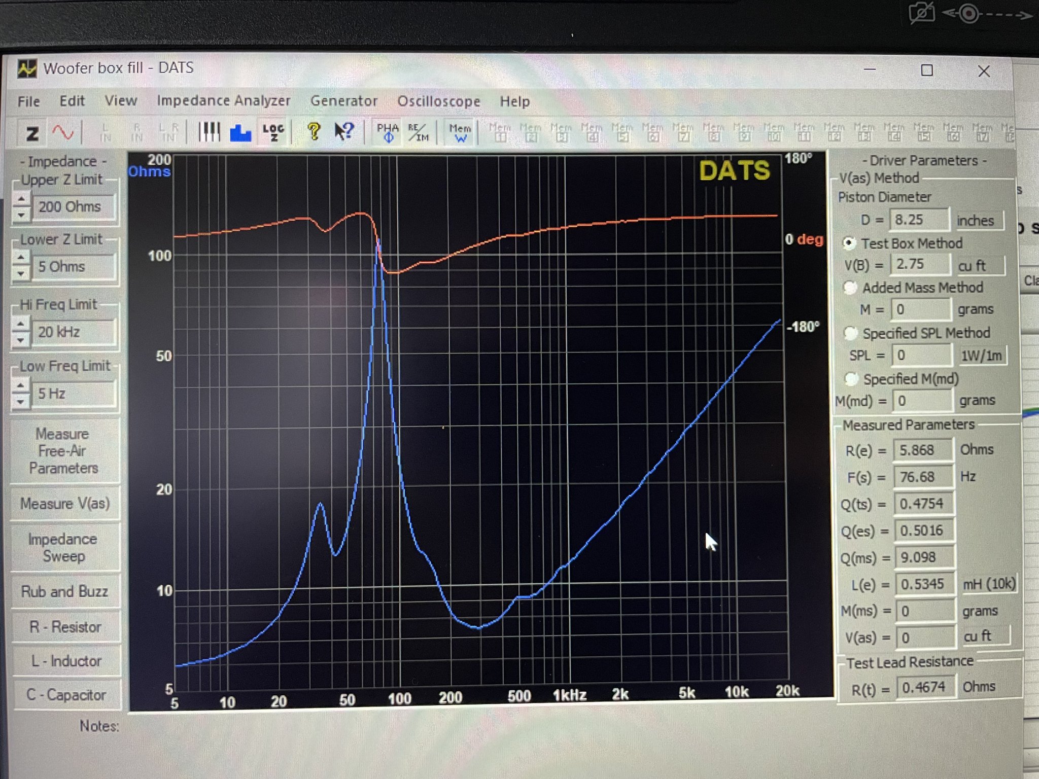

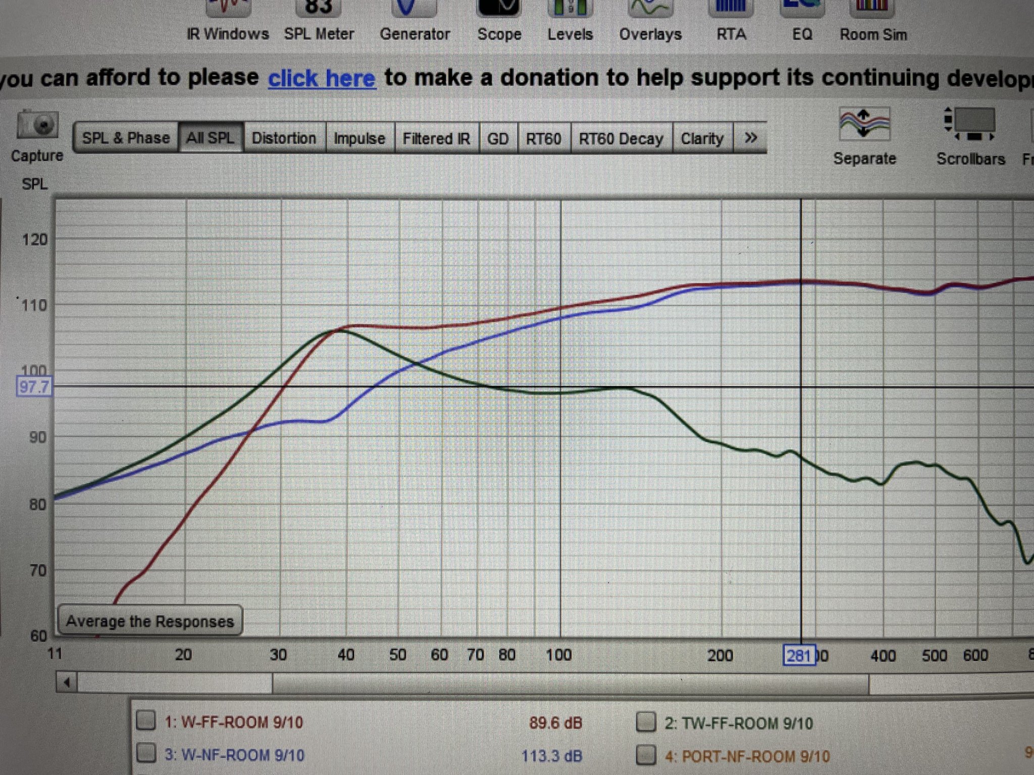

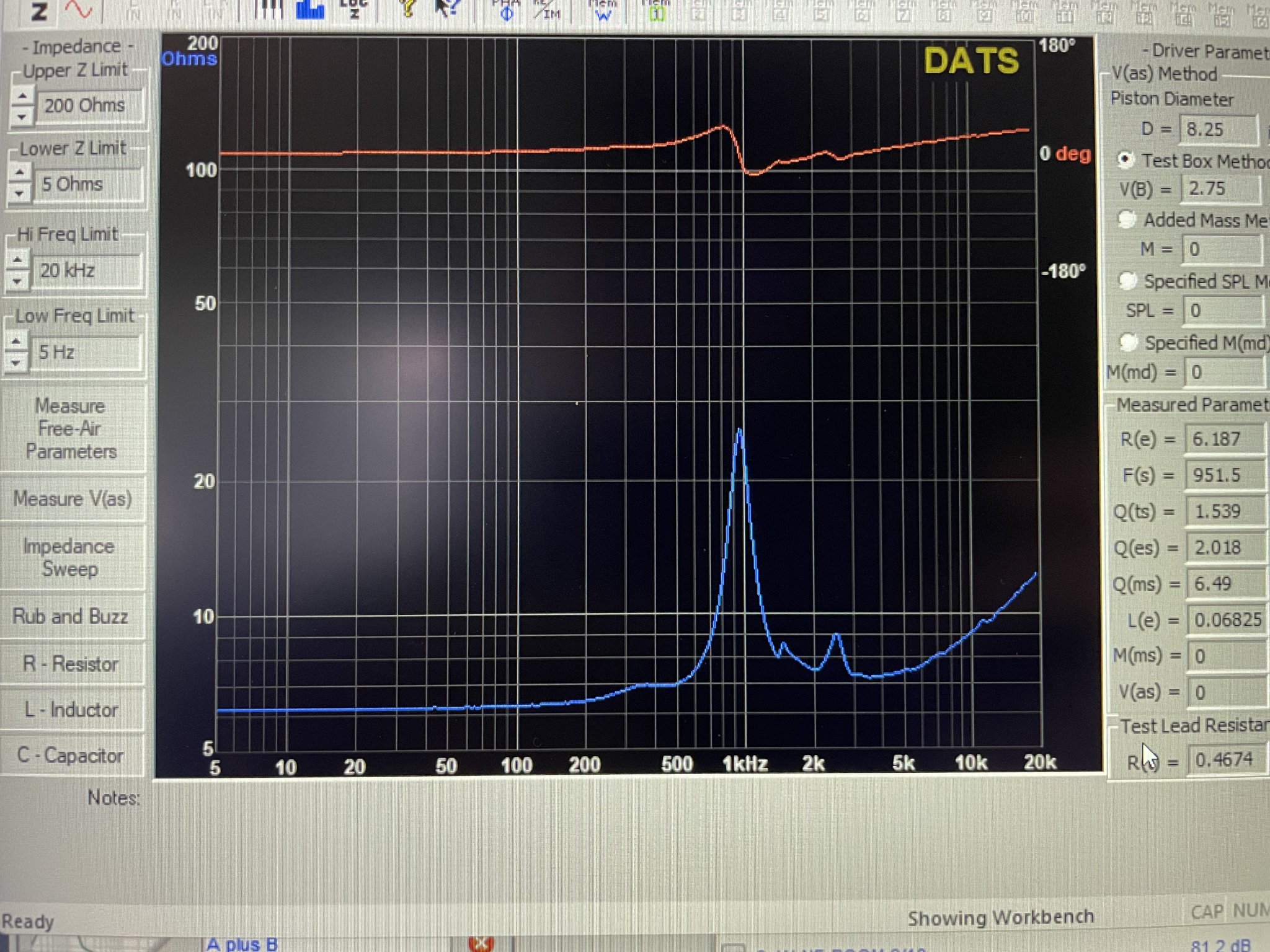

Below I've posted the latest results, showing impedance and T/S parameters, and also the results of my summed port (compensated -6.4db) and nearfield woofer. The overall speaker consists of the Radian 5210 coax in a 3ft/cu box, with a 4" port tuned to 42hz. The problem is the rolloff starting at 170hz, eventually losing about 7db from 60 hz down. I don't know of any way to compensate for this without a correction network that would attenuate the woofer response above 80 hz, which means I'd lose 6-8db in sensitivity (woofer is 96db sens), and a catastrophic loss of 16db +/- for the tweeter, which is 105db. I guess it's basically a baffle step correction, but I don't have the headroom to lose that much.
I realized yesterday that this probably just isn't going to work, because you can't get blood from a stone, and that driver just doesn't want to go low, and it was my rookie mistake to think that I could trick the system by tuning the box and port to prop up the response below 100hz.
So I'm asking the community, am I correct in my assessment, or is there something I'm missing? I'd rather start over and cut my losses than keep beating my head against the wall.

Looks like standard baffle step loss of 6dB to me. Increase the lowpass inductor until flat, and attenuate the tweeter until it matches.
These are near field measurements right? So this is not baffle step you’re seeing. Bad alignment sure, as the impedance curve is not what you’d expect either.
Tune it to 70-90Hz, maybe a tad higher. You could consider a small enough closed box. You are on subs, so you’ve got everything up to 100Hz covered anyway. This driver isn’t meant to go low.

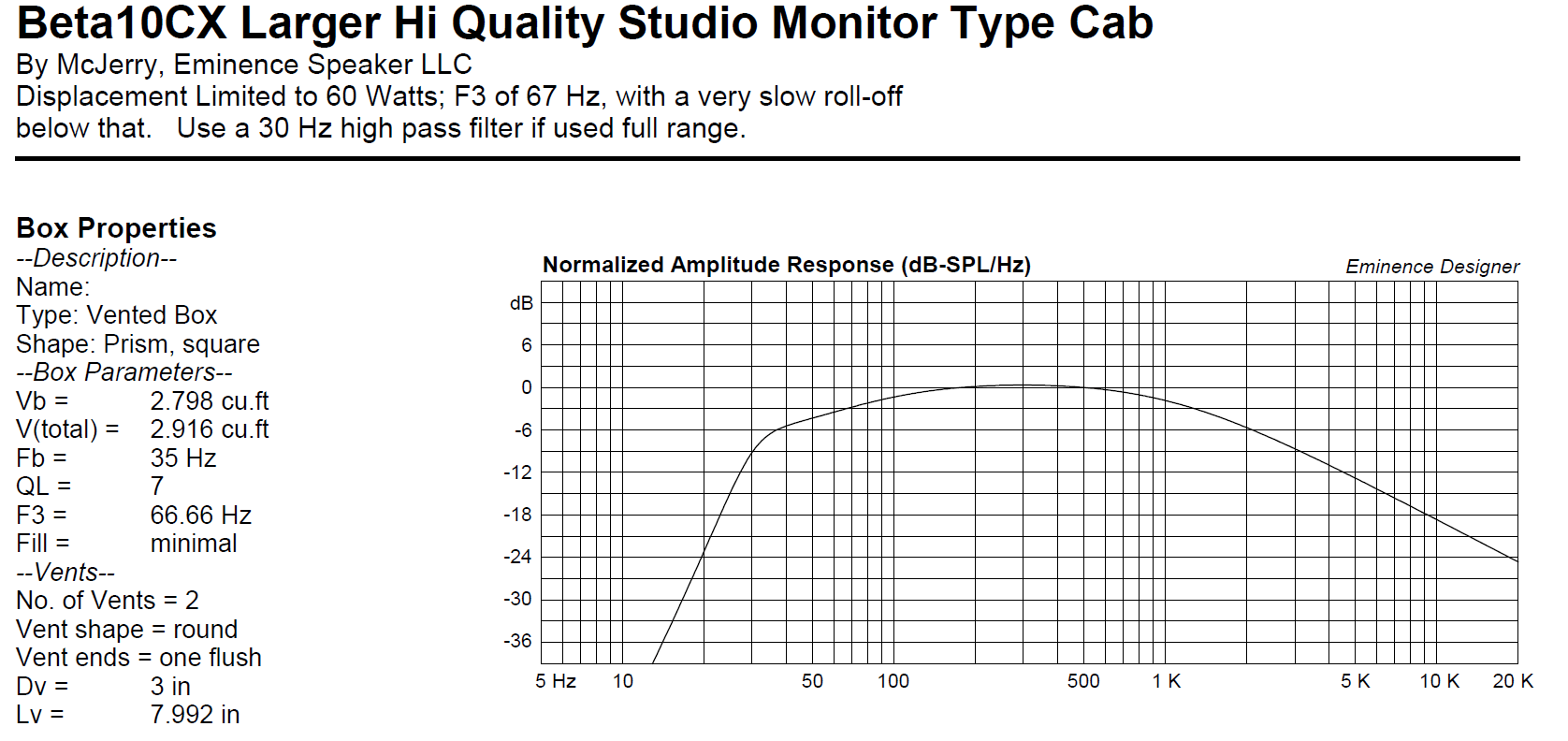

How do you plan to use the speaker? I'm working on something similar at the moment using the Beta 10 co-ax that also starts rolling off pretty high, but intend to use the speaker relatively close to the front wall (in audiophile terms), so that compensates for some of the roll-off. With the speaker cone about 24 inches from the front wall, the speaker has good in-room response down to 40 Hz (-4 dB at the listening position). You may want to do some in-room measurements/listening to see if yours is better than it looks in your current measurements.

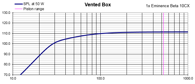

This is the modeled response. I didn't bother trying to measure the quasi-anechoic response, since I was mostly interested in how it interacts with the room and whether it would do what I wanted. Overall it does. Power handling is sacrificed for the low-end extension and gradual roll-off, but for my application that was a reasonable trade-off.
My test box is smaller than the one recommended by Eminence, but the tuning and general response trend is similar.
https://www.parts-express.com/pedocs/more-info/290-502--eminence-beta-10cx-cabinet-design.pdf

Looks like baffle step to me. With a very narrow front baffle, the baffle step is going to be in that range. You can model that in Visaton Boxsim or other programs that include baffle step. 1. Add a very wide baffle. Go with 24 - 36". 2. If you want a narrow baffle, and high efficiency, the best way to battle baffle step in my opinion is to add a second woofer and cross it in at the baffle step frequency. This give exactly the 6 dB boost you need at the low end. Software is so good, it is getting easier to accurately predict full system responses before buying and building anything. VituixCAD or Visaton Boxsim are both free and youTube has videos explaining how to use them.
It's a nearfield woofer measurement, so this can't be baffle related right? And my 1meter measurement is gated so not much good below 400hz.Looks like standard baffle step loss of 6dB to me. Increase the lowpass inductor until flat, and attenuate the tweeter until it matches.
I think this is very good advice. I was really hoping to squeeze the impossible out of this driver, but you're absolutely right, it's not meant to go low, originally designed as a stage monitor or small PA driver, and I think the recommended box volume is 30L/1 cubic foot. I can put a false bottom in the cabinet and move it around a bit and see how it goes. Thank you Mark.These are near field measurements right? So this is not baffle step you’re seeing. Bad alignment sure, as the impedance curve is not what you’d expect either.

Thanks Matt. I'd be using these paired with a 45 SET amp, super low wpc (2). Your numbers look pretty similar except your speaker has a Much bigger Vb. Interesting you're getting such a boost from the room, I measured in room at 1m and did get a bit of a boost but not enough to make me relax!How do you plan to use the speaker? I'm working on something similar at the moment using the Beta 10 co-ax that also starts rolling off pretty high, but intend to use the speaker relatively close to the front wall (in audiophile terms), so that compensates for some of the roll-off. With the speaker cone about 24 inches from the front wall, the speaker has good in-room response down to 40 Hz (-4 dB at the listening position). You may want to do some in-room measurements/listening to see if yours is better than it looks in your current measurements.

Right now the naked 4" port hole is tuned to 50hz. I'll start there and add the false bottom as I mentioned above, and work my way up to 70 or even higher tuning as suggested by Mark. I've got a REL T7x and it does a great job filling in, pretty seamless in my current setup, so this just might work out.You might do better with box size & port tuned to 54 hz instead of 40. Hardly any driver with fs over 25 will do 40, and tuning lower trades off what you can hear. If you ever connect to a more powerful amp there is a danger of xmax violation with too low tuning. Big series capacitor and parallel inductor required to filter off below fs.

I made some sims assuming 3 Ohm total series resistance (amp output plus cables connectors etc.) and result is -6dB step in bass response, very similar to your measurements. Its caused by alignment and driver properties, not baffle step (nearfield measurements).
If tuning frequency is raised to 48-50 Hz with current box than bass step is reduced to -3dB which should be acceptable.
To make flat response, you'll have to go with even higher tuning, but also smaller box.

I missed that it was nearfield response. Mark and others are correct.

What you've got here, in your original post, is essentially what's known as an extended bass shelf alignment. When coupled with some decent room gain the two can often cancel each other out, and you get something flattish, but there's a limit to how far you can take things.
I think the biggest issue here, at least from a subjective point of view, if you've got that far with these yet, is that there are going to be two bass loss phenomena at work. The first is the EBS alignment but the second is bafflestep losses. This has been mentioned before but shouldn't be ignored.
Your in-room measurements showed some boost but not enough for you to relax. It's possible that the boost was enough for the EBS alignment but when coupled with bafflestep losses this is what made things look poor .
The main problem here is that you've got a woofer with 96dB sensitivity when you were expecting that to yield a system sensitivity of 96dB. Unfortunately this isn't going to be as you will usually lose 3-4dB of that to bafflestep compensation (most find the full 6dB too much in room but this depends on room and speaker placement). Still a system with a real 92-93dB sensitivity is a lot more sensitive than the norm and will probably go surprisingly loud on a couple of watts.
In my opinion your first priority is to eliminate the EBS alignment because it will add to the subjective effect of bafflestep losses and make it harder to tune your crossover for the correct amount of bafflestep compensation to apply.
As you've got a subwoofer you don't even really need these to attempt bass anyway, although I'm not knocking the idea, it's just getting in the way at the moment.
You are already going this route anyway but reduce the cabinet volume and then raise the port tuning. At a guess you can probably get something that's flat down to about 100Hz whilst eliminating the bass shelf. Then you really need to do what wolf suggested in post 2, or something to that effect, until you've applied enough bafflestep compensation for things to measure roughly flat, or sound right, in room. Too little bafflestep compensation and things typically sound thin and fatiguing.
