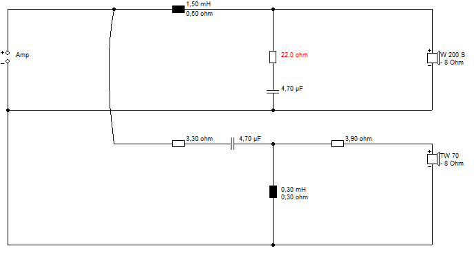

what am i looking at with the technics sb4000's ?
2.5k crossover
tiny 6db woof inductor (basically hf rolloff?)
12db on tweet (out of phase).
They going for acoustic 24db ?
or could it pass a square wave ?
What's going on with the crossover ?
Technics SB-4000
Let's see. 0.68mH on a 8-10" woofer. 4.7uF and 0.56mH on the cone tweeter. Time-aligned maybe, and negative polarity...

It it could be a true 6db time/phase setup.
my measurement shows 43mm. im gonna go with minimal baffle a slope toward woofer and the tweeter in a seperate box with crossovers in them
You could really help your cause if you tell us what drivers you are contemplating! Why the secrecy? I am particularly alarmed at your notion of using a 1.3-1.5kHz crossover. That needs an unusually big tweeter IMO. 🙂
@normanbates:
What foolishness is this 6dB stuff? A Morel CAT378 is nowhere near 6dB octave on a single capacitor. Think 12dB/octave:

My learned friend, vacuphile seemed to have some objection to my stating that 6dB/octave is "Fool's Gold" with any reasonable drivers in a two way like the Finch by Mike Chua:
Finch (Morel CAT378 + Vifa PL18W0-09-08) – AmpsLab
In fact, the order of a filter is decided by the ultimate rolloff. These bass slopes are all second order, 12dB/octave. The only difference is the "Q" of the filter. Orange for Butterworth (BW2 Q=0.707), Blue for Linkwitz-Riley (LR2 Q=0.5). That is what you will find in Mike Chua's splendid Finch design for the tweeter. FWIW, Q has some bearing on time delay.
12dB per octave is minimum for any reasonable tweeter. You also would best keep crossover well away from the Fs resonance of the tweeter (700Hz) and the first breakup of the woofer (5kHz). Mike Chua does that in the Finch. He also notches the Fs and the 5kHz breakup, which is even better.
Lynn Olson explains 12dB/octave as a minimum for tweeters here:
https://www.diyaudio.com/forums/multi-way/190663-sparkling-treble-sibilance-2.html#post2604196
Ideal slopes follow this sort of pattern:
To achieve that on flat baffle I used lower than LR4 filters, because the drivers have a slope of their own too. First order bass, third order tweeter on the crossover. FWIW, LR2 when time-aligned is a negative polarity solution, LR4 is positive polarity.
As Charlie Laub mentioned, it might be best to get the slopes approx LR2 or LR4, then mess with time alignment and tweeter polarity for best fit. Sorry for long post. Lot of topics here. He is also on the money in saying higher order filters give you more wriggle room on phase. 😱
