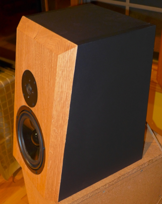

The tweeeter has a very low resonance
And the sb woofers bresk up is at about 2khz. I think it would work witha a 3rd order filter . Plus I simulated this setup with an active xo at 1,5kHz and everything was fine. Flat response. I am low on budget I cant affford to buy more buy more buy more🙂
"Work" and "sound" even acceptable are different things. 2Khz breakup means you`d have harmonic nodes at the lower corresponding harmonic frequencies and despite your flat crossover measured at some point in space, it will sound harsh. The Vifa tweeter misleads lots of newbies with its characteristics. Theoretically it can do 2Khz with a 4th order if you don`t push it a lot. And then come more problems due to directivity patterns. I`d abandon that idea - this tweeter is better suited for 3-ways or used in a waveguide.
Having mulled this over, Augusts, it pains me to say you have chosen terrible drivers here.
This 8" 4 ohm metal one is a complete horror for midbass duties:
Yeah, this woofer is best used as the bass driver in a 3-way system. Looking at the OEM response curves, I am guessing that 800 Hz is the upper limit for a crossover. It is not a good candidate for a 2-way.
It's a good 8" lower midbass driver - quite nice as high as 600 Hz.
Midrange driver? Not so much - and in fact most 8" drivers aren't particularly good because of their off-axis behavior when used in a typical 2-way configuration.
2-way standard driver to choose is the Peerless NE180W-08: it's sort of unbeatable at its price for a 6" driver.
If you don't want to cut-into a face-plate to get the tweeter as *close as possible to the midbass - then this is about as good as you can get without spending a ton of money (..and in fact sounds better than most of SB's ring-dome tweeters, and many dome-type tweeters in general): SB26STCN-C000-4

IF you want a tweeter with a bit more low-freq. extension for a range of crossover (types), then I'd look to the Peerless DA32TX00-08, but you'll really want to cut-into that face-plate to get the tweeter *closer to the midbass driver.
*this is largely about minimizing vertical "suck-out" (or dips off-axis vertically), which can be significant.

Ne180w looks good.
Profiguy said no way 6db with its peak, 12db 2.2k and 4.8k notch.
