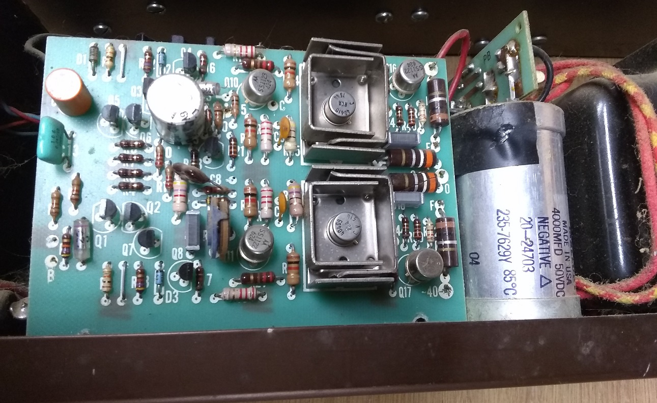

More madness. A friend is downsizing and he included these Tiger .01 s in a trade.
The board is much more complex due to the dual differential front end, output
protection, and Darlington output stage.
One looks, nearly complete but the keen eye might catch that C8 is lifted at one end.
The other is missing the board and heat sinks.
I'll probably use the empty chassis to test more complicated mods.

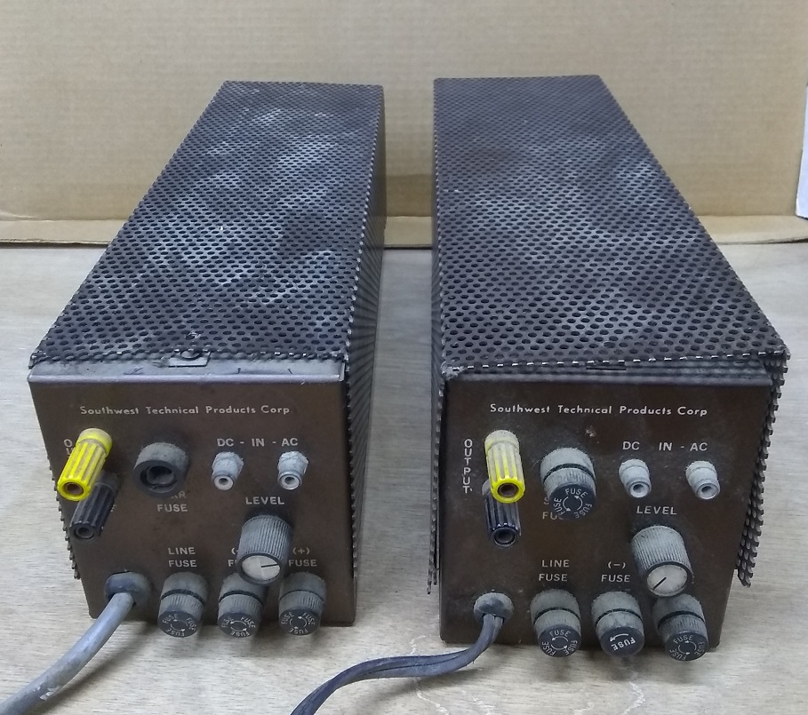

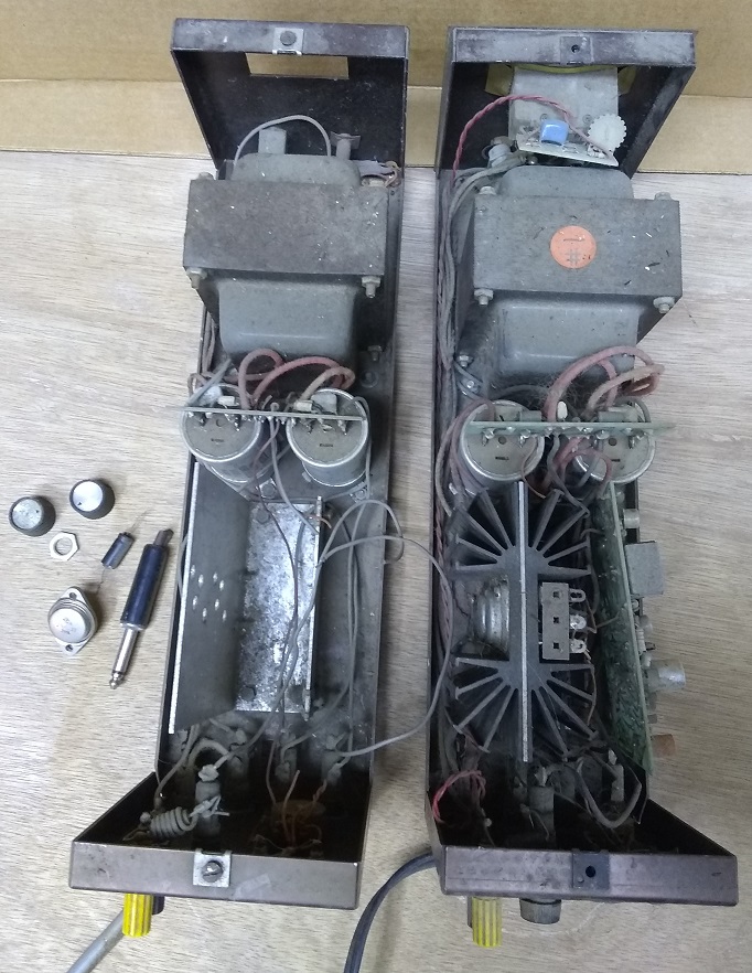

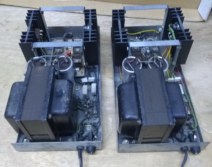

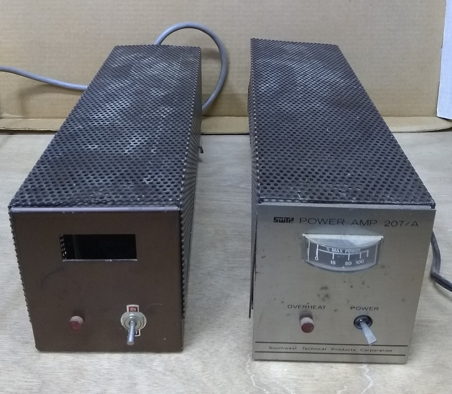

The mono UT shown above was a single MK II.

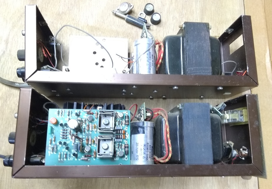

Here are a pair of mono UT s originals from ebay, claim was that they worked perfectly but I never
powered them up do to likely needing a recap. They are the original version but they do
have all 6 of the 100R upsized to 1W. SWTPC probably made this improvement when so
many had the resistors burning up. Output transistors have 036 and 044 markings on both
units, perhaps 36 and 44 th weeks of 1980 - anyone know?
They look completely original with no burn marks or signs of ever being repaired.

If those are anything like the original tiger, I simulate the lower 100R dissipation at potentially about 7.5W (15W *50%) for a +/-42V supply. Of course this is hard clipping but could happen easy. Note that 21V on 100R is 4.4W but that doesn't include the driver current. In any case, even 1W seems very optimistic.
In this position, wire wound resistors may be too inductive so finding a non inductive 10W resistor may be difficult.
The "upper" 100R resistors do not need to be as big and 1W may be enough.
They are the original (first version) Universal Tiger (UT) and yes they have +/- 42V
supply at idle. I simmed .9 W on R12,14 and the feedback resistors at full sine
power. Just did a hand calculation and got 1.9W full power sine so perhaps I'm
mis-remembering the simulation. Resistors have to be de-rated so I'd just use
5W resistors. And of course a full power square wave would heat them even more
than the 1.9W calculation. This is one reason that I plan to go to Darlington outputs
since then those resistor values go up by roughly 10X and power levels divided by 10.

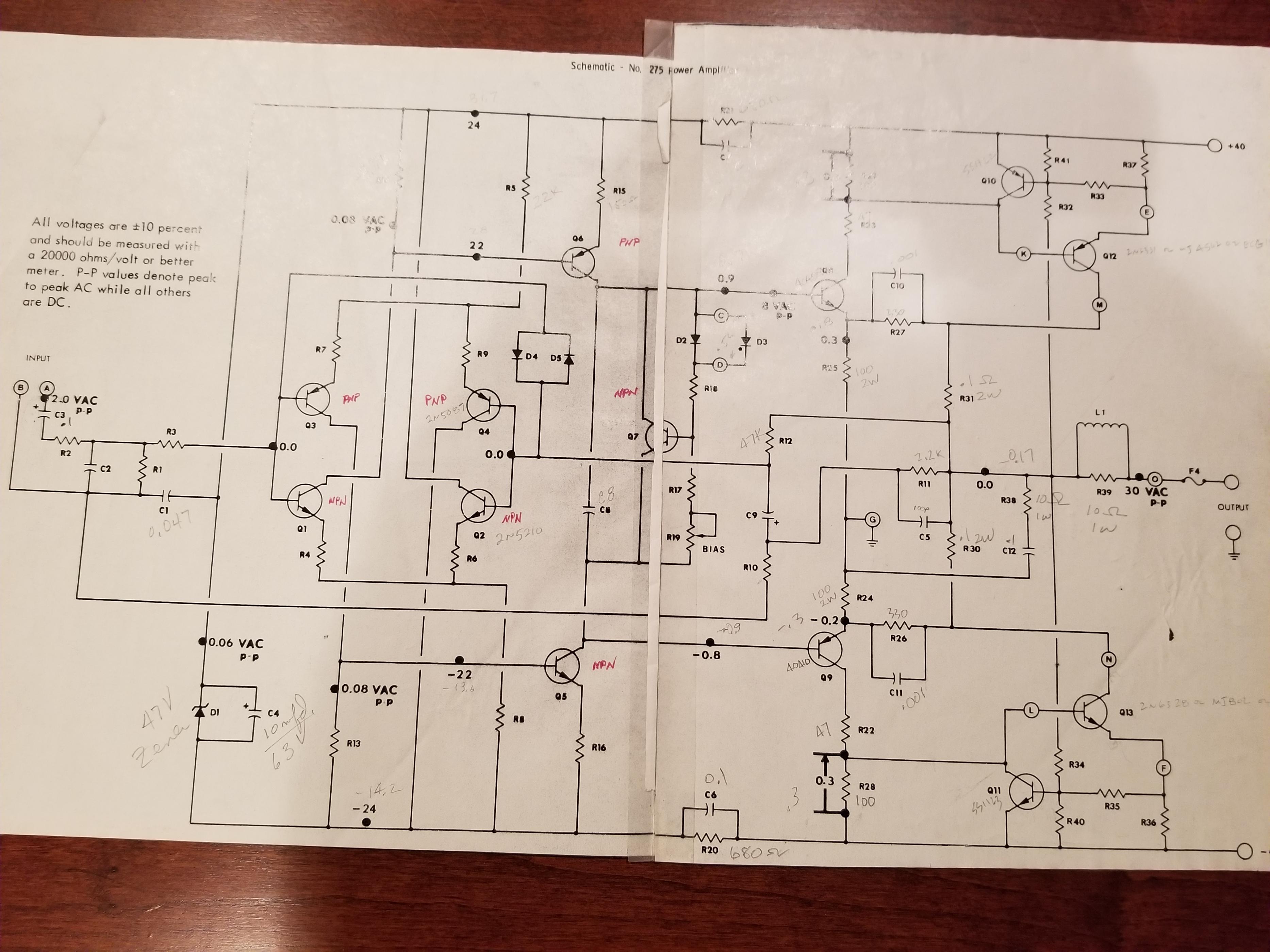

One goal is to be able to use this amp on the bench with any waveform from a function
generator with any reasonable load on the output even open circuit. So, thinking it over
A full output square wave into no load should be allowed for and your calculations are
correct. The resistors should be 4W min, 5W to have some margin so that will be the new
recommendation. I knew that 1W was not enough but that is what SWTPC was using.
Thanks for pointing it out.

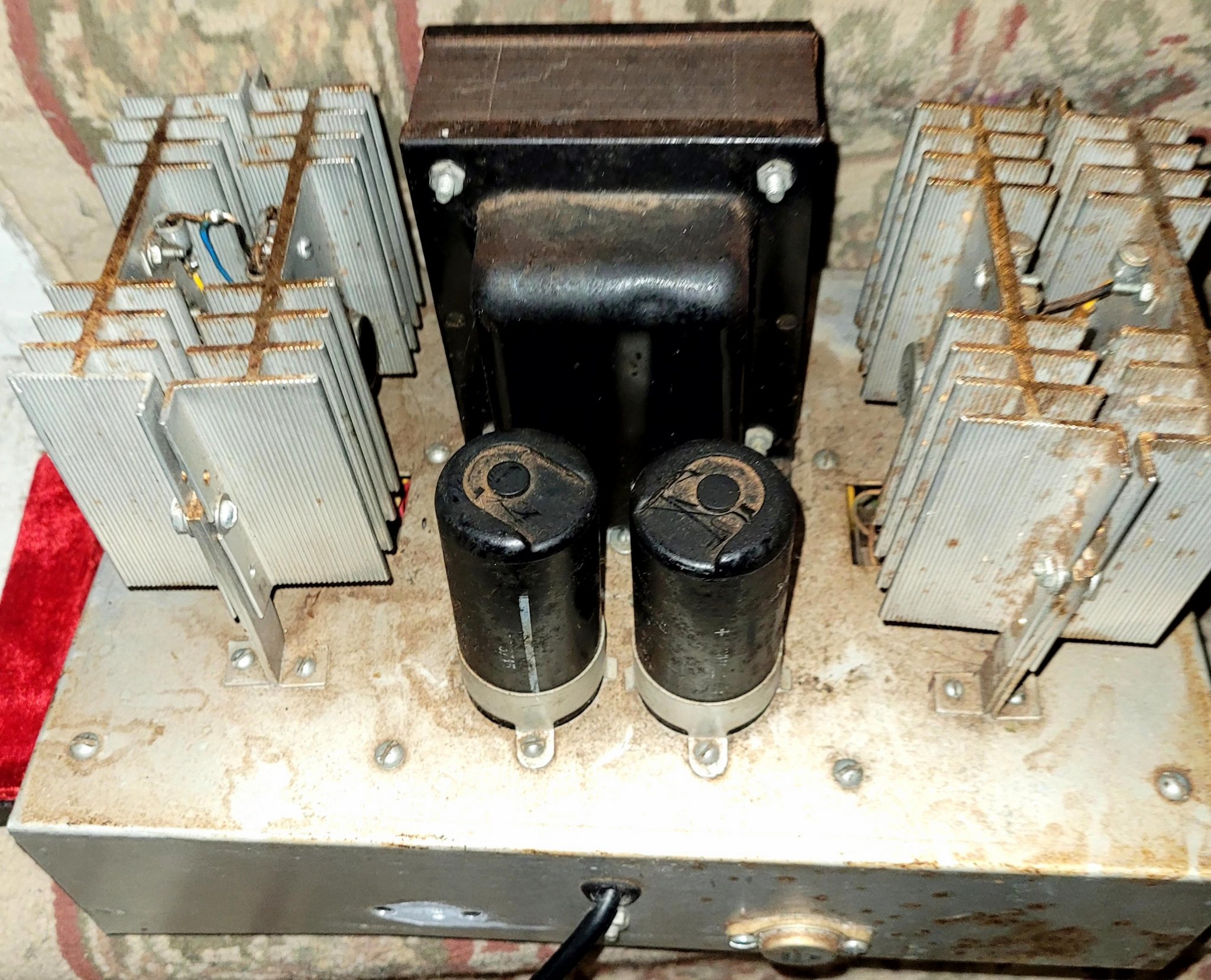

The pair that I posted in #43 have slight rust starting on the chassis which is bare steel,
any suggestions for cleaning them up without painting them?

Oxalic acid dissolves rust slightly. Found in Barkeeper's friend powder cleaner. Use slight water spray, fine steel wool to avoid scratches.
Prussic acid can convert trivalent FeO red flaky to bivalent FeO, black, sticky. Will turn the surface black or blue. I use an industrial chemical made fished out of factory dumpster, but the vendor is out of business. OsPho was a trade name 45 years ago. Gallon jug included the chemical, also detergent. Paint on, allow to sun dry. Rinse powder off with water, dry. Marine paint suppliers should have some.
I have heard gunsmiths have a source of the chemical for gun blueing.
Bumper restorers should be able to chrome cadmium or nickle plate it for you. Detail shops sometimes have a gold plate brush rig for door handles & hood ornaments.

Nowadays almost all amplifiers have a longtailed pair input stage of 2 PNP transitors instead of NPN, I believe this is a better way of design.
I rebuild the input stage and I think it sounds better than the original one with the PNP transistors.
What do you think ?
PS
You have to change more in the circuit to make it work.

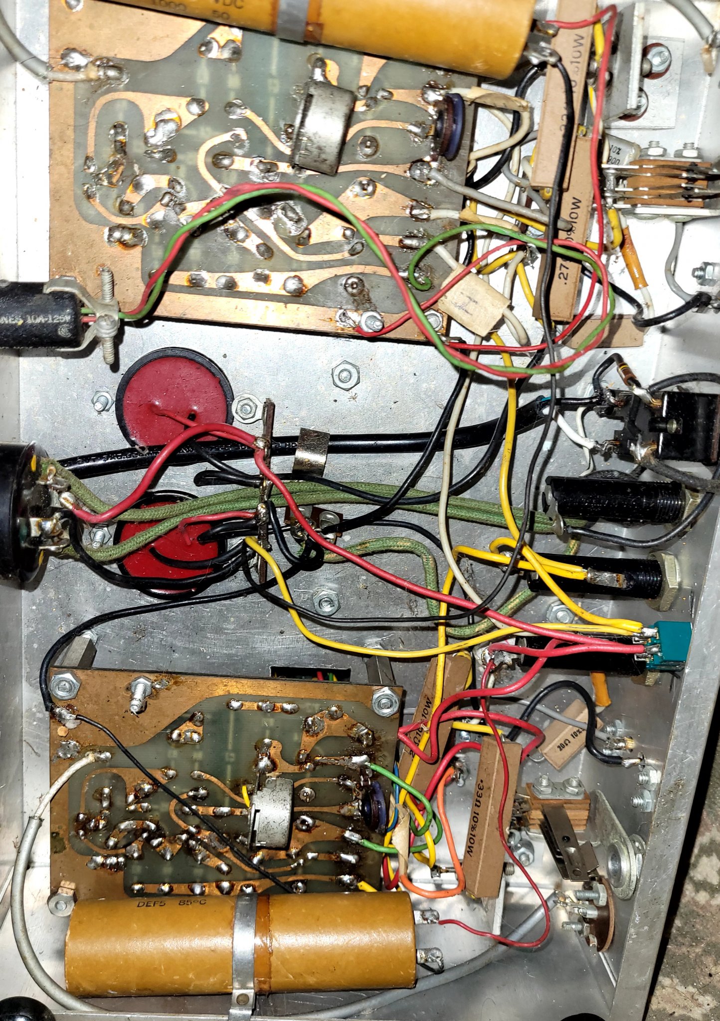

Good day all, I have an amp here that I have been told is a "Tiger" amplifier but I cannot find a visual match for it.
Could anyone please let me know what I have, is it worth recapping and what parts would you use?
Also absolutely any info, brochures, schematics would all be extremely helpful and appreciated!

It might be its cousin, the Brute 70
Of course, worth recapping and updating; you have the most expensive parts:chassis - PT - Heatsinks ... anything else can be upgfraded/replaced fo burger money.
https://deramp.com/swtpc.com/PopularElectronics/Feb1967/PE_Feb1967.htm
Found this, the Showman chassis later in the thread cleaned up nicely after a soak in
Krud Kutter - never heard of it:
Restoring a corroded & rusty Fender chassis | Telecaster Guitar Forum
Stumbled across Evaporust product which is not acid but rather a chelating agent that reacts only with the rust.
This shows how to make a home brew version:
This shows how to black oxide coat steel at room temp:
