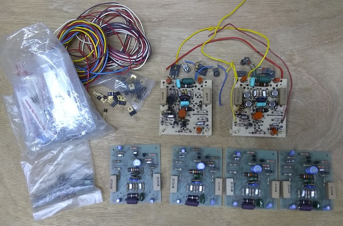

The UT (stereo) I worked on is my parent's amp and over the years I've picked up a few on ebay,
and various members and friends have given more to me. Tubelab (George) here sent me
two nearly completed UT boards and a pair of outputs transistors from 1976.
Michael Chua (Ampslab) sent me 5 pairs of much newer output transistors from the 1990s.

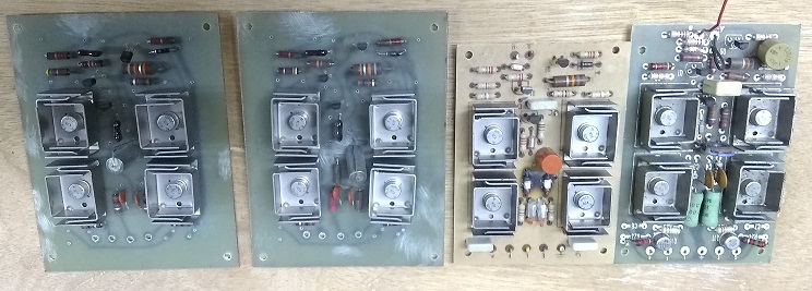

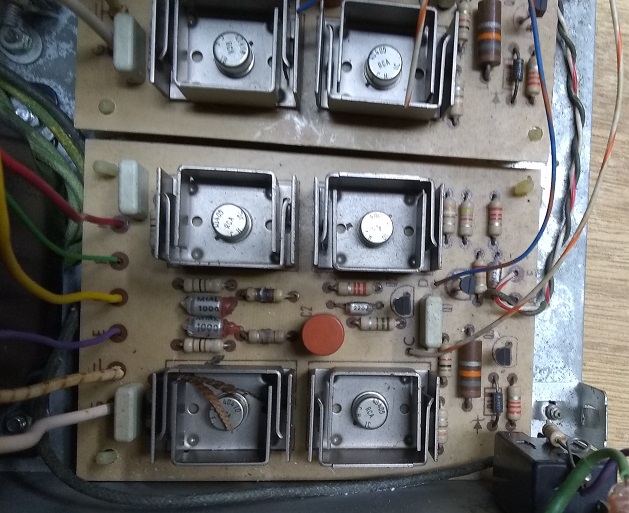

I bought this stereo UTS on ebay and it looks exactly like ours did when it failed, completely
burnt R12 and R14 with the board being charred even on the back side.
It is interesting that at audio frequencies and full power simulation shows about .9W in
R12, R14 and about the same in R15 and R16. The oscillation must be at high frequency
since plastic caps C3 and C4 melt and act to protect R15 and R16 forcing more power to
R12 and R14. The next and last revision of the UT increased R12 and R14 to 2W but left
the rest at 1/2 W when they also should have gone to at least 1W.
Here's a picture of the UTS from ebay with burnt resistors and melted caps on the top board:
https://www.diyaudio.com/forums/att...0684d1572213354-tiger-amp-madness-uts-top-jpg
The next is a close up of the top driver board:
https://www.diyaudio.com/forums/att...572213747-tiger-amp-madness-uts-top-board-jpg
An odd thing is that often one channel has severe damage like the top board but then
often there are damaged parts in the other channel. I don't know the details of how this
amp from ebay failed but the lower board has R13 slightly burnt. I should test all the
parts on that board. R12 and R14 are mildly burnt and the caps partially melted:
https://www.diyaudio.com/forums/att...572215741-tiger-amp-madness-sut-bot-board-jpg

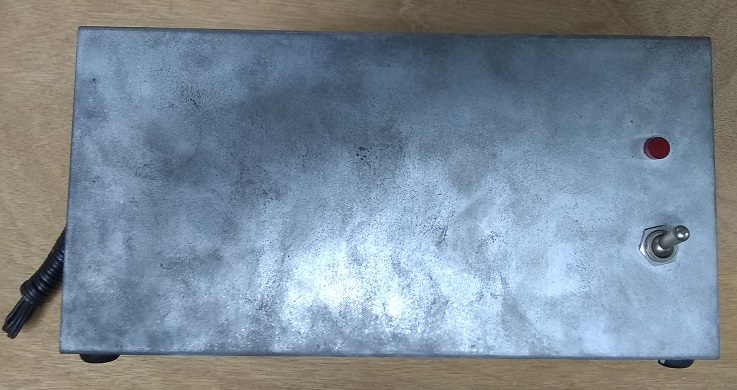

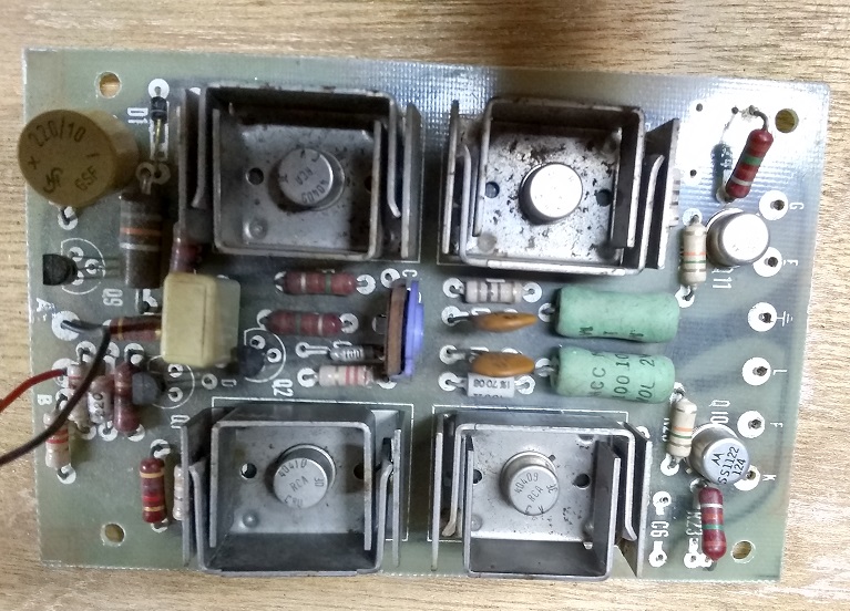

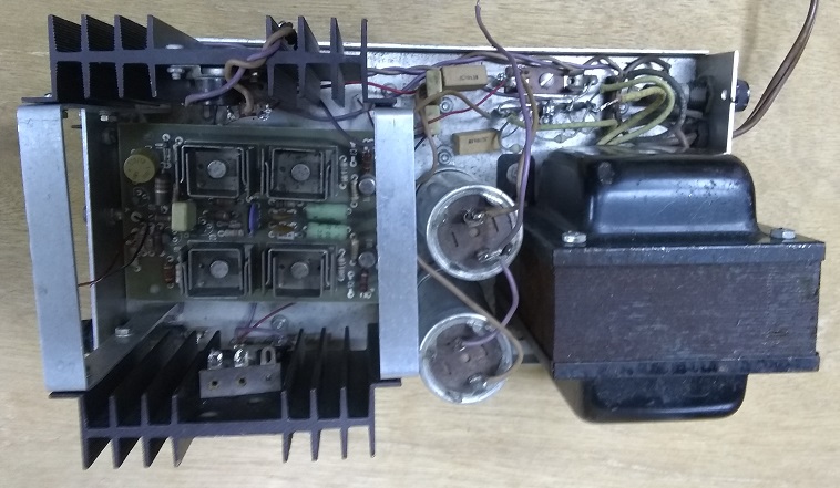

I finally pulled out this mono UT MKII and have started rebuilding it as an original to take
some measurements and try to observe the oscillation on the bench:
Started disassembling it, then remembered to take a picture:
https://www.diyaudio.com/forums/attachment.php?attachmentid=790703&stc=1&d=1572217979
Here is the MKII board with 2W resistors and transistors for output protection:
I started changing it back to the original design then remembered that I had good
new boards from Tubelab:
https://www.diyaudio.com/forums/attachment.php?attachmentid=790704&stc=1&d=1572218243
I decided to just finish one of the Tubelab boards that had never been powered up:
https://www.diyaudio.com/forums/attachment.php?attachmentid=790708&stc=1&d=1572218484
The soldering is not very good in all of the Tigers that I have so I'll be cleaning it up as I
rebuild it.
