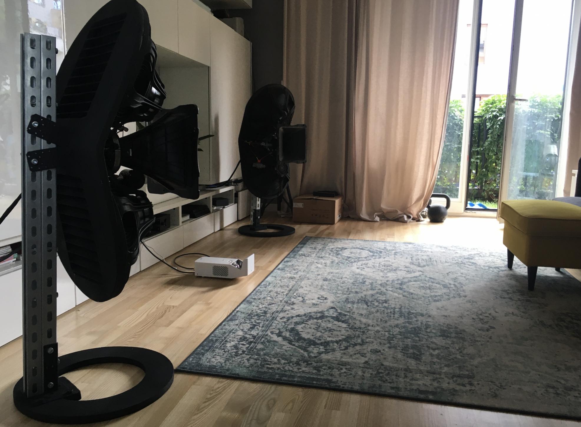

In my moderate-sized room with 0.7 m to the wall behind the speakers, I don't hear any problems. Maybe I (and all my guests) have a tolerance for these issue. 🙂 I didn't expect a reduction in floor reflections below 800, I agree that this works at large angles for a dipole, even of this design.

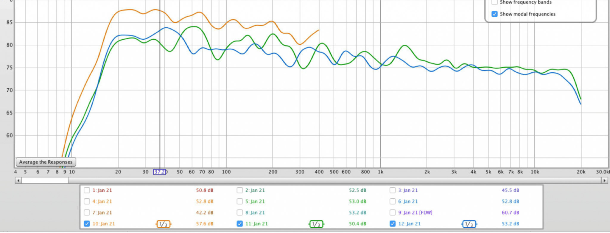

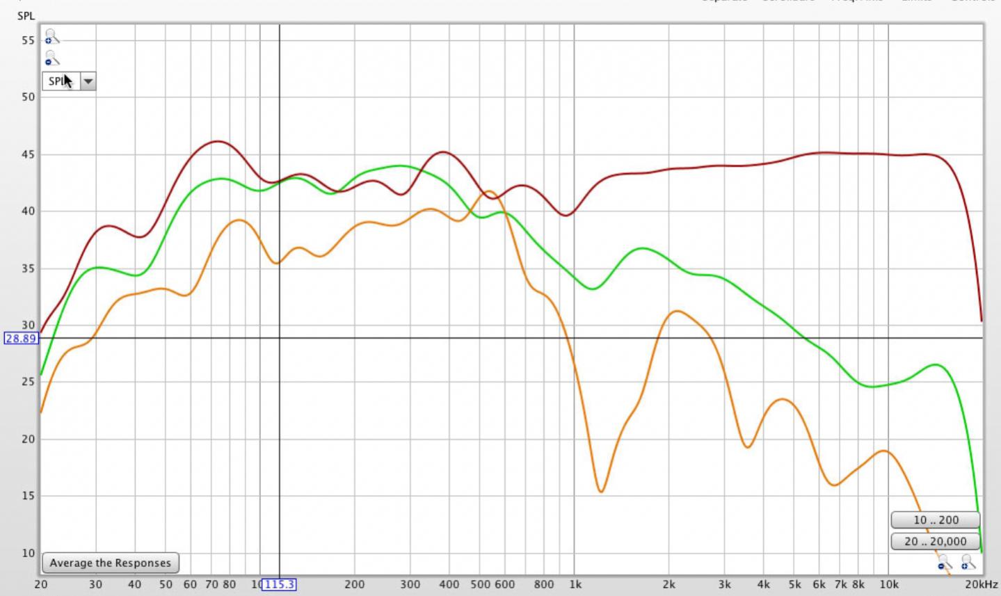

I tried a quick test: a microphone on the floor (green), a microphone at the level of the horn in the same plane (red), a microphone near the ceiling (2.7 m). I didn't expect a reduction in floor reflections below 800, I agree that this works at large angles for a dipole, even of this design.

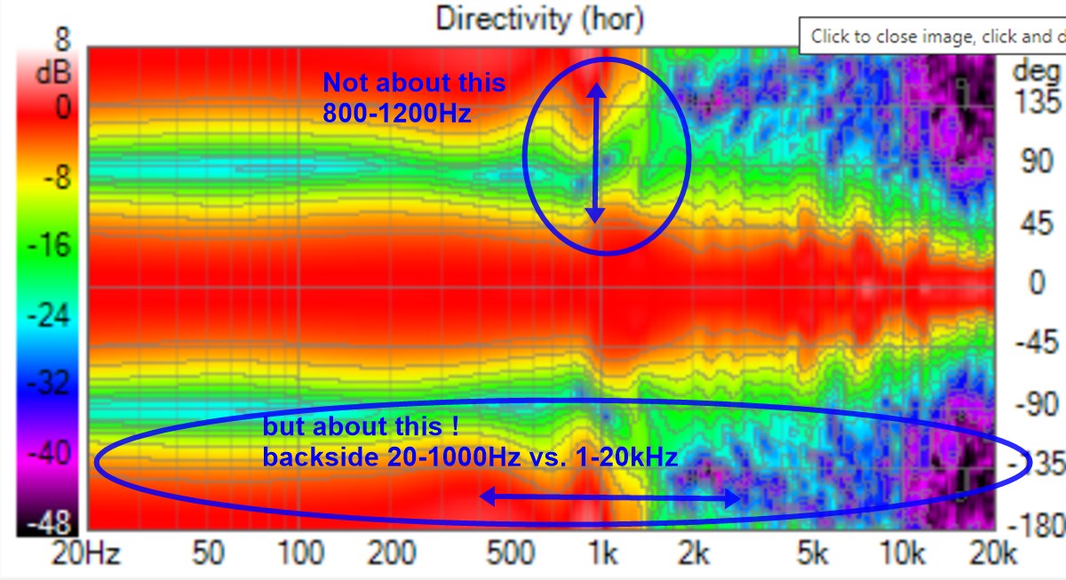

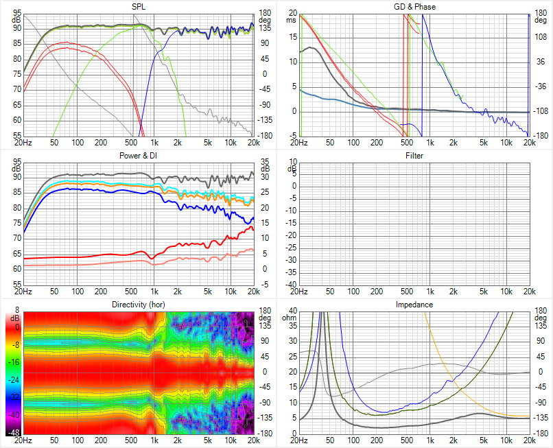

Nice to hear that you can't hear problems! Anyway here is a 0-180 deg horizontal directivity showing the dipole/horn imbalance, original post by kimmosto
From what I can tell, the plots show that the directivity index is relatively smooth, meaning that the radiated power does not represent a major flaw with this kind of hybrid system. This is despite the change from dipole to directive monopole at the crossover point. Although there is a glitch in the DI there I suspect that this is caused by using too small of a horn (judging by the loss of directivity around 1k in the horn).

In kimmosto's attachment, blue curve is power response (full space) and it does have a glitch above 1kHz.
For me, the main question I have (and why I want to build something like this) is whether the loss of the front wall reflection above the crossover point to the horn will reduce the soundstanging that a good fully-dipole system can deliver.

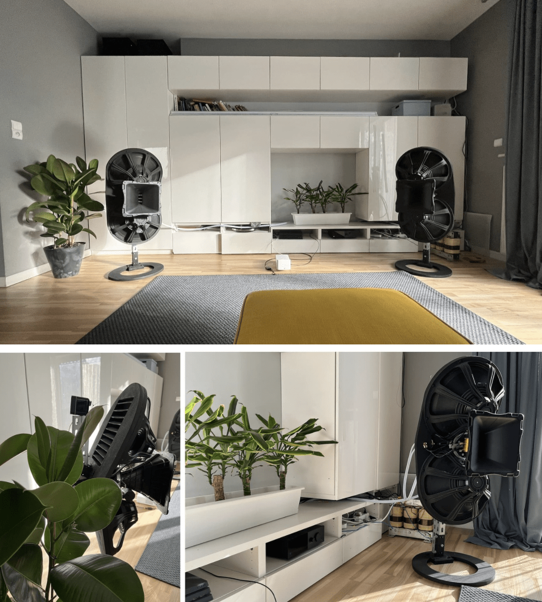

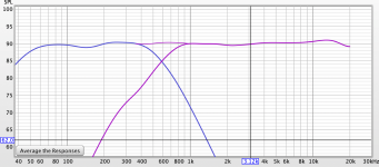

Some updates.

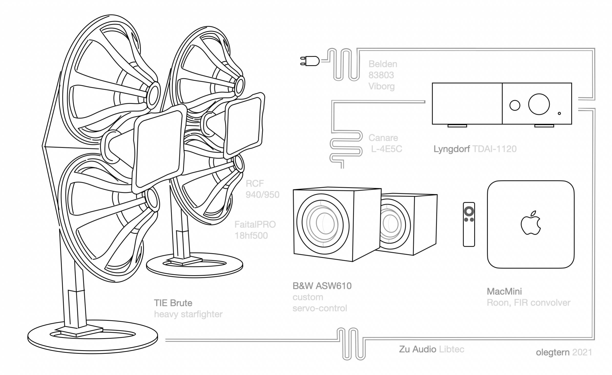

New amplifier-Lyngdorf TDAI-1120. It sound great, and there are a lot of useful things on board: equalizers, separately for acoustics and subwoofers, delays for subwoofers (bass is great!), room-correction (a little strange thing, but in general it works), Roon-ready, Airplay, Spotify, coffee roaster... Well, maybe without roasting, but I have to read the manual! To be honest, I'm thrilled.

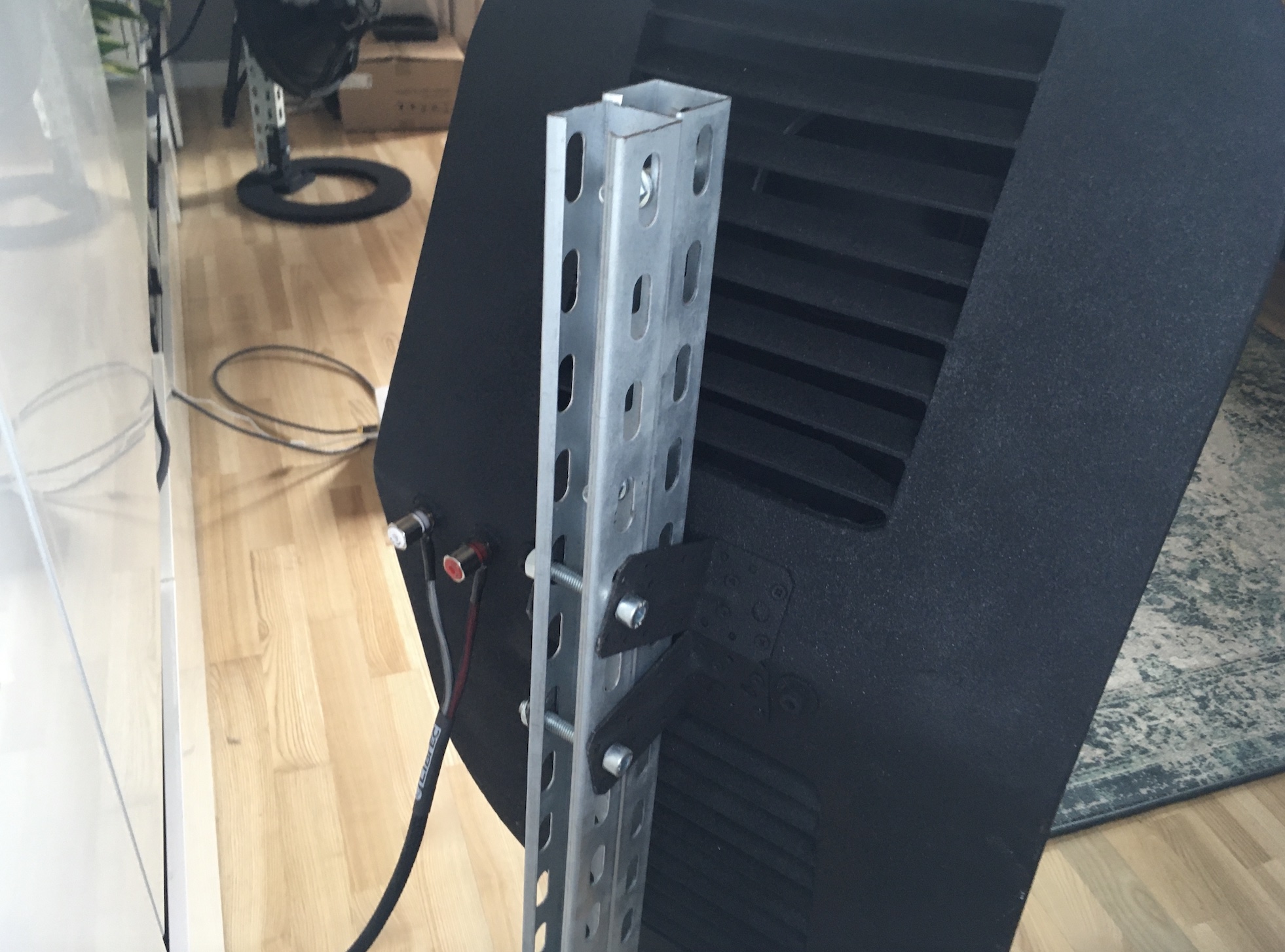

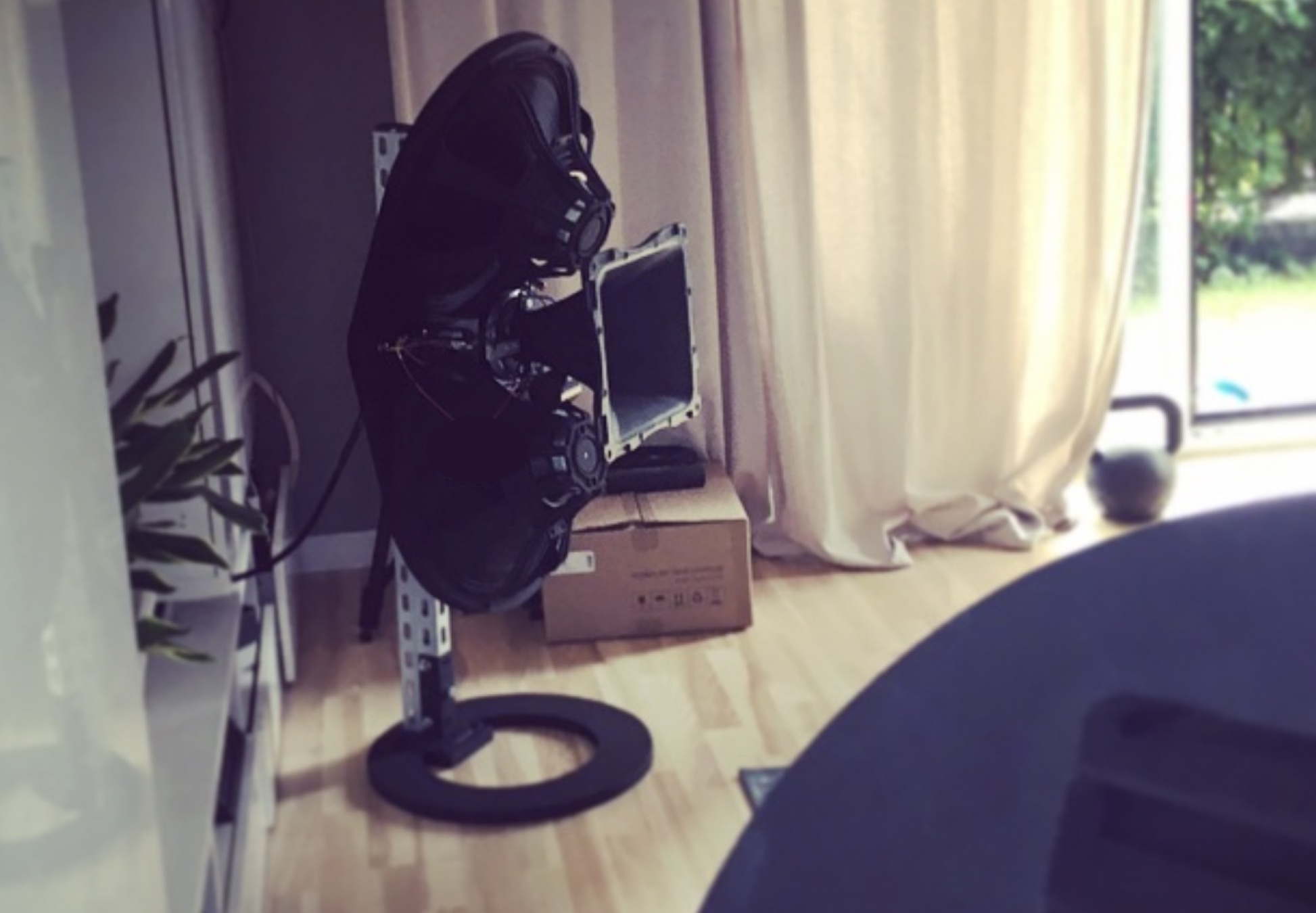

Small changes in speakers design. I wanted to close the woofers, I didn't like that they were gathering dust. And I decided to try to add a little more baffle size. I like the result, the sound... I don't think it changed much. And that's great!

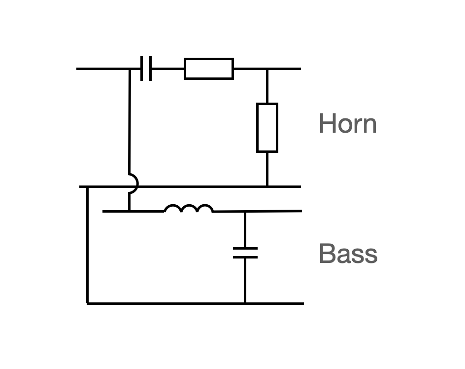

Changes in the crossover. Now the 2nd order for woofers, after all, it sounds more focused and clean, than the minimalistic crossover before. Although it was also excellent. Just need to adjust something from time to time! 😀
And I added BMR speakers (I had a pair of Cambridge Audio Minx12), with a filter below 1 kHz, as the backside ambient channels (not on photo, latest update).

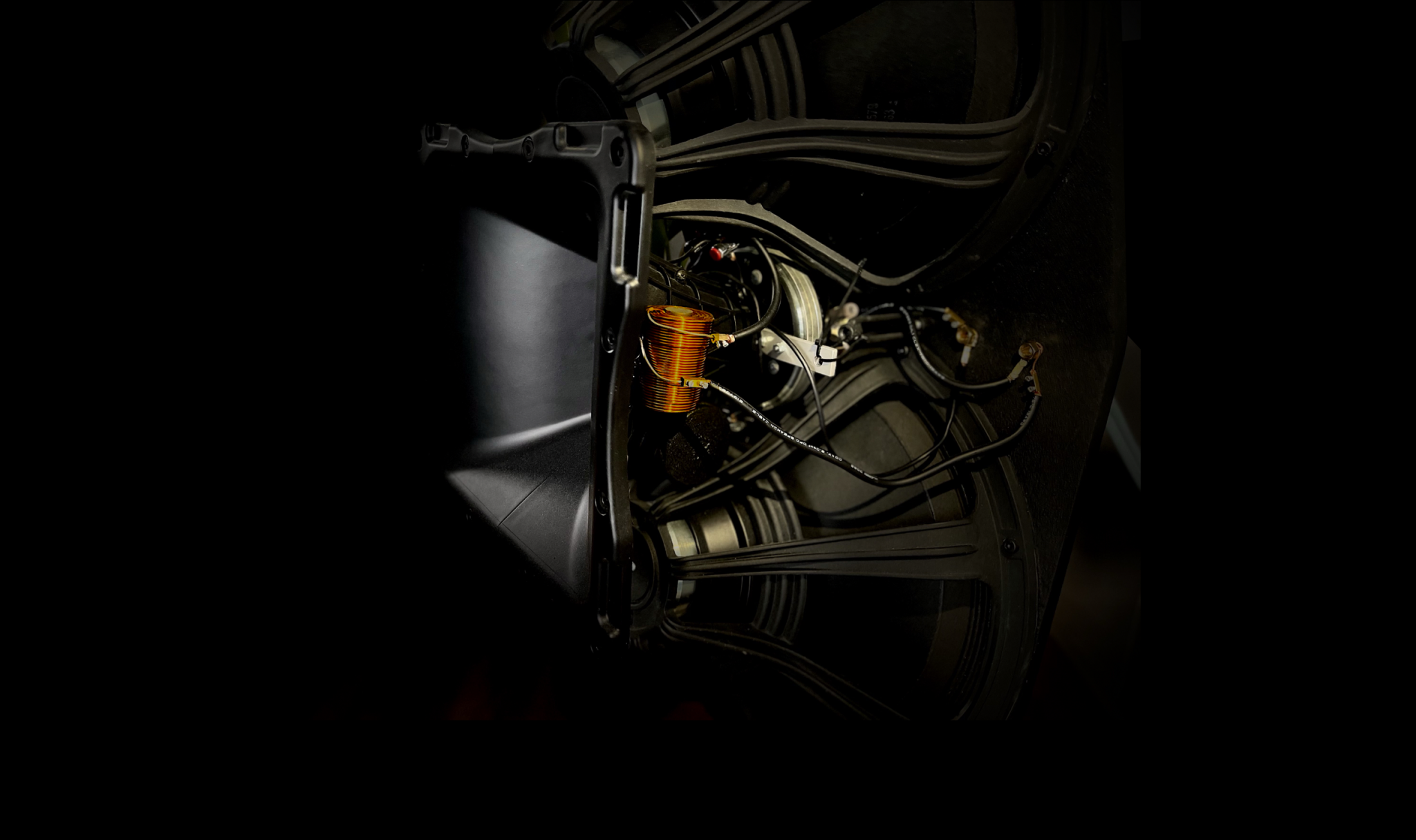

I decided to test the idea that it is better to support the dipole + horn with a backside tweeter/small horn to equalize the power response. I didn't have a tweeter/horn, so I use a fullrange. I really like the result, the main influence on the perception of space and less room sound, and more natural tonal balance. @Juhazi you were right, it works (but I didn't even argue, it just took a while to try it))!

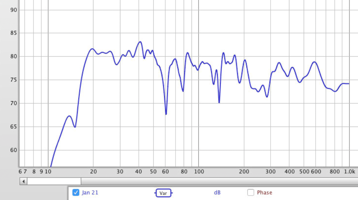

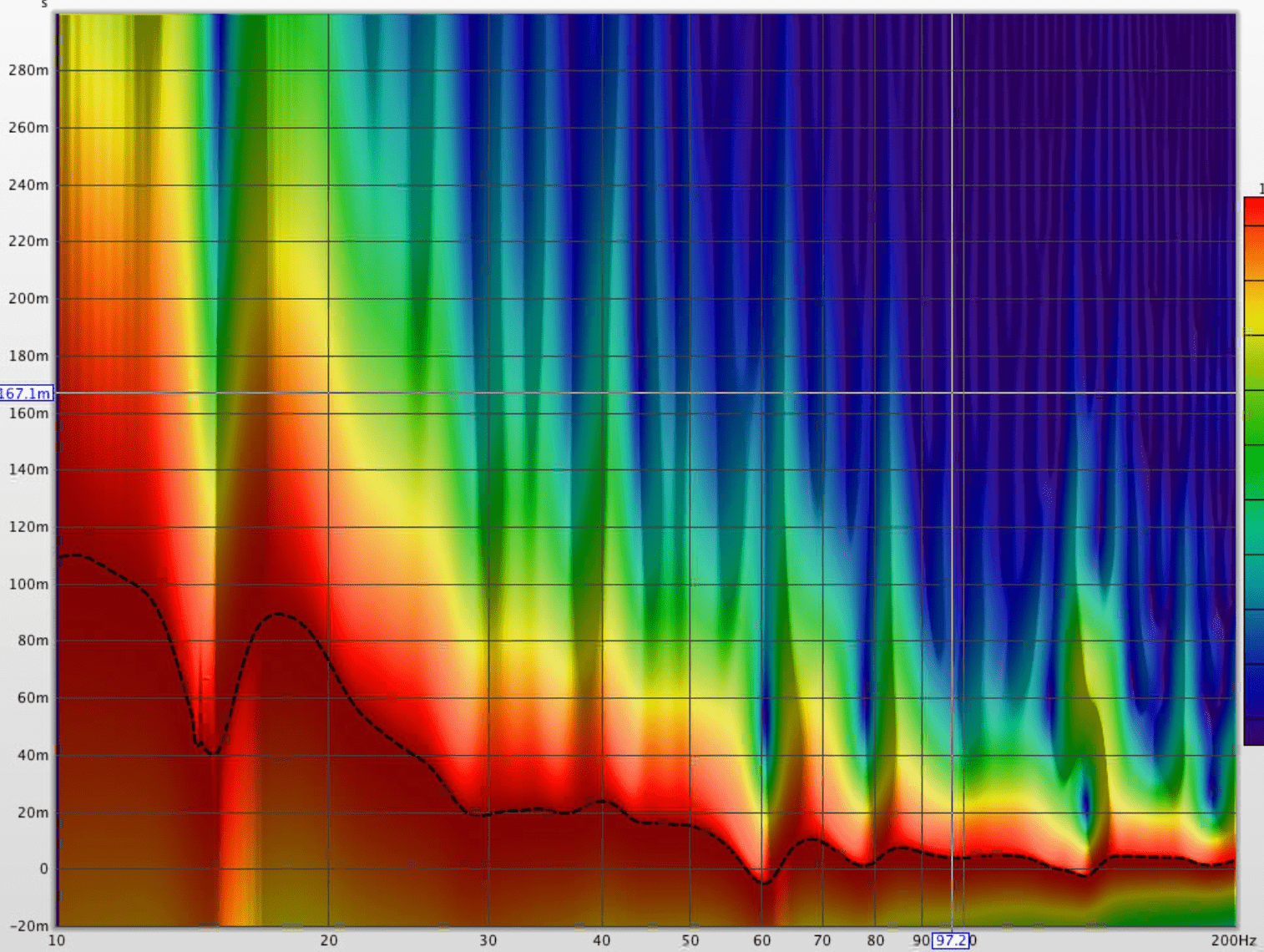

Measurements. The first graph from the listening point, L/R / both. L+R bass Var + spectrogram. Crossover.
