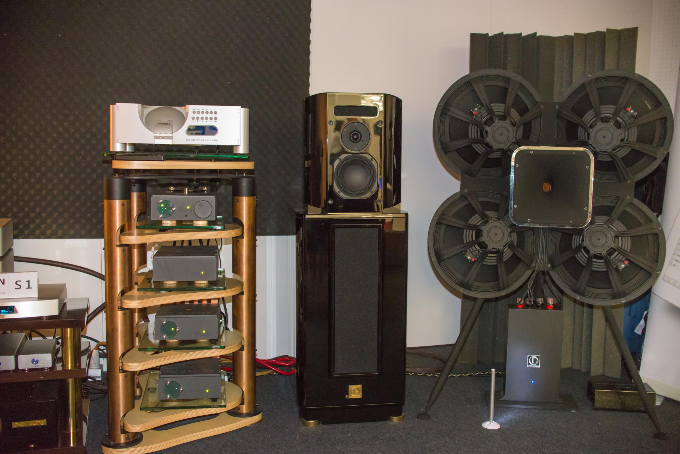

Thanks for your report! Unfortunately, I didn't have the chance to listen Reflector audio, was inspired by photos. Happy that I went this way.
Hope, one day I'll have a big enough room for 4x18 per side 😀
Subscribed - what a brilliant idea. Perfect point source?

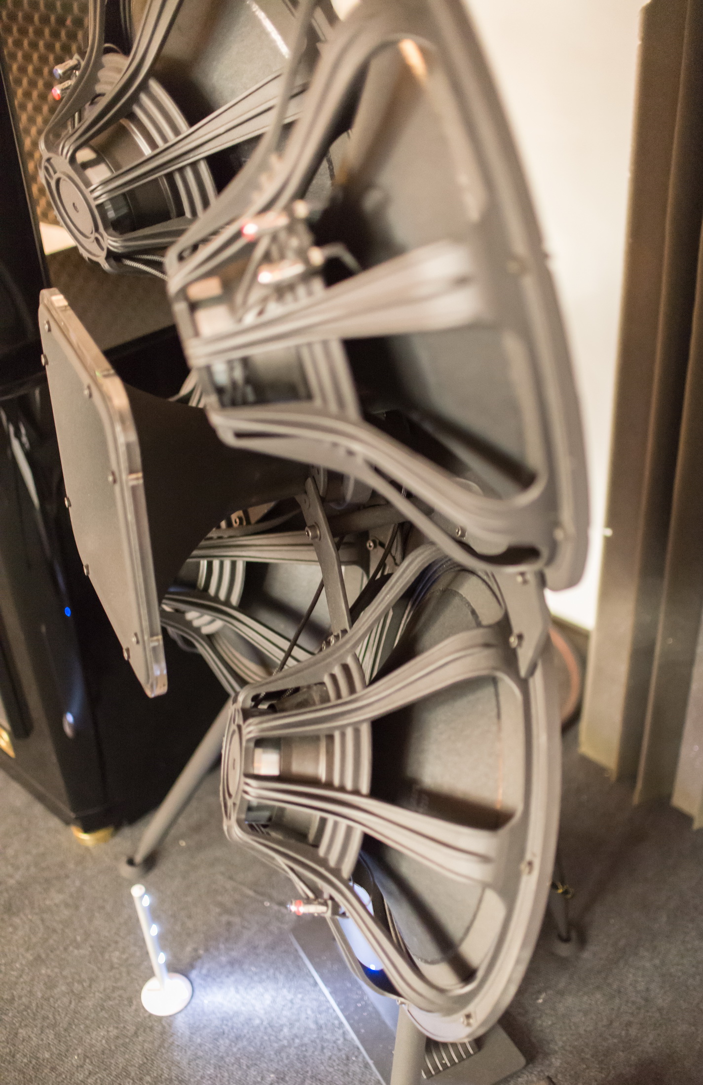

The Reflector Audio Lite is also very interesting, no photos of the innards of those though.

If i listened a lot to rock this could easily have been my perfect imagined sound. The unrestrained dynamics were just incredible.
Classical was not so much fun, but taking into account the class D amplification and dsp it would be unreasonable to expect more.
I would pay close attention to the off axis response of the woofers just below where they are crossed over to the CD+horn. With four woofers, the radiating area may be too wide to prevent beaming in the horizontal plane above about 500Hz (via my guesstimation). The two woofer version would not have this problem, or at least it would occur much higher in frequency. More woofers may not be "better" in this case.
I would expect this to be a really great system for its simplicity, as long as the crossover point to the horn is kept as low as possible, e.g. 700Hz. Integrating the woofers and the horn in this way into a 2-way hybrid dipole+directive-monopole system is clever. Nice work!

In fact, you described the path I went through! First step — general sound concept, dynamics, room behavior etc. Then I switched to passive, so I could use a good DAC or experiment with amps. As a result, I am completely satisfied with the sound at any music.

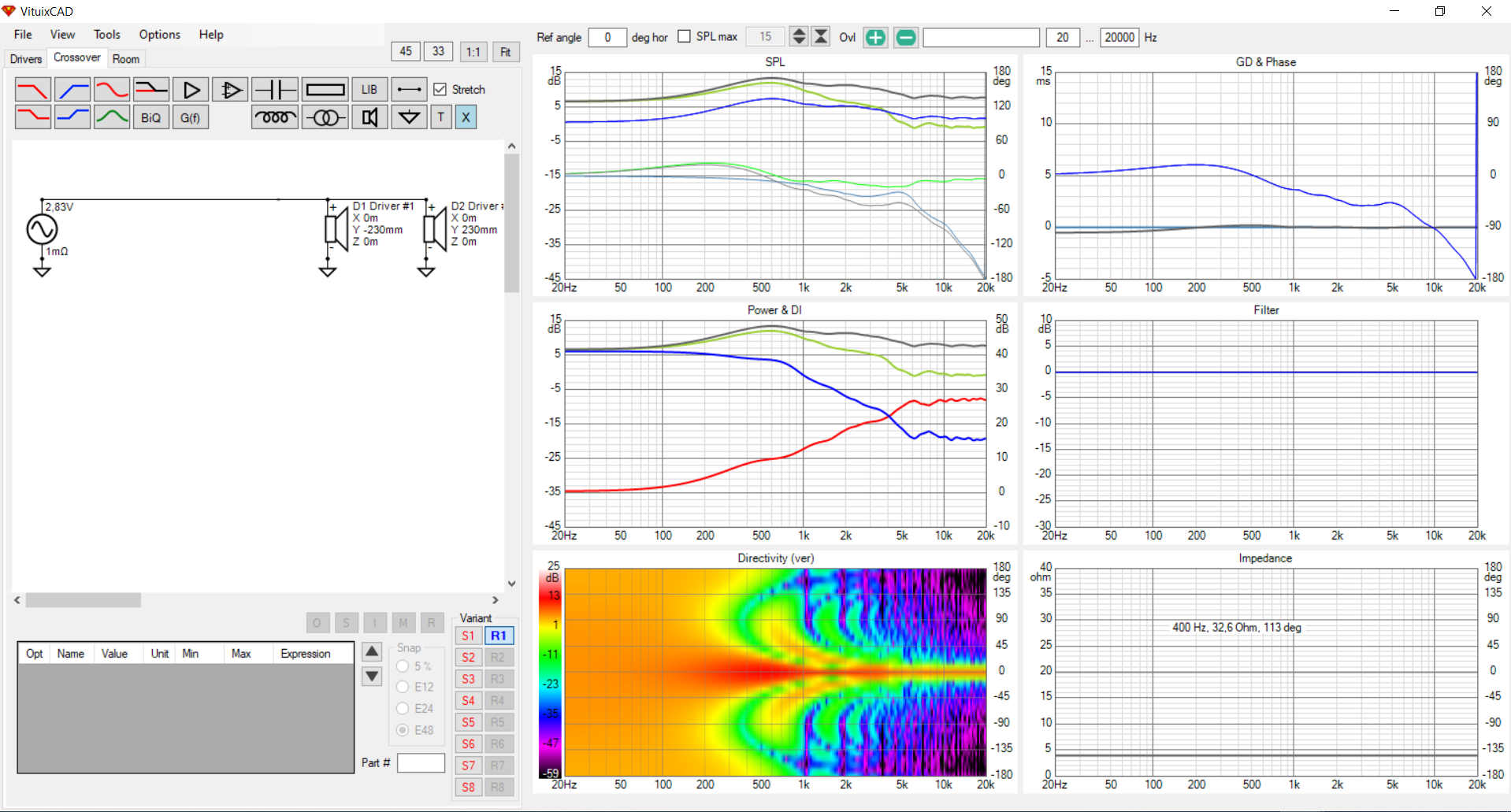

Two 18" drivers have pretty narrow vertical directivity, -6db off-axis response point is about half the frequency of the horizontal, ~350Hz. Quick try on VituixCAD sim and directivity index seems to shoot up to 10db at ~500Hz.
Ideally the horn would need to control directivity below this for smoother directivity index. I don't know if the bumpy power response and directivity there at mids is a problem but it is the same kind of effect that all MTM configurations have, just lower in frequency. Simplicity and relatively small size is the plus for this design and it probably sounds impressive but it is not anything revolutionary. Definitely not a point source unless the crossover was about 750Hz / 4 ~= 200Hz. Can't escape physics 😉
ps. I don't know how to sim ideal dipole speaker in vituixcad so this is just a demonstration that the vertical directivity is lot more tighter than horizontal with two woofers.

This seems pretty pre-determined even after simulating it in my head 🙂 The vertical directivity of both the horn and the 2x18 is moderately narrow (there is no problem when you gets up and sound disappears or becomes strange, it's just quieter), and wide enough to cover the entire sofa. I love it!
What you say is true, but the system can be elevated so that the horn is around ear height (e.g. 40 inches or 1m above the ground). This causes any/all seated listening locations to be very close to "on axis" in the vertical plane.
