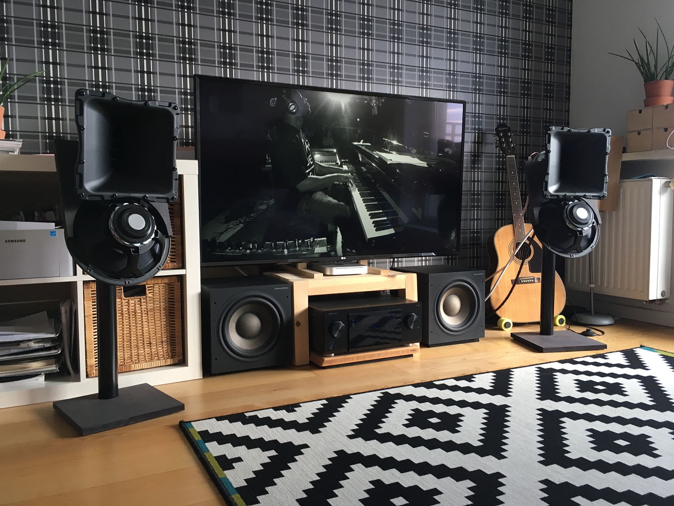

I want to present my system. It's still in progress, but it's already bringing me a lot of fun and music.
Speakes inspired by Reflector audio. I call them TIE Brute, they look like heavy starfighter from Starwars 🙂 All information about the drivers is shown in the picture. As you might guess, an open-baffle + driver in CD horn.

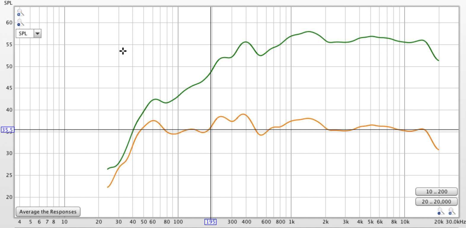

After a long period of experiments, I came up with an extremely simple crossover. In short: the Faitals are filtered acoustically by turning out, the compression driver with a 4.7 capacitor gives a shelf response, and then I use digital or analog equalization to the desired frequency response.
This may look not-so-smart and too funky-punky, but it works surprisingly well!
(I didn't save any good measurements, only such shitty ones with all sorts of reflections, in reality, there is no failure at 500 Hz, mic position. But hope, the idea will be clear, and if it is necessary, I can make normal measurements. Funky-punky as I say))).
At low end 2x 10-inch subwoofers with the added servo (piezo sensor on the driver and feedback board in front of the amplifier). They can not be heard until you turn them off 🙂
And a small video presentation on the phone, of course, the live sound is better, it's just for fun:

Home measurements are very similar to those published in audioxpress. And you only need 1 capacitor to get a flat shelf 800-18k, fun!

looks like a cool project ,
which horns are you using now ? where do you crossover ?
i would also be very curious to see how you mounted the 15" drivers , and then the horn in between . i would love to see more pictures .
i wanted to try something similar inspired by Reflector Audio but have a hard time imagining how to mount the drivers .
how do you determine the angle of the two 15" ?

In the first message you will find diagram, all parts are signed there, RCF combo and 18'' Faital woofers 🙂 The crossover shortly described in #1 and #16 posts. If I make better measurements and photos of the driver mounting, I will add them later.
I chose the angle between the drivers randomly, it was a rough design, done in a couple of days. Nothing is more permanent than temporary solutions. 🙂
