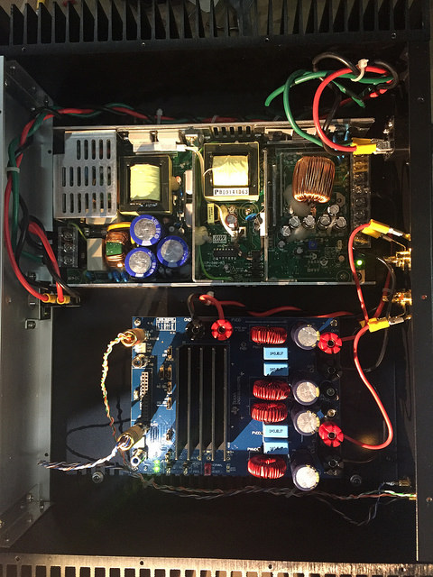

Powered-up my TPA3255EVM for the first time today and there was a high-pitched noise coming from the speakers. I checked the power connections of my system and noticed that the amp was sharing the same power strip as the pc monitor, moved it to a different power strip and high-pitched noise was gone.
Do i like the sound of this amp? Absolutely! This amp made my diy gainclone sound like a "sissy" amp. It has more power, instruments in music have more "weight", I was worried about the high frequency harshness often associated with old class d amps but not on this one. I'm not missing my gainclone amp.
This was my first amp build and because of all the help here it was a pleasant experience for me. Thanks everyone.
^ 😛😉 when I was looking for a ready made enclosure I narrowed it down to 2 units with the same dimensions, this one with the heatsinks was only $7 more expensive (after coupon) than the one without, I went with the cooler looking one 😀😀😀😀
