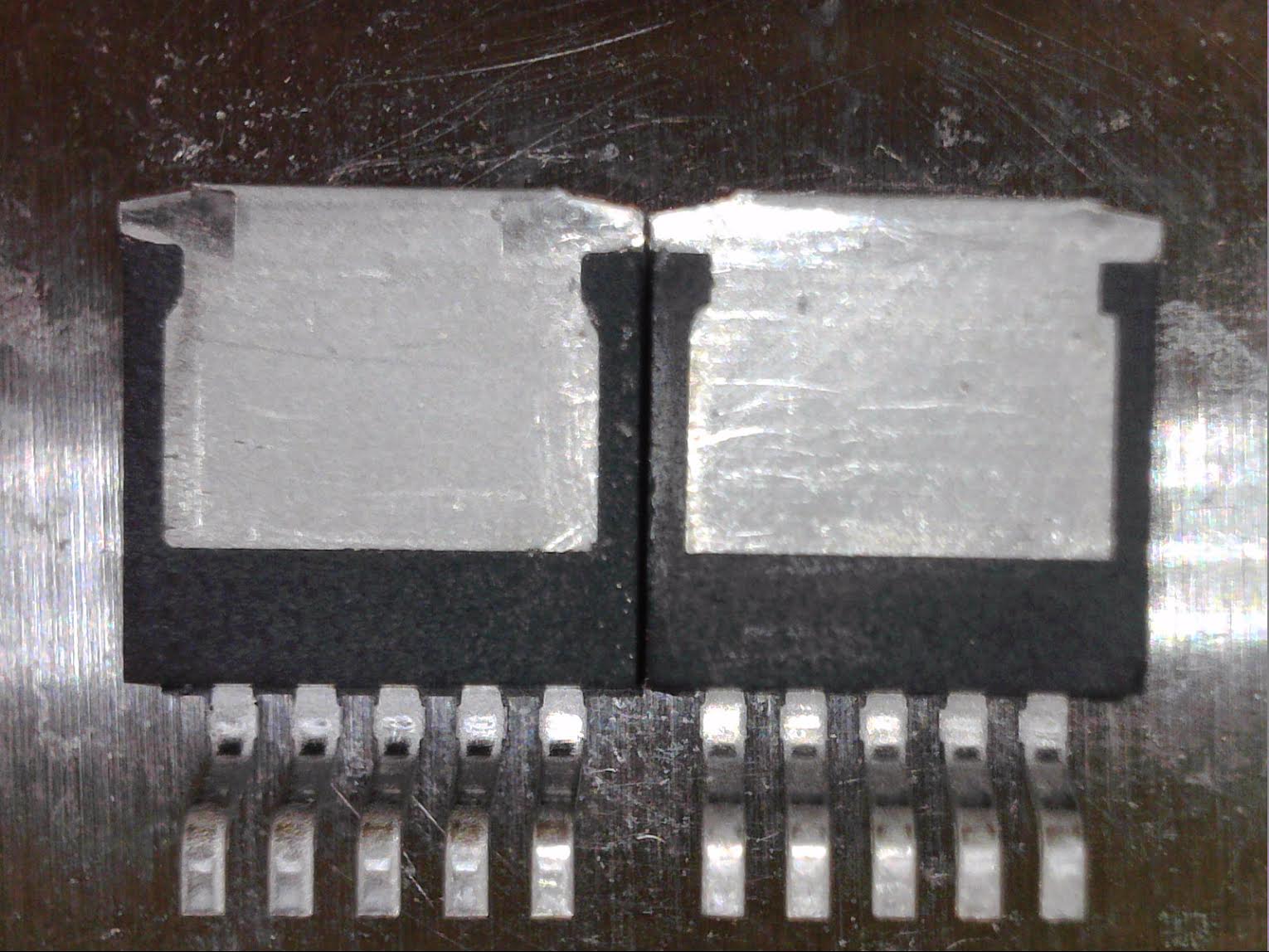

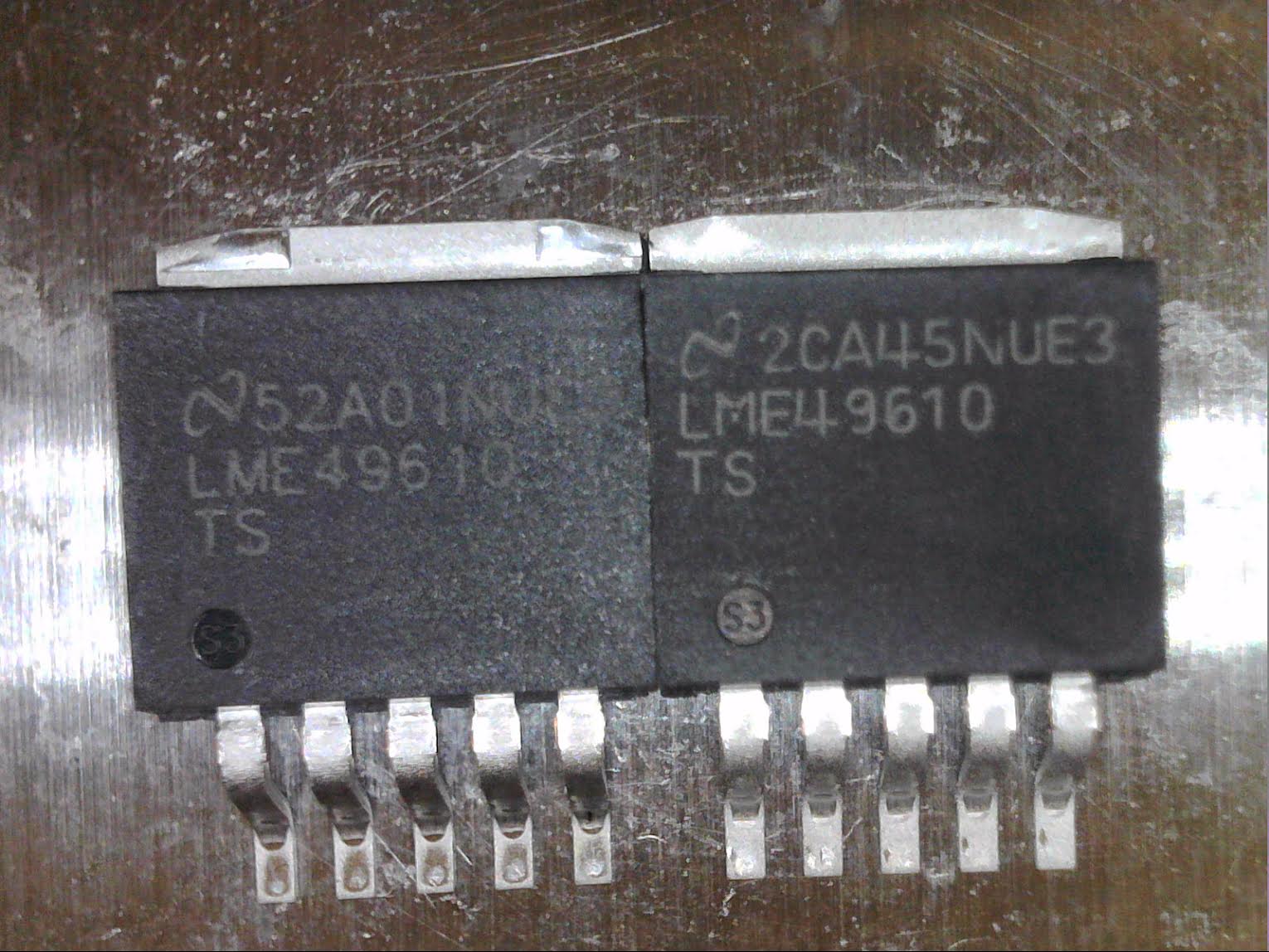

I bought 6 from a seller on eBay and convinced they are fake. Check it out.
My other thread about fakes.
http://www.diyaudio.com/forums/chip...hese-fake-just-another-batch.html#post4749085
Curious to those who have these chips, can you compare and look if any of your genuine ic's look like the ones I got from eBay?? The seller is unresponsive now. And he has 99.8% positive feedback!? I bet he doesn't even know they are fake or I'm not aware of these being made with different fonts and even logo size/proportions. Just looks fishy. The texture of the chip is even different. Very apparent under microscope. But when I look at mouser ic's, digikey and farnell they are all identical other than the number/batch id's.
The photo of side by side- left one is presumed fake and from the eBay seller... The right one is from digikey and genuine.

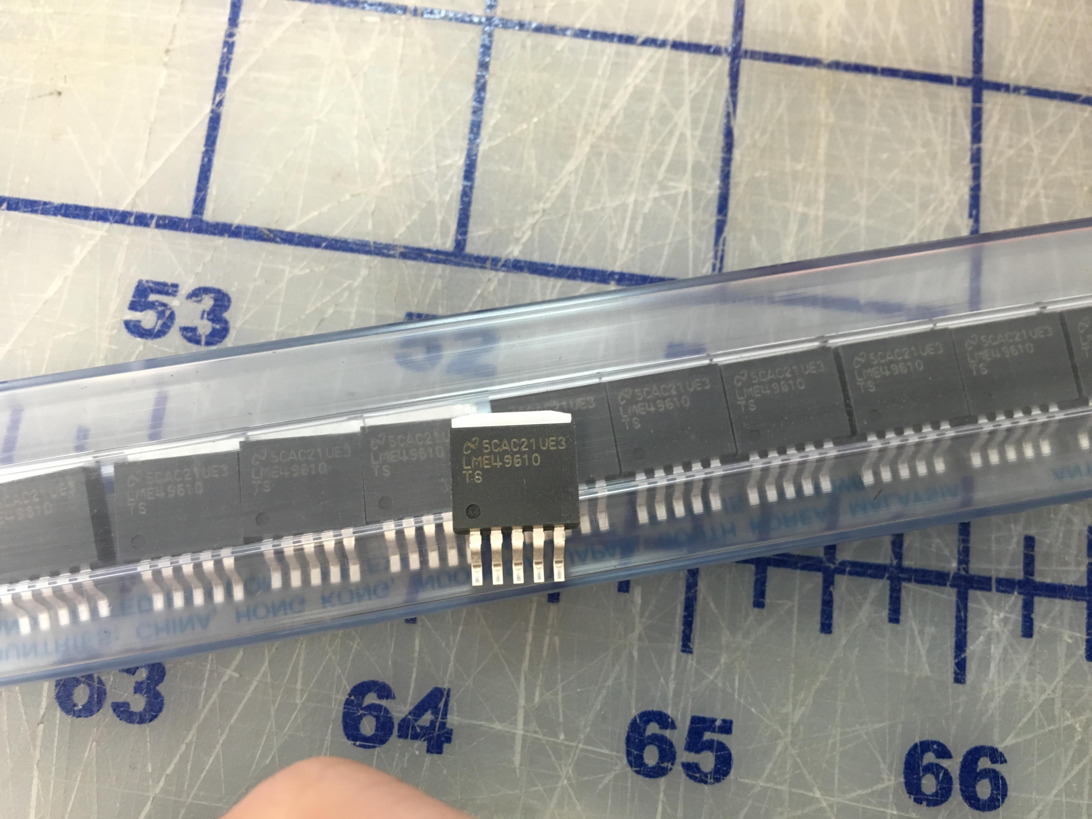

Also the photo with a bunch in the tube is from farnell and genuine. Matches digikey's font exactly.
