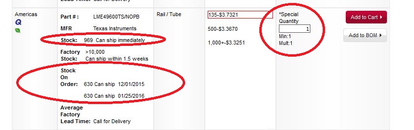

A tip for anyone else looking to buy a quantity of LME49600 for cheaper than Mouser. Arrow is sold out but it appears that Avnet not only has stock, they show stock on order to arrive 12/1/15 and 1/25/16. They often have big minimum quantities, but it looks like they are showing "special quantity" - meaning 1x (!) - for some of the discontinued TI parts.
