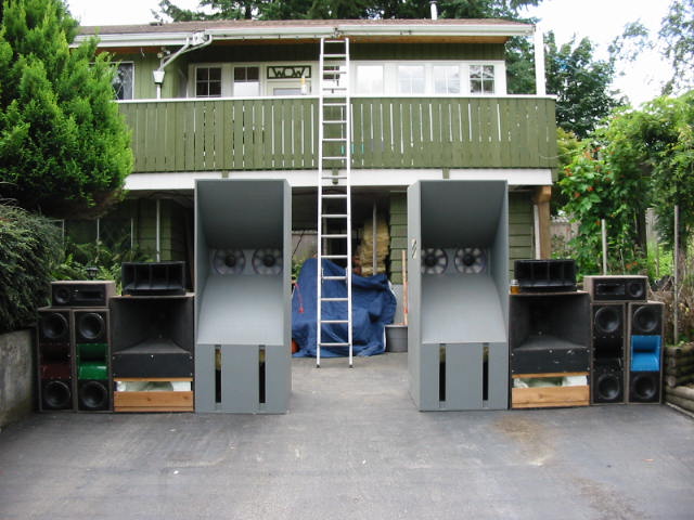

Here is my idea for a barn. I wish I had the place to use them more. I don't have any friends that have a big piece of property and a barn like you.
That would certainly be a Thumpin' Barn.
