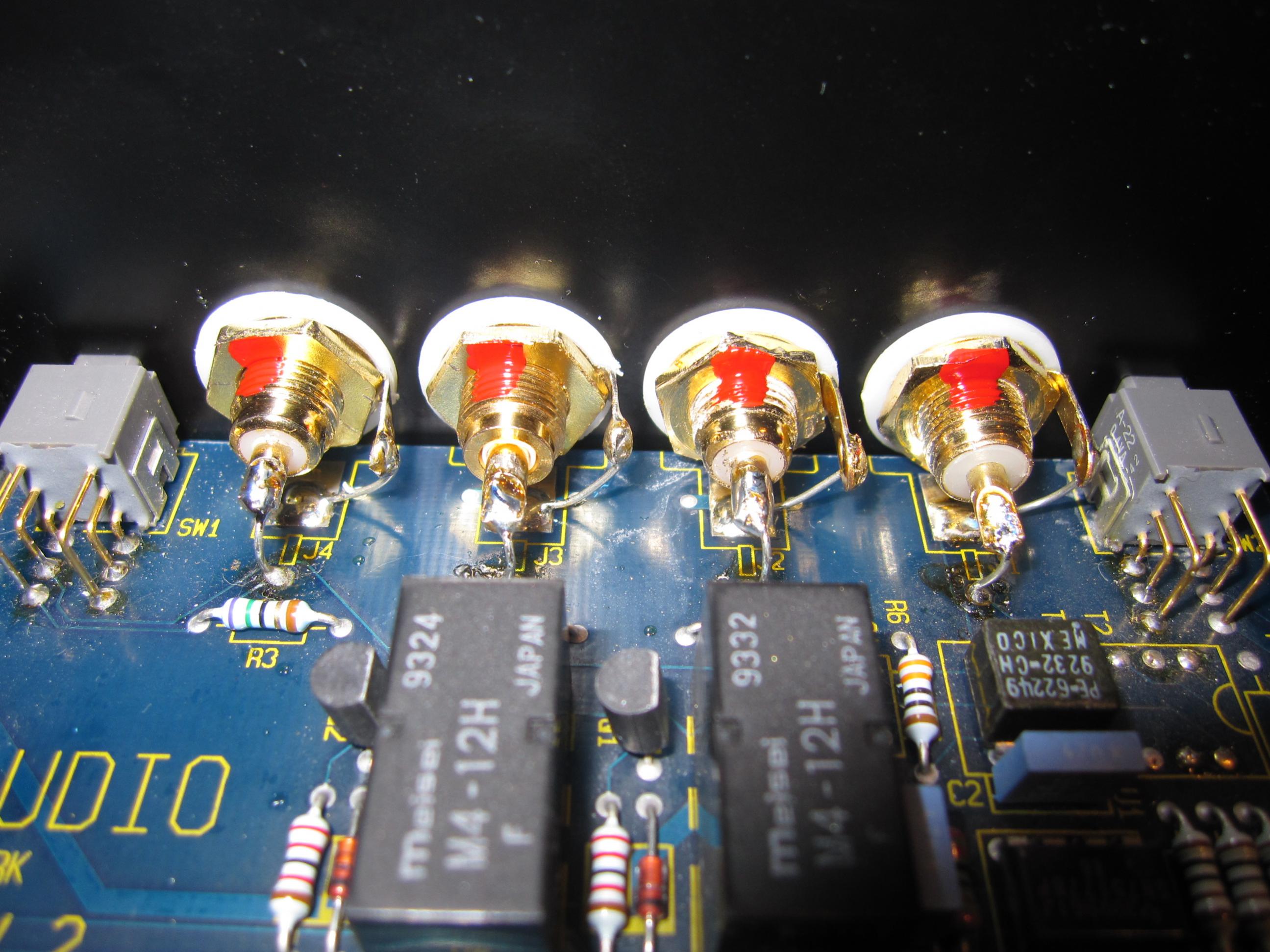

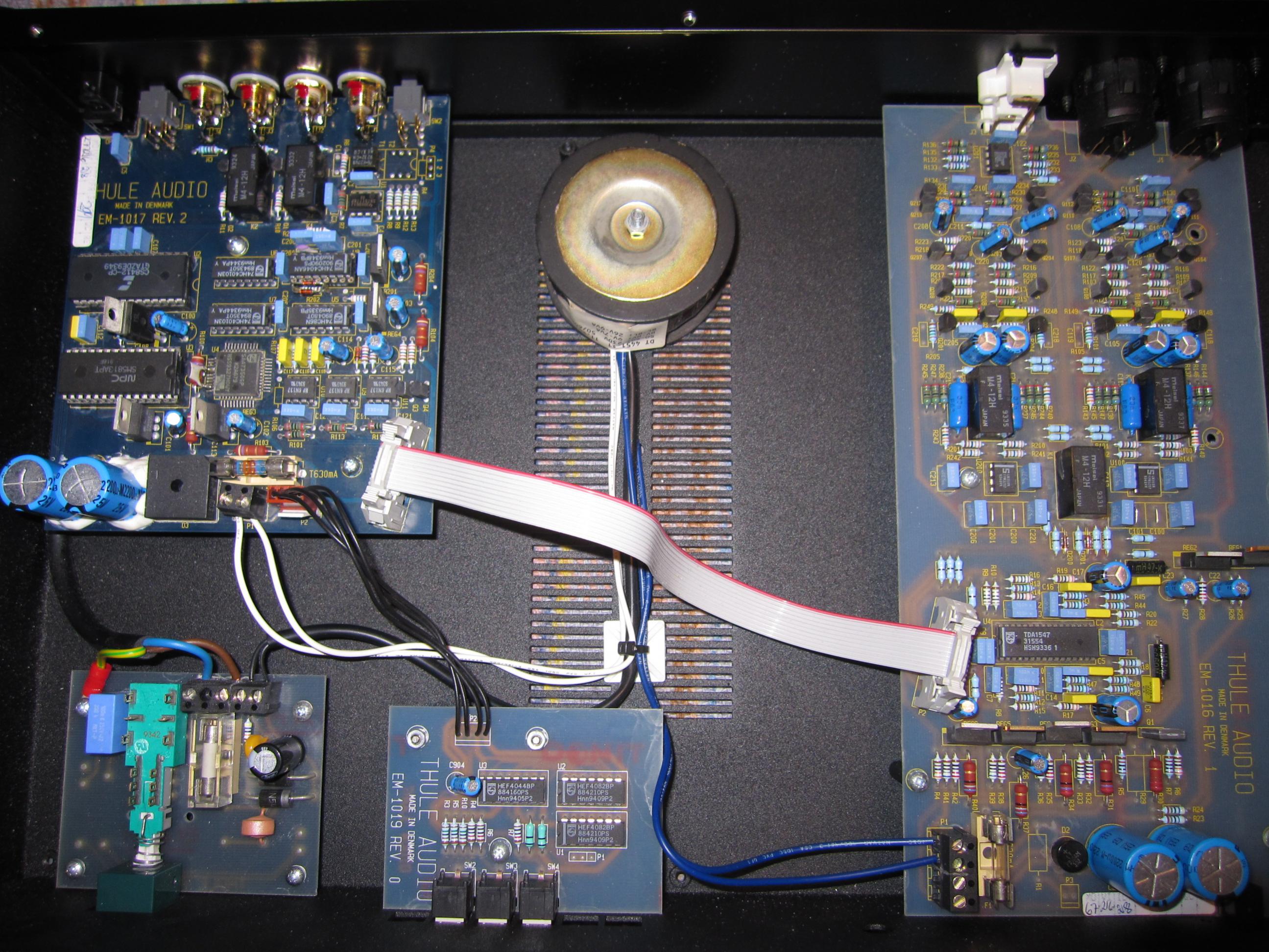

Thank you for your help, but I only want to replace the RCA connectors that have been removed, not to change them to balanced connectors.
I just don't know where either the positive and negative part of the RCA plug are supposed to connect to, on the circuit board, within the dac itself.

the tin-plated rectangular PCB surfaces (your image from post #18 of the PCB aera for the RCA connectors) goes to the negative part of the RCA plug. And the positive part to the small pieces of wires in front of the tin-plated rectangular PCB surfaces like your right estimate from post #18.
Hi agian.
I just thought I'd update you on the DAC200 issue I had.
Thanks to you I've got it all up and runnig, and it sounds great.
I've attached a couple of pics, one of the "repair", the other is just to show the layout etc.

Thank you for this pics. Good pictures and good work. I hope, you haven't forget the shakeproof washer (lockwasher or what ever the right english term) between the gold plated solder tag and the flat hexagonal pressed nut.

I'm afraid I did not add any lock washers as I did not have any with the RCA's.
The tags are soldered and the nuts have a dab of nail varnish (my girlfriends) on them, so I'm hoping they stay put.
As a matter of interest, I wanted to upgrade the caps on both boards, but I forgot, so I'll add some washers when I do this.

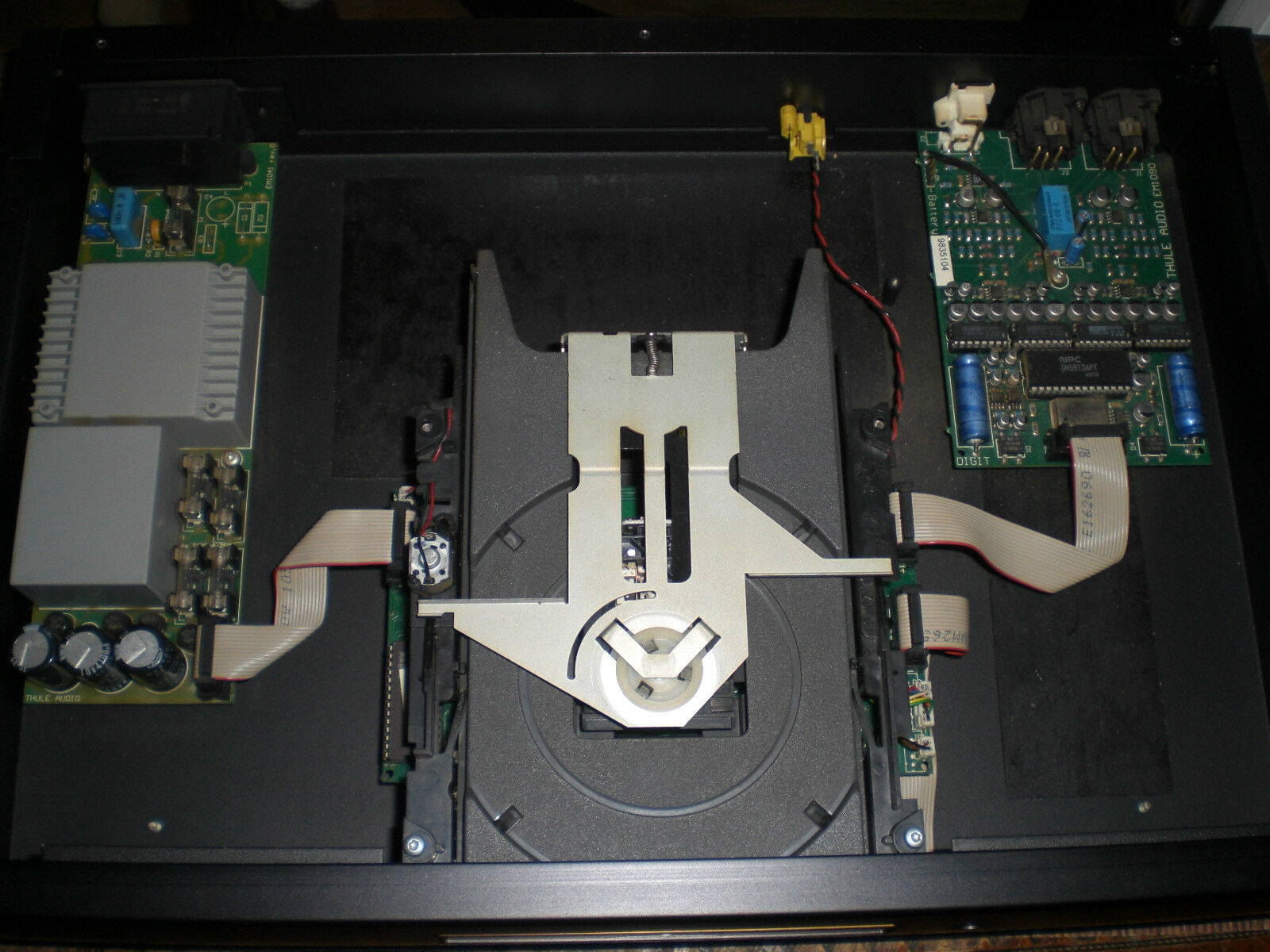

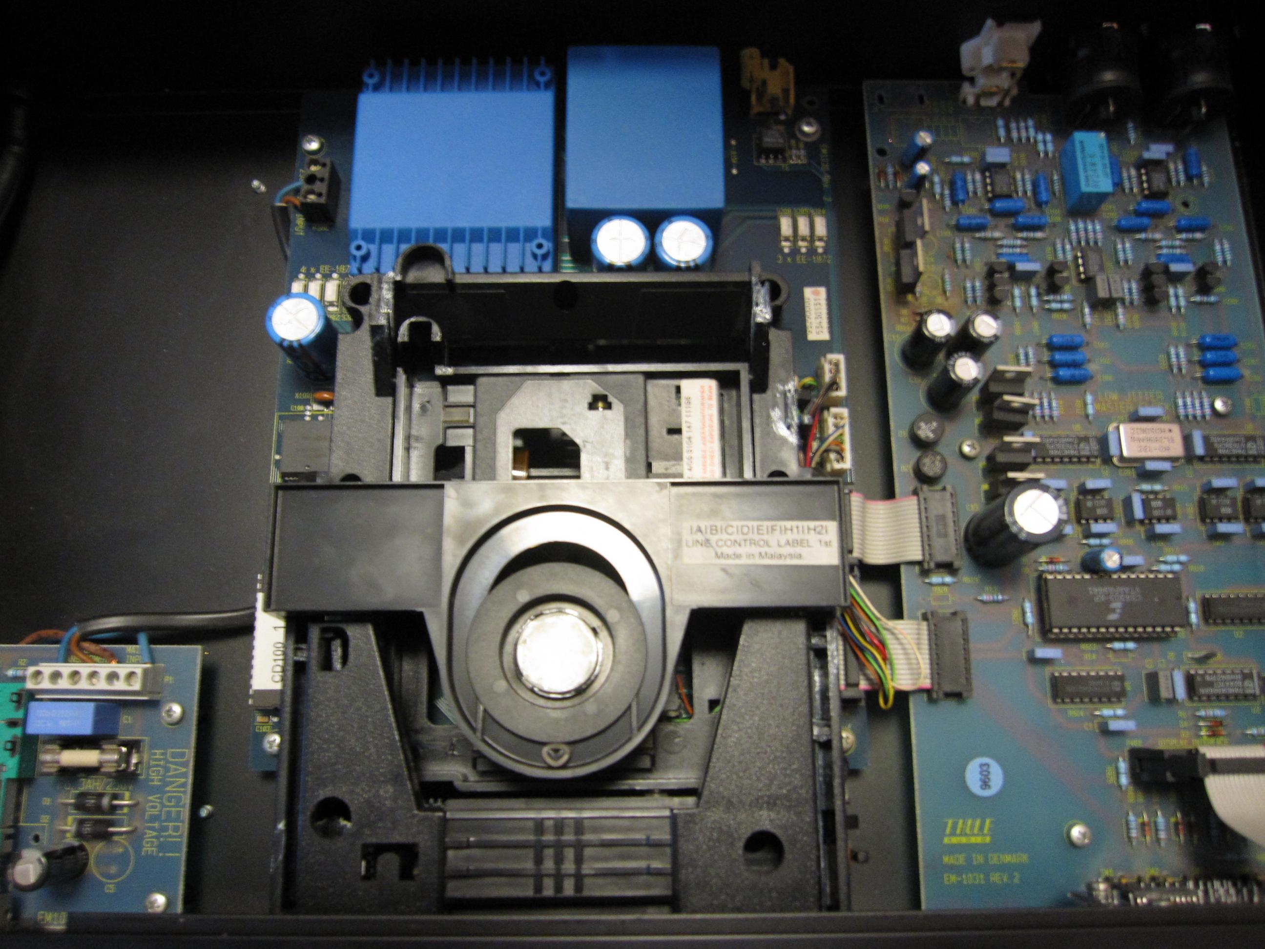

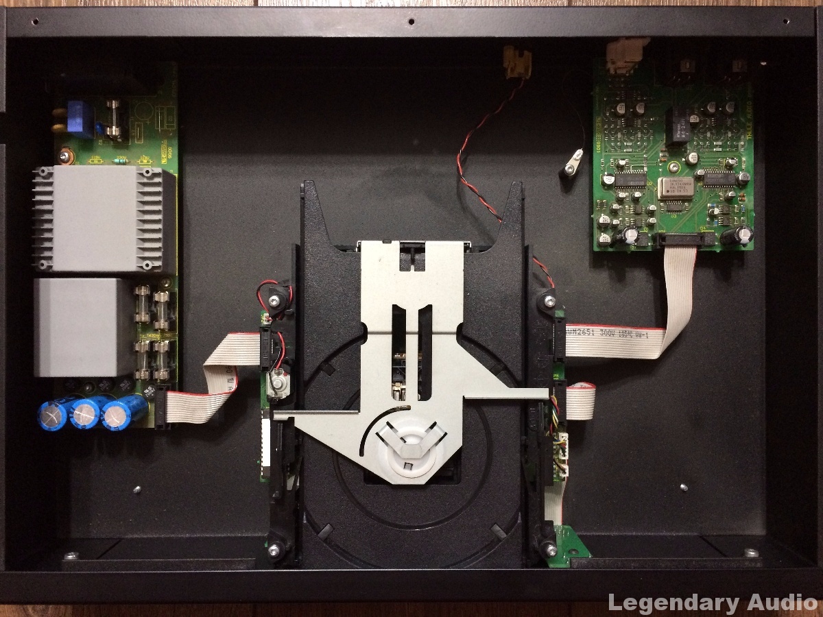

Hi again.
I have a also have a CD100 (not the Spirit), but the only information on it was on another hi-fi site which shows a very spartan inside, no balanced outputs, and the written description goes on to say that it is fitted with a Burr-Brown PCM1710 DAC chip,
Mine (and yours) obviously have the balanced outputs, and I know mine is fitted with a Crystal Semiconductors DAC chip, twin transformer power supply.
Well the question is; why was the CD100 was made in two completely different configurations, but was never sold as a mkI and mkII.
Many thanks,
Si.

Only the designer, Mr. Anders Thule, would be able to answer this question - go to

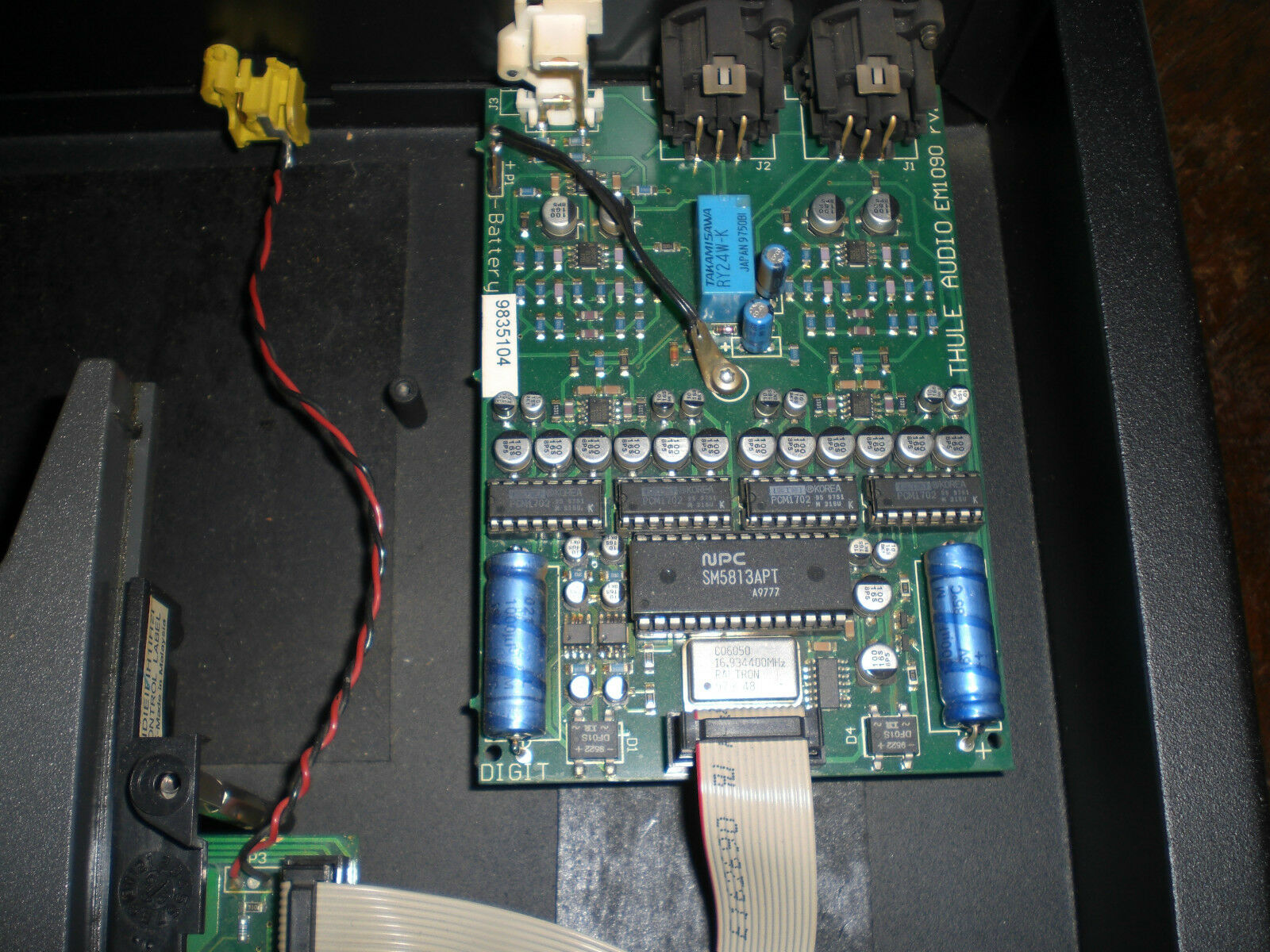

CD-Player "Spirit" Line
CD100 unbal. DAC-PCB 1xPCM1715U or PCM1710U ("Circle"),
CD-150B bal. DAC-PCB 2xPCM1715U or PCM1710U ("Spirit"-Player),
CD-150B + updrade bal. DAC-PCB with 4xPCM1702 ("Digit"-Player)
Upgrade DAC-PCB Kit "Digit" for Upgrade of CD150B ("Spirit-Player") to CD150B ("Digit"-Player)
errors or missing information I can't completly rule out - I am very pleased for appropriate informations
I am looking for a Upgrade DAC-PCB model "Digit" (4xPCM1702 in use) in faulty condition. I need it to perform troubleshooting at my own device. Who can make me an offer ?

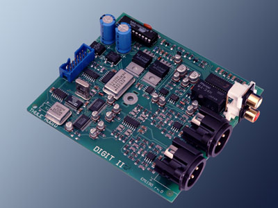

There are also a successor, the "DIGIT-II" - go to
Thule Audio Digit II - Manual - Upsampling Board - HiFi Engine
Oppgradere CD spiller, THULE DVA 150B med DIGIT II
Who can upload the schematic ?
