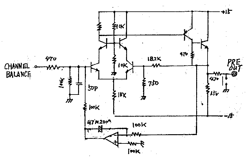

I got two threshold sl10s. one with only aluminium capacitors on it and one with aluminium and tantalum 47uf's on it. My question is: can I put instead of the tantalum teardrop caps, put normal aluminium electrolytic caps on it for an upgrade.
grtz teake
