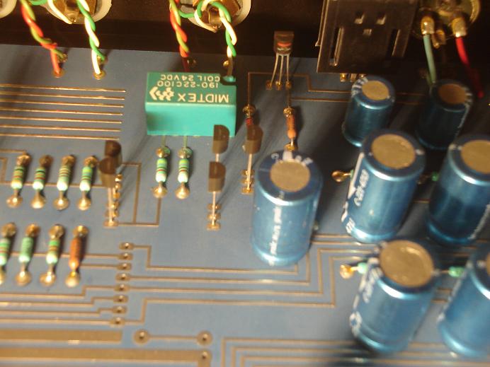

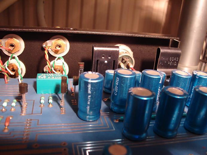

The silverblue caps are named Instrument Devices, big ones C221-4713, smaller ones C221-4705, but still don't know the values, nelson thinks that they are 470uf 25V for the big ones I think, but the smaller ones?
And the black quad opamp is TI RC4136N, is there a better one? It easy to get it out of the socket. Well, I hope you can find out what it all is, Thanks and grtz Teake.

looks that (not just looking at pictures,also looking at schmtc from Nelson's ) 4713 means something like 47x10^1 (470uF) and 3. voltage range
and 4705 means 47x10^0 (47uF) in 5. voltage range
for me (European side ) unusuall way for electrolytics,but ordinary logic for other caps .....

in mentioned schmtc you can see at least 10 47uF caps..........
as Papa Nelson sez-do not touch that OP- it's just servo
besides- if this servo is (was?) good enough for him........

Not real! But first I will get me some new parts, I think I will put in some Elna silmic's, they are really musical, or are there better ones? Than tell me! Thanks Teake.

Yes, Silmic’s should do a great job.
From my point of view a good shunt reg should do a wonderful pre by far better than with the 78/7915 regs. I wouldn’t hesitate, but as always you should test and hear, give it a go and tell us about the results.
Voltage for the regs should be +-15V judging from what it has now (78/7915)

BTW, one word of caution in case you didn’t know: Going back on the thread I see that it was mentioned replacing the original 78/7915 regs by LM317/337, these are NOT direct replacements since 317/337 are adjustable regs and should be accompanied with some other parts to set the voltage.
