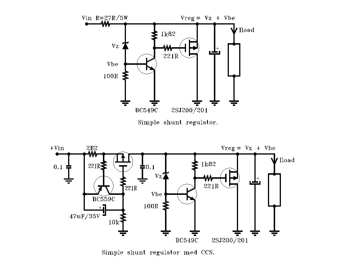

I'd like to see if it sounds any better with a discrete PSU like Erno Borbely's Simple Super Shunt regulator as per attached.
Shall try them once the signal circuits are finalized.
