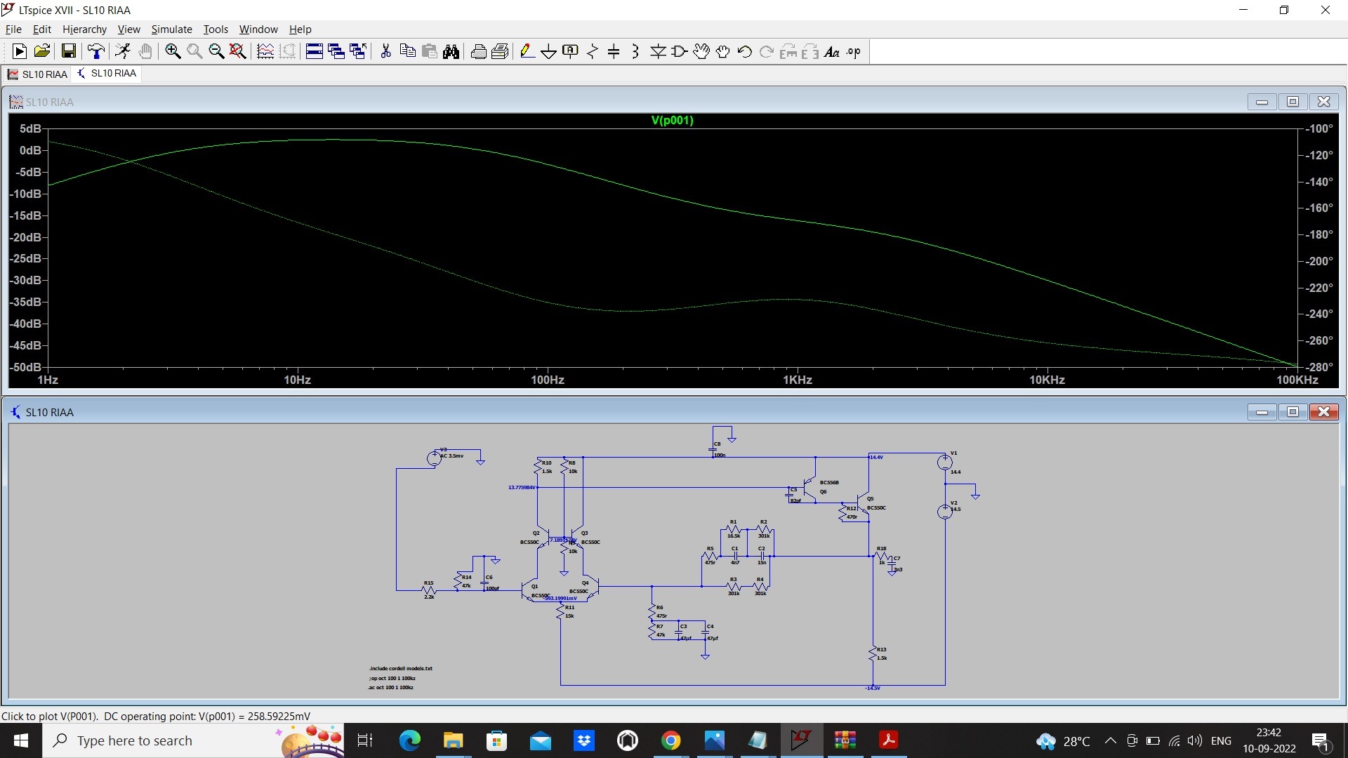

Threshold SL10 RIAA
working as this
sim brain collected somewhere from here, Kudos to originator, whomever it is
Thank you Zen Mod for the corrected sim.
It clears the doubt as to the schematic and components values are correct.
Now to check again the proto circuits to find where it's going wrong.
The capacitor values are checked with LCR meter and the 1% MFR values are matched closely.
Voltages at various nodes are also matching with the sim.
Maybe the 4n7 or 15n RIAA caps which are local box type polyester. Though the measured values are ok.

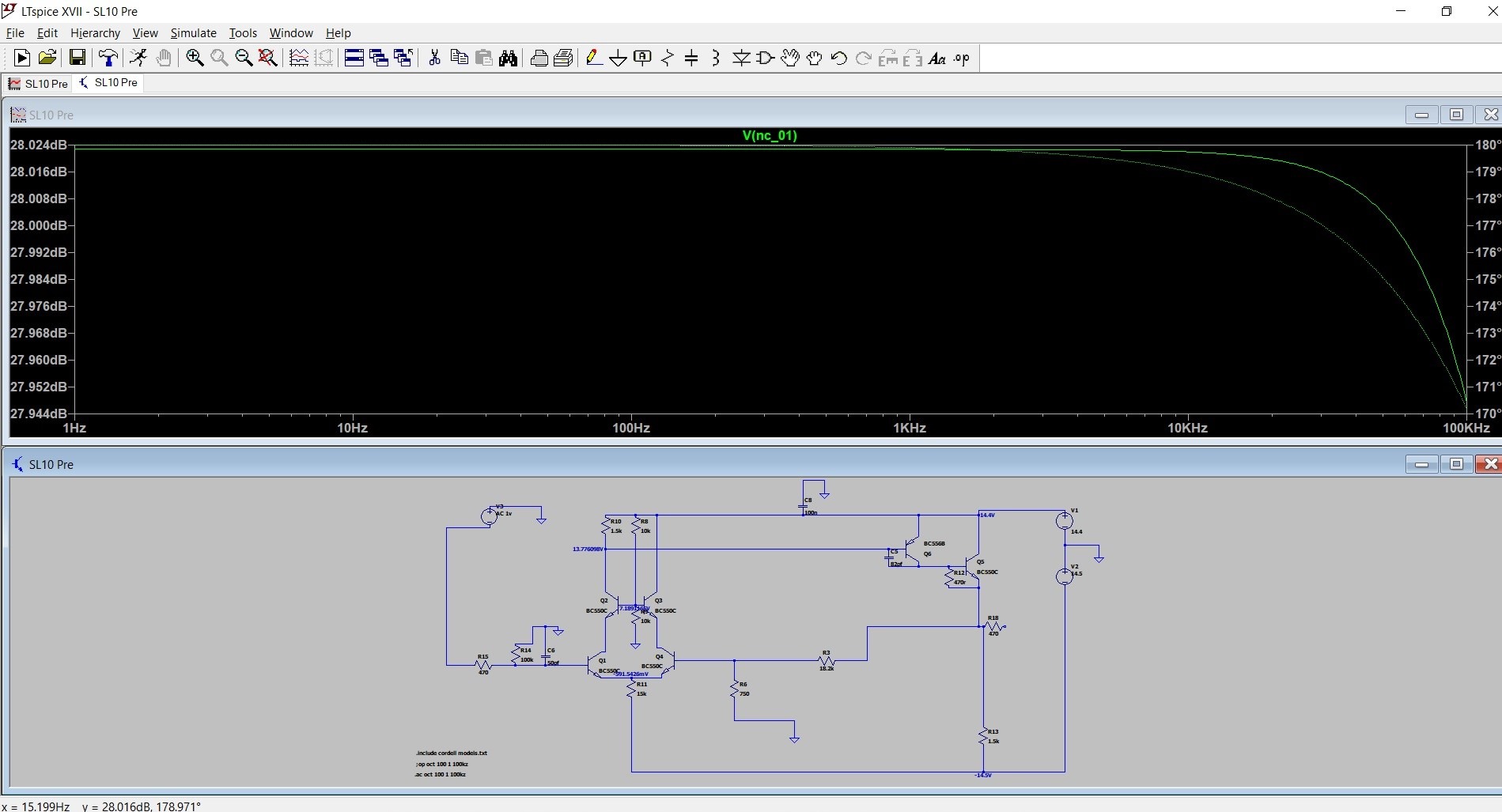

In it's original form, the RIAA of SL10 is supposed to be a very good sounding one (coming from Mr Pass this is not a surprise).
Anyone tried cloning it?
I see discussion on the SL10 High-Level Gain section, but not on RIAA clone.
As the recommended NPN BJTs (MPS6571, MPSA18) are unavailable, I had to opt for the BC550c.
The clone of high-level gain section sounds absolutely fantastic on it's own.

Try removing 4n7, 15n and 3n3 conds (various combinations) and see what happens. This may give some insight into the problem.
With 4n7 and 15n removed (maybe with 300k res bypassed) you should get linear response. Sound should be very thin, no bass. Same sound signature as if connected directly to line input (off course, line input would be much quieter).

As per Zen Mod's updated sim of the RIAA circuit, the component values in the schematic are all right.
So finally I have to look into my proto built for mistake/oversight.
