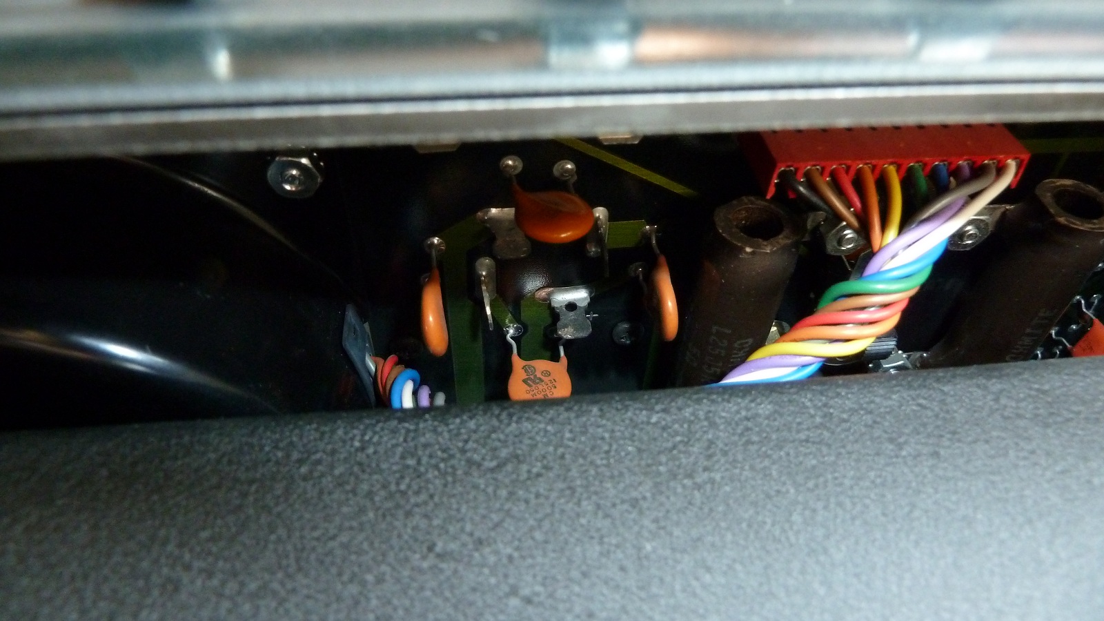

Hi Jacco,
Just for the record:
In my samples the TO3 encased transistors are:
Drivers: 2SA1073/2SC2522 (or 23)
Powertransistors: MJ15023/MJ15022
Had to use a mirror to see them because they're upside down and my reading in mirror writing is not that good...
Maybe the Series I and II had the 2SD600/2SD555 transistors?
These ones:
My bad, typo : 2SB600-2SD555

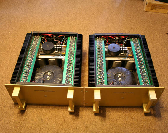

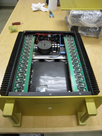

A case of the data-pollution i mentioned, couple of years ago someone started a thread about a pre-series Model 7, had the NEC devices : http://www.diyaudio.com/forums/solid-state/132589-rowland-research-amplifier-help.html#post1653492
Layout of your versions look as the ones i recall : http://www.diyaudio.com/forums/solid-state/132589-rowland-research-amplifier-help.html#post1651458
(Looks as you still have the black lunch boxes out though. One of the M7 series had the main transformer in a square shaped encapsulation, btw)
The pictures with the golden M7's were an example of an much earlier version that got maybe those NEC devices.

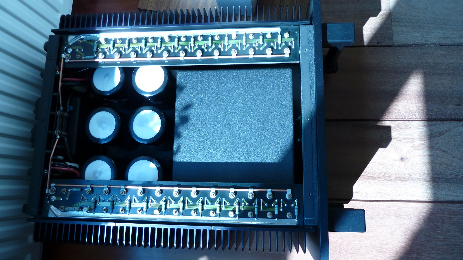

This is my Model 7 (Satin black finish):
It's the transimpedance version (Series IV) with the secondary powersupply for the frontendboard, DC detectioncircuit inside the left heatsink instead of on top of the sixpack.
I also supplied a picture from the Series II that had the maintransformer inside the lunchbox as you mentioned for the fisrt time.
Wait now I know what you ment with lunchboxes:
The encapsulated frontends, not the square enclosure of the toroid!
As far as I can remember Series I and maybe II also had no frontend encapsulated.
Mine has definitely and Series III also.
Maybe that's why I could supply a frontendschematic of the Series II because you could still see the parts.
