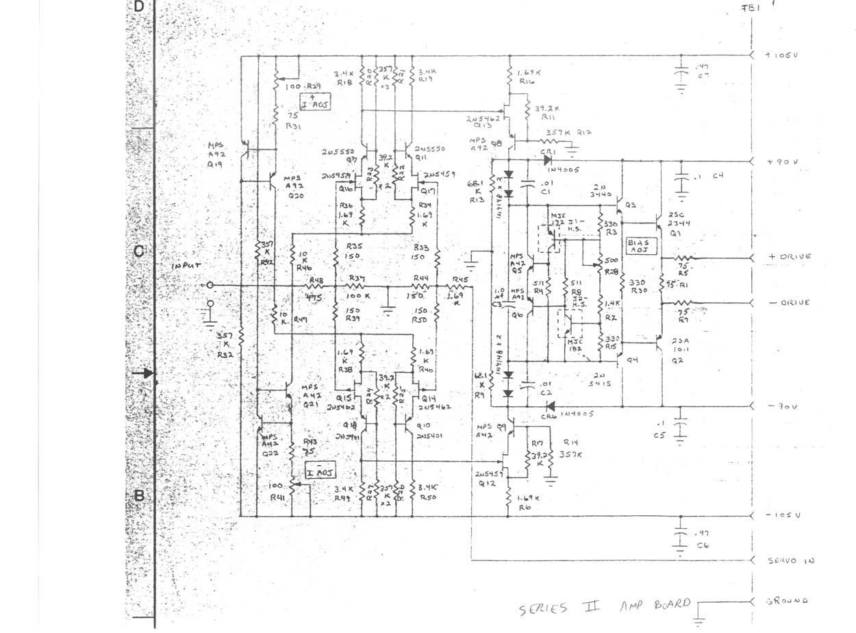

Schematic Frontend Rowland model 7 Series II
I've just an Xeroxcopy of a Series II frontend at the time Rowland did not use the encapsulated versions.
Do not know if the zero-feedback claim has been made to this circuittopology.
But I guess things haven't change very much between the first and the fourth series (actually it is called the transimpedance version and not IV) just like the frontendboards of the different Stasis incarnations between 82 and 89.

Just got TAS Vo. 10 Issue 40 featuring a full review of the Krell KMA Series IV and the Rowland Model 7 Series II at the mail.
On page 77 it is stated that: " ..., and the elimination of negative feedback, both overall and nested-loop."
So this claim of zero NFB is also made for the Series II schematic I supplied.

In the pic you supply at post #19, we can clearly see that the encapsulated modules for Jeff Rowland Model 7 and Model 5 are the same.
The only change must be the output voltage rails, or/and, the number of output transistors...

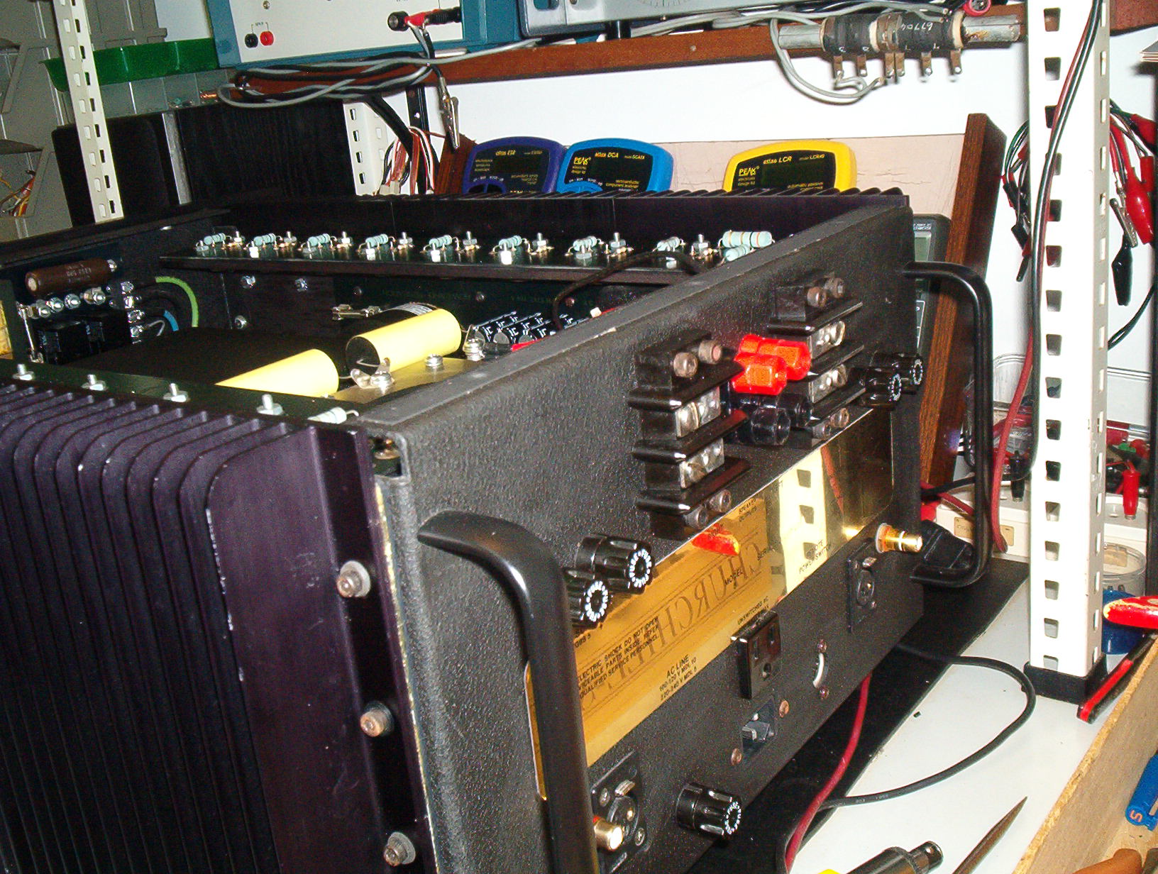

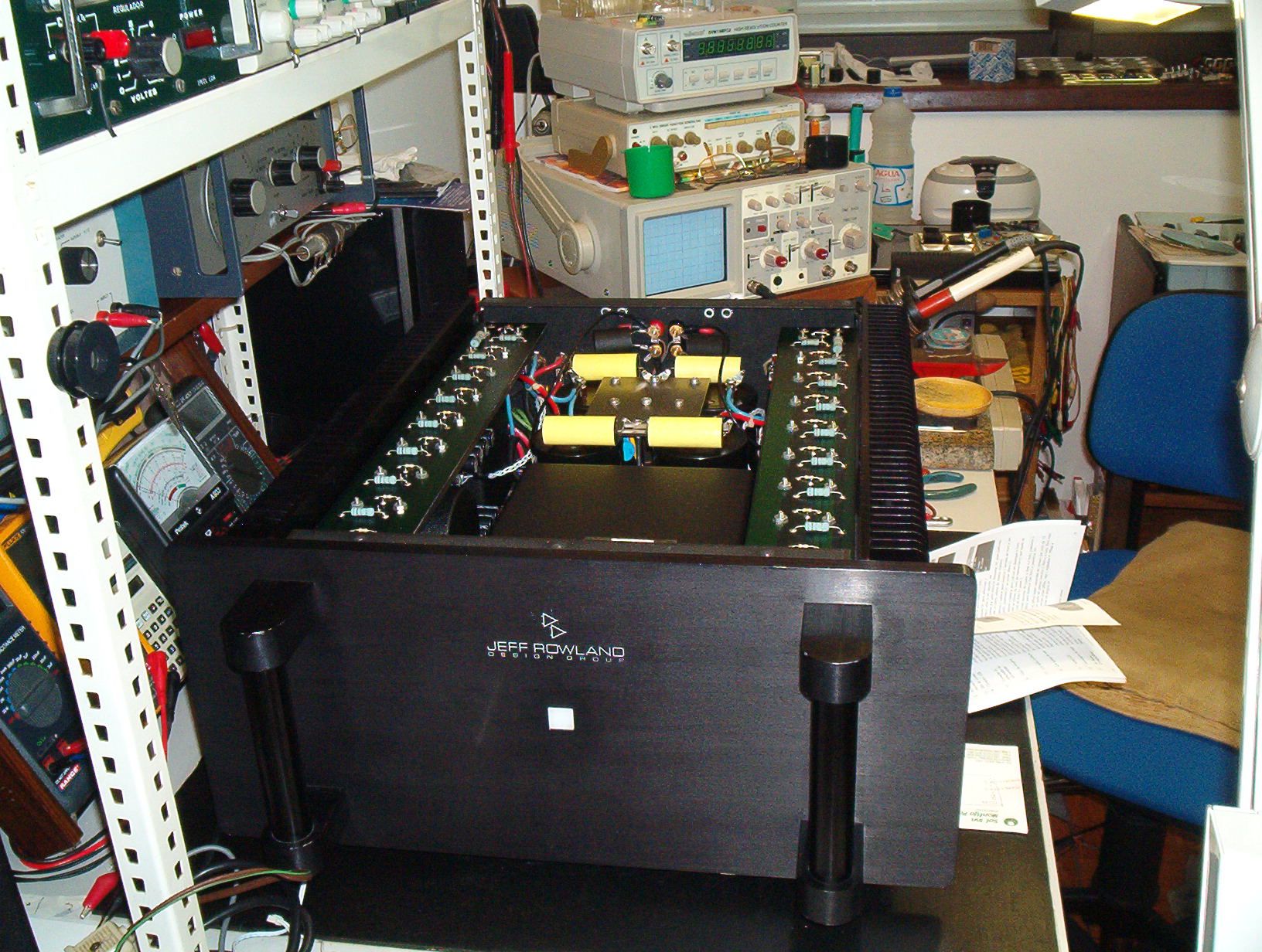

Railvoltage was 94 (due to the AC increase in Europe from 220 to 230) and now 87 Volts. I rewired the toroids for 240 Volts.
24 outputtransistors per channel.
Your amp looks very beautiful inside also...
Are the + and - 125 Volts amber monitoring leds with two parallel 100K resistors also out?
The Jeff Rowland was not mine, I just fix it for a friend, so I can't check anymore, about the amber light implementation.
Yes, it was in very good shape. It have 8 pairs of output devices in each channel, the last one near the back of the amp was the driver, and runs hotter. Thats the reason you can see 9 pairs in each channel.

Now I see in the schematic I supplied that probably MJE 122 & 182 that are mounted on the heatsinks are the monitoring devices for the biascircuit feeding back current into it changing conducting values of Q3 and Q4 or something like that?
