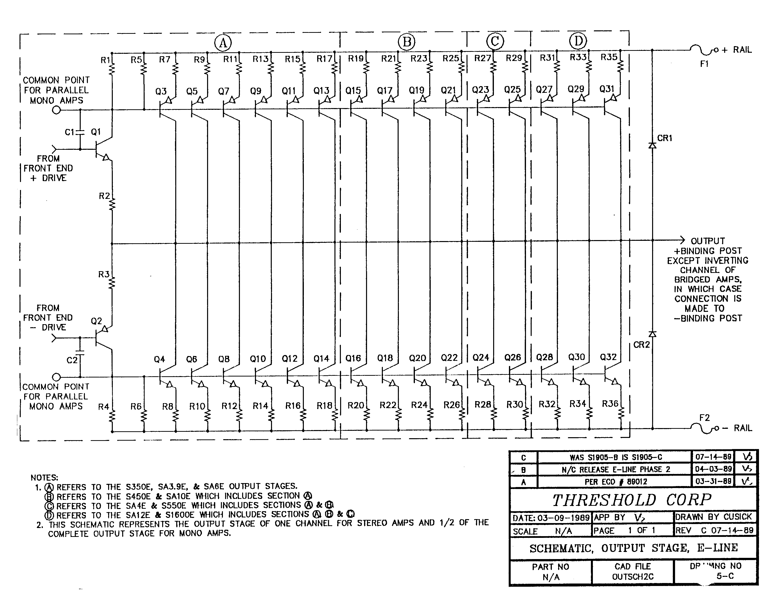

Here is the output stage schematic for all these, which
allows for some comparison for hardware and potential
bias figures.

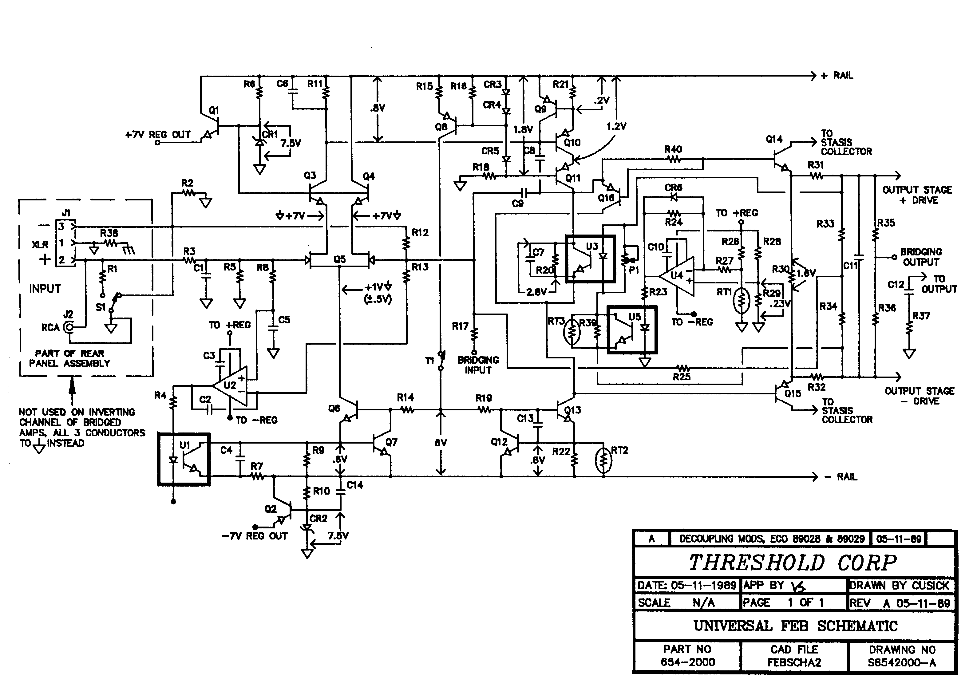

There were several front ends. This is the last production
while I was there. There was a more perfect circuit that
has been designed, but when I left the new "management"
had declined to use it.

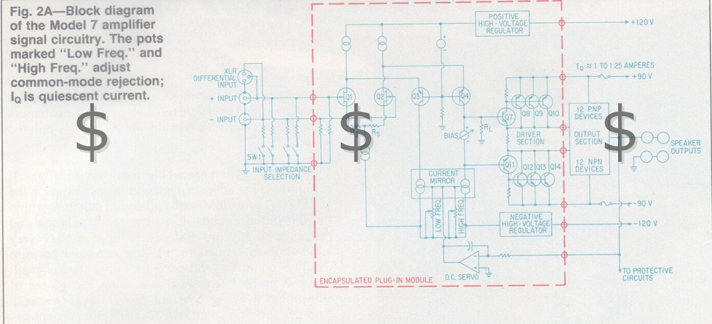

I supplied a scan of the simplified schematic published in the Audio Magazine of April 1990 page 58.

no local , no nested ........... but cleverly nothing about degeneration ..... :clown:
anyway - now is perfect time - that you draw schm of da thing , and share with us
when reviewers say "no feedback", they almost always mean "no global feedback" or no feedback across more than one stage.
the simplified rowland schematic showed earlier cannot be truly "no feedback" with a dc servo as well as the usual bias controller.

Yes I know but here we have Cordesman, Lipnick and Kessler from three different Anglosaxon leading audio-magazins that specifically say that there is no feedback at all in the Model 7's.
Lipnick says: "The Model 7, just as with all of Jeff Rowland's designs, utilizes no feedback, nested or global." Well that's not multi-interpretable it seems to me.
But as already stated I'm really interested how the mechanism works of having a huge powersupply to countereffect the absence of NFB?

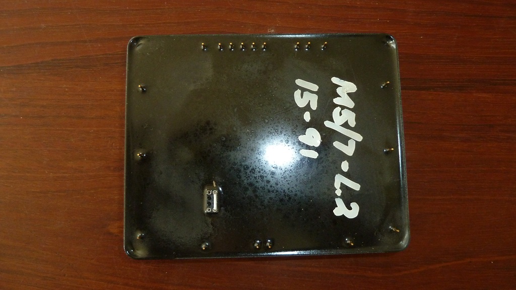

Thanks for sharing the schematic, I have been working in Jeff Rouland Model 5, and wondering what must be inside the encapsulated capsules
It's only a simplified schematic according to the reviewer of Audio.
You probaly need a X-Ray machine to see at all cause Jeff won't share it with you.
On his new site under 'Schematic policy': "All Jeff Rowland Design Group product schematics are proprietary and as such are not available for distribution."
I made a picture of the back of that module and there you can see how to alter the gainsetting from 20 to 32 dB.
20 dB is all connections removed.
26 dB as in the picture shown the factory default.
29.5 dB connector to the other site.
32 dB both connected.
I removed all connections to match it with my Krell KRC preamp.
According to Rowland this operation had to be performed by a authorized dealer because of the risk to bend one of the 19 pins.
