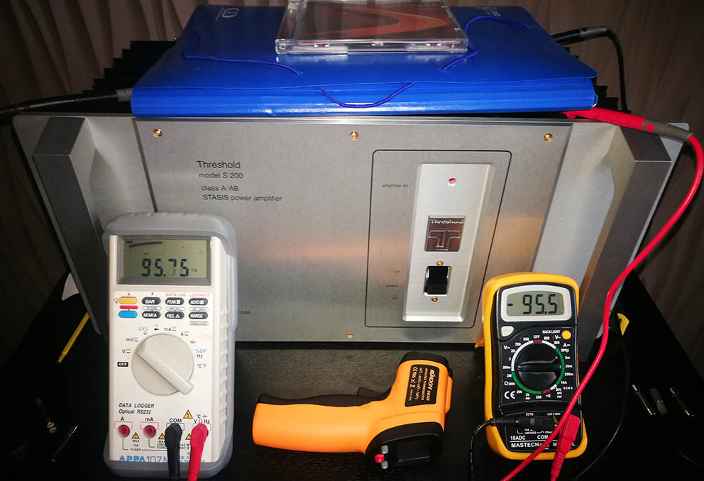

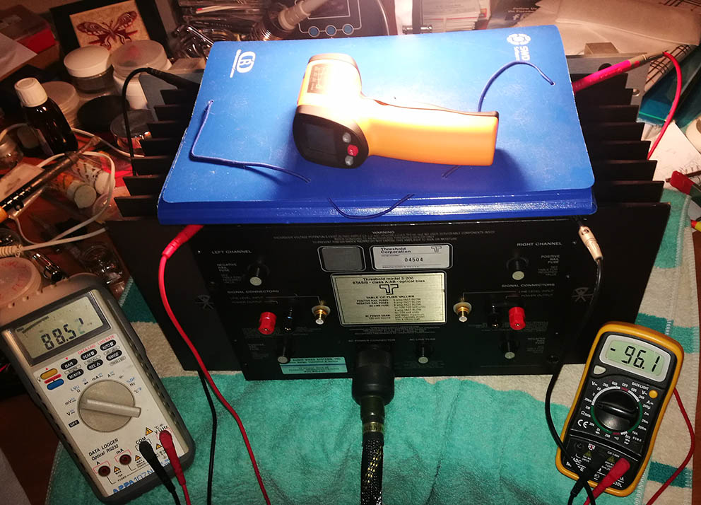

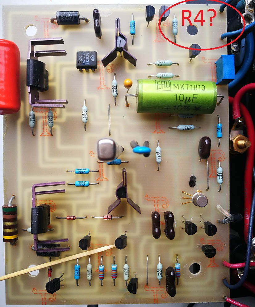

The amp came in so-so condition, so it was fixed, tested, measured (dc offset: right ch 13mV / left ch 107mV), disassembled, cleaned (no bad soldering points found), measured, trim pot replaced, pictured, assembled, adjusted based on the recommendations from DIYAUDIO, thanks to Mr. Pass, Zen Mod, and other beautiful and kind people from this forum.
Here I share some pics and hints I used...

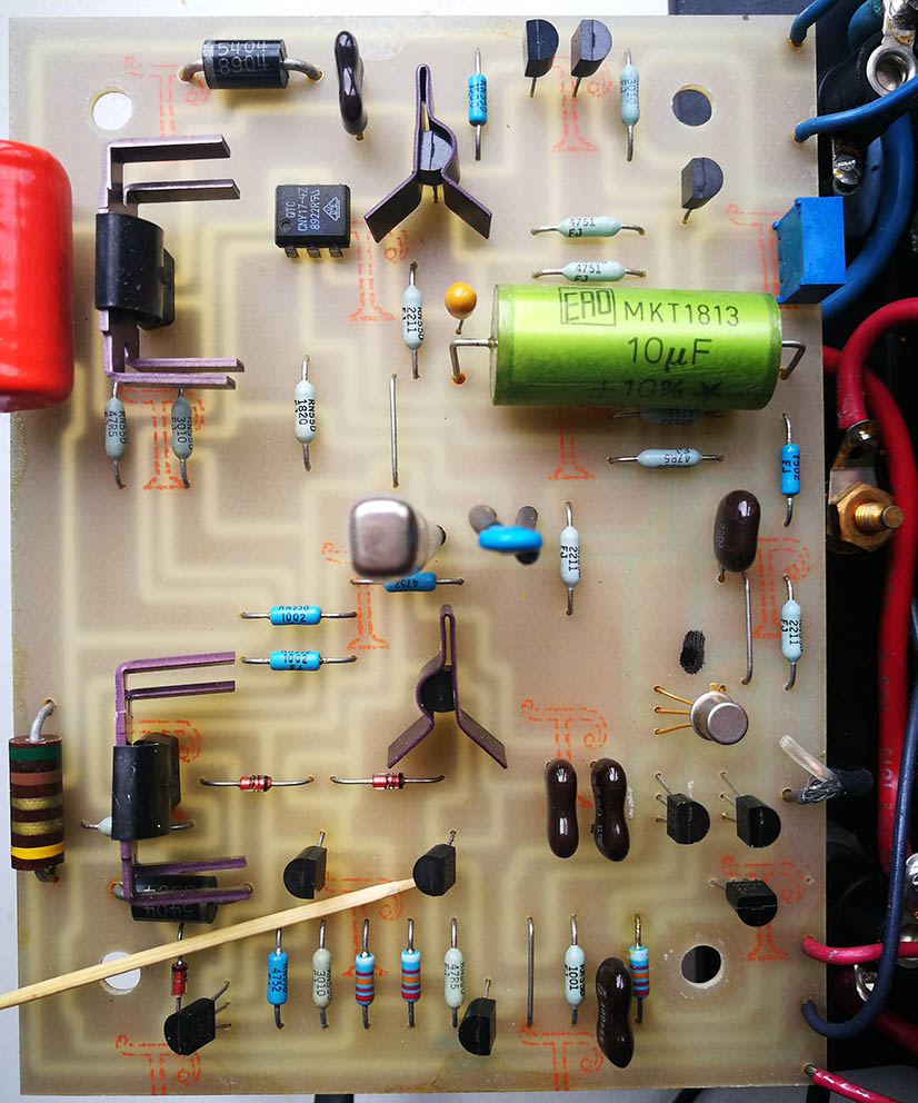

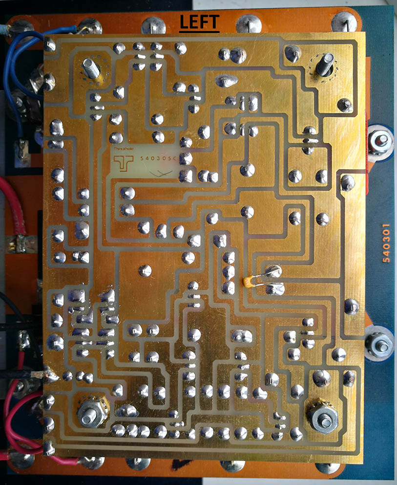

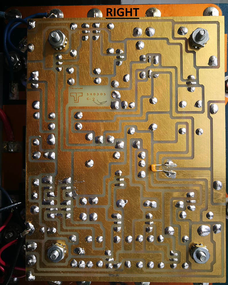

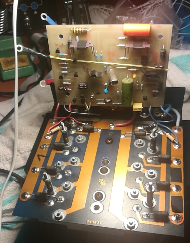

I was surprised to see 2K trim pots on s200 driver boards, and I did not have them at home, so replaced them with 5K Spectrol multiturn, works fine!
Unfortunately, I did not have 0.15 uF film (only 0.1uF) to replace 0.15 uF 35V tantalum (I guess they are optocupler shunt caps) so I left them on until I will be able to shop them.

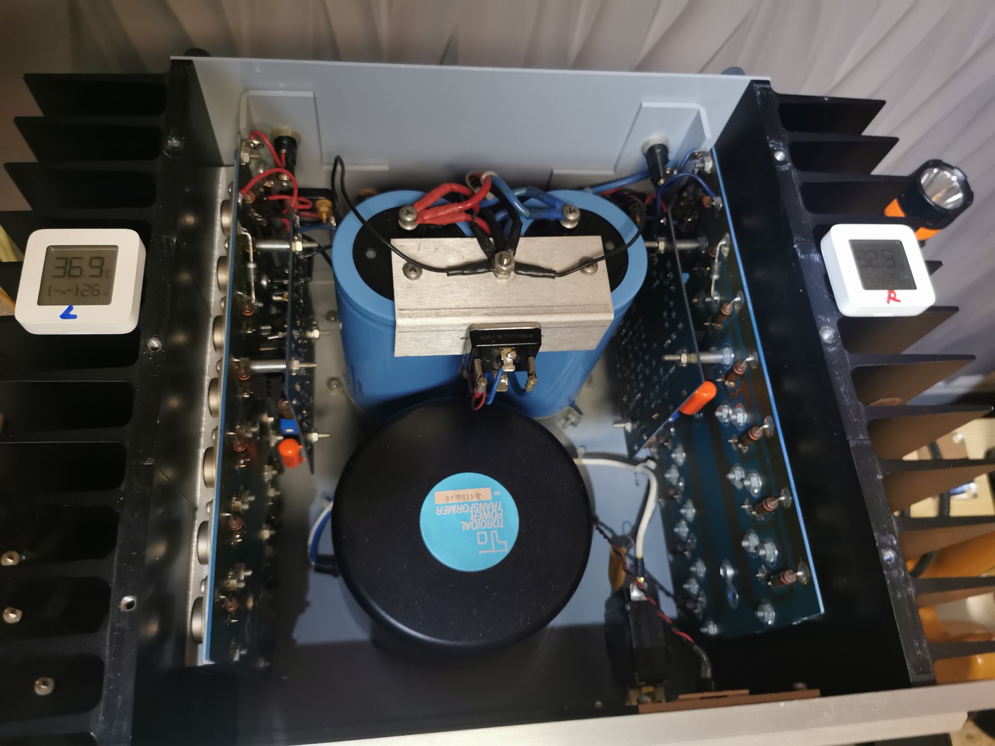

Caps are original grey 15000 uF 75V MEPCO.

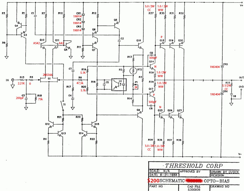

I also found that all 1Ohm 2W WW resistors have a bad tolerance from 0.88 up to 1.07 Ohm.
I was surprised to found that 3 Ohm 2W emitter resistors are Carbon Composition… Do I need to replace them with nice Dali WW?

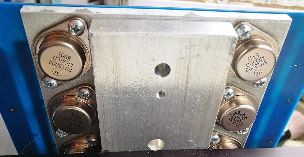

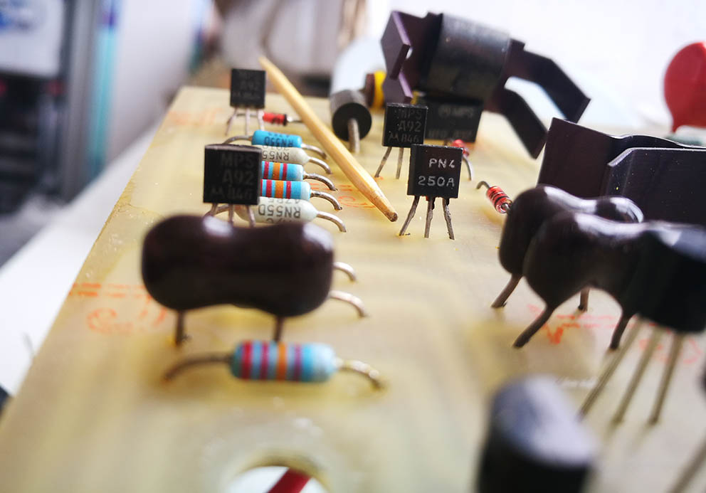

All output transistors are original 15004 (PNP) and 15003 (NPN), 1988 and 1989 year of manufacturing, the rest are: 2N5566, MPSU10, MPSU60, MPSA42, MPSA92, but also a one I never seen in Stasis before – PN4250A (see the pics), but the soldering points looks like original…
I wash the driver boards with toothbrush and flux cleaning, so they looks nice now.

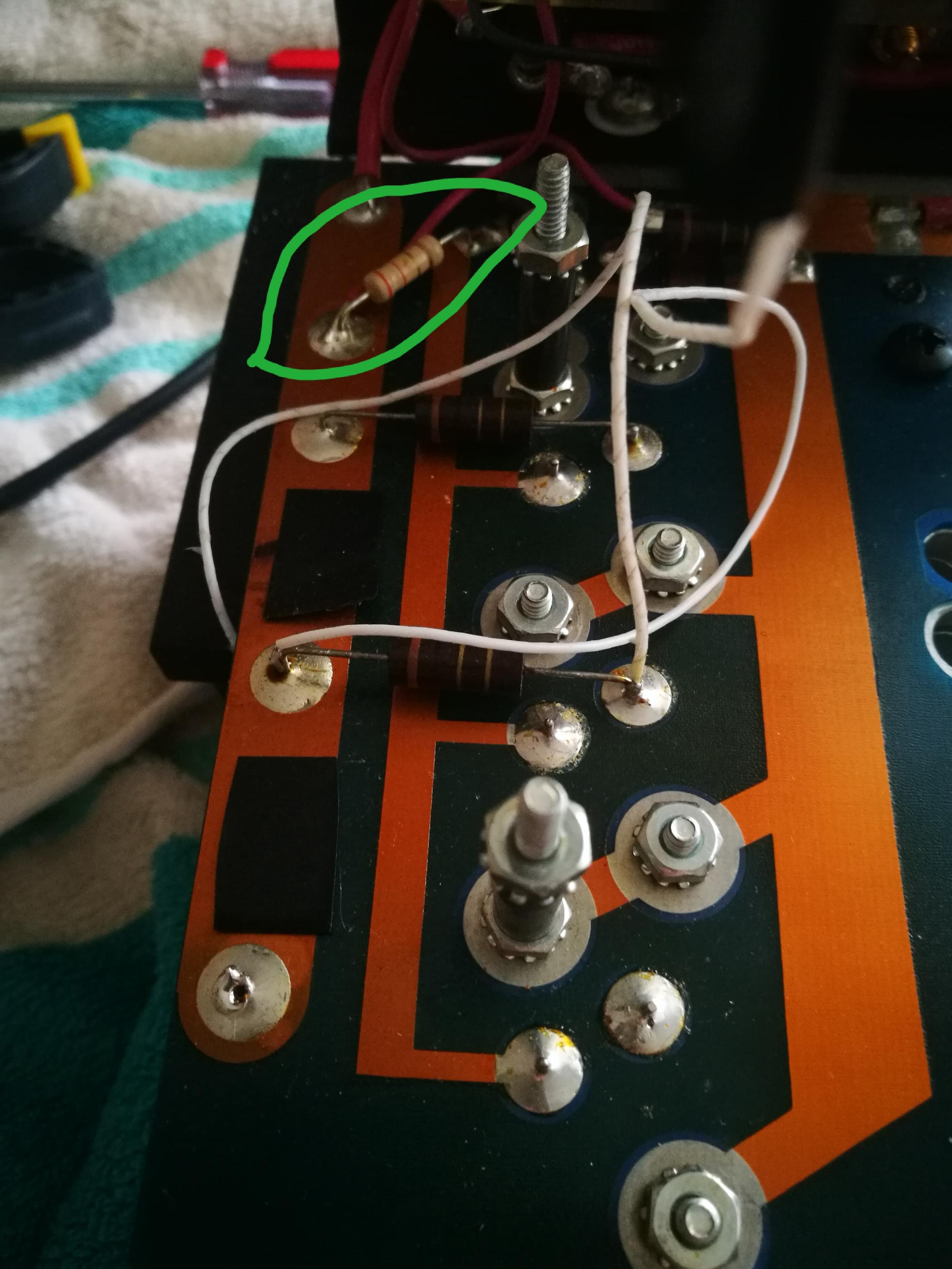

To avoid occasional shorts (heh I had a bad experience before) I solder thin temporary wires across the middle emitter resistor on the positive rail, so it was very convenient to measure the voltage drop and to fine tune, thanks to the multiturn trim tops. Use a pare file as a top cover.
Finally I ended up with 51.1 degree on both sides, with voltage drop of 95,75mV vs 95.5mV per channel after 2H, and it works quite stable, I would say it perfectly tuned. Maybe a bit hot…
DC offset now lowered down to 97mV. Still need advice were to dig to fix.

C5 isn't critical in value
for output offset - either leave it as is, or try to fine tune R4
which means - read it's value , then replace with fixed resistor and variable resistor (trimpot) in series, so you can alter it +/-20% of original value
Another idea is to drill the 3rd hole and put trimpot 0.5k instead of R4, or will drift?C5 isn't critical in value
value
PN - it certainly look originally soldered in, so don't bother
if resistor is 300R, replace it with 270R fixed in series wit 50R multiturn
pre-set to 300R prior to powering on, then fiddle
better as I described
lesser chance to go out of safe area
Sure, agree! Thank you! will check if I have small value trimpot at home.better as I described
One more question.... there are two carbon composition resistors 3 Ohm 2W each. What are their purpose and why are they CC but not film or WW?
Do the resistors that look like Carbon Comp have wider first color band? If so the wide band signifies wire wound.

As per the known scheme with components list of the first gen, these two are CC
All emitter resistors were replaced with 2.5W Dale NS-2C non-inductive resistors.

After R6 300Ohm replaced with 330Ohm both channels shows just perfectly equal figures ~11mV dc offset.
After R27, R26 3W resistor removed, it measured as 3.3 Ohm which is different from schematics.
I do not know if this is a bug of feature, and how the 3 Ohm replacement can influence the amp, please advice?
3R3 is sorta standard and difference from 3R to 3R3 is irrelevant
besides, 0R3 difference - you need something else than DMM to measure that precisely (probes together - what's reading?)
put them back, or put new ones (3R3) and enjoy

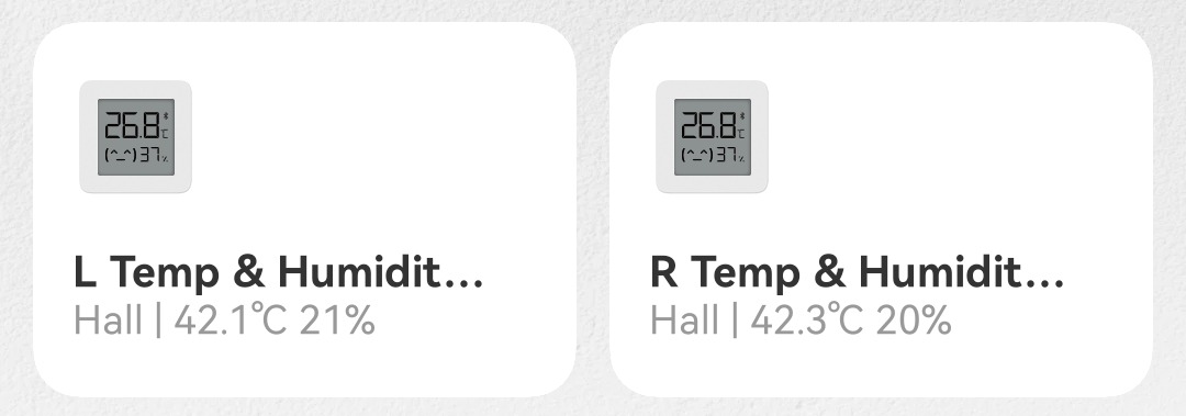

Paired MIJIA smarthome with Threshold amp. =)
Just open the lid, turn the pot, close the lid and control the temp via app. Repean until you done it.
