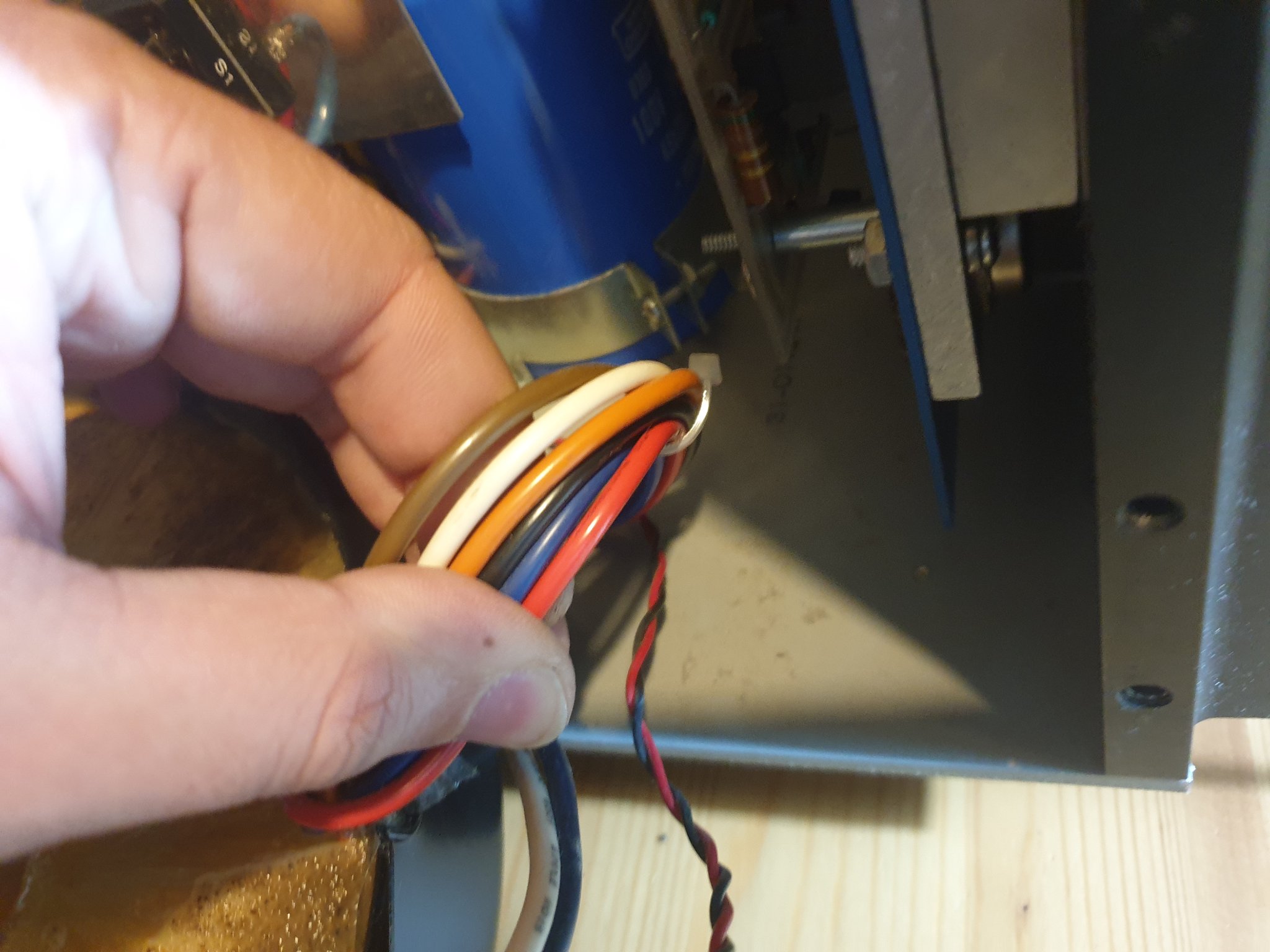

Tested volte of one secondary and it is 38v, so I will be rounding up to 40. What I do not totaly understant yet is why the primaries have 6 wires - I am assuming two primaries with 110-0-100. Hooking a 0-230 instead should easy enough. Can anybody comment on the VA rating needed, is 500va overkill? Read somewhere about 400w, bI guess a bit of reserve can not be so bad

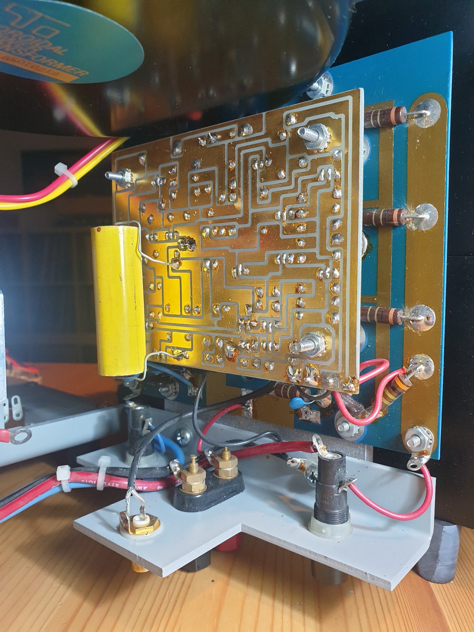

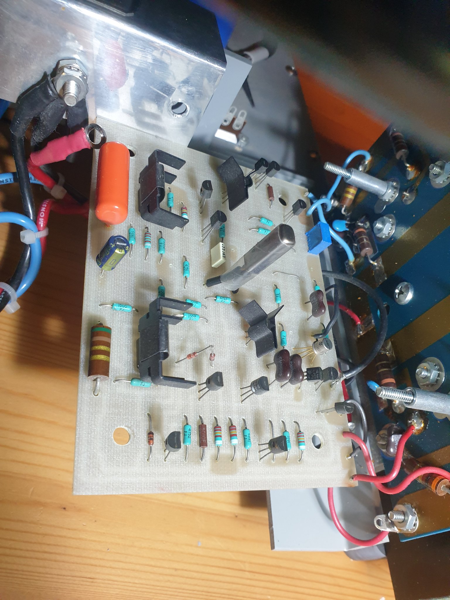

Here are a few fotos. Wondering if the big MKPs are original or some form of tuning?

Replaced big blue cans with higher rated ones. Also replaced the 2 elcos and tantals iirc and bridge rectifier.

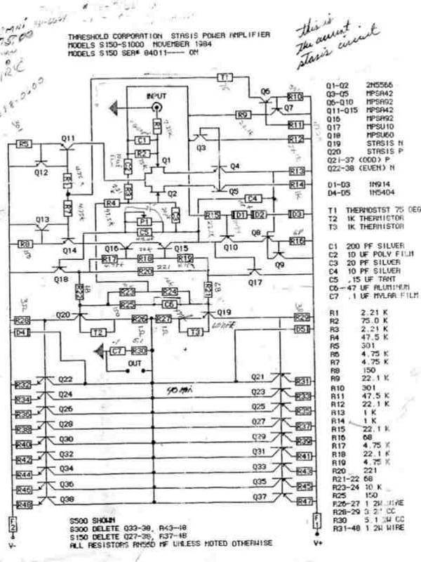

Here is a link to the schematic I use:
https://www.diyaudio.com/community/attachments/schematics-threshold-s150-s1000-amp-jpg.135878/
Tried the biasing procedure that you posted more than once. With the bias at 160 the heatsink reached about 40C (aproximated). Will measure over the weekend as i need to borrow a ir thermometer from work
That channel was not quite right ever since i got the amp, but was hooing it will get better after i change the caps, but it obviously did not.

Man that did the trick. Had to improvise a bit as i had no 120k on hand so i did 3x33k.
The bias is set to 180mv with the trimmer set in the middle.
I can not thank ypu enough for your help, wo if you ever find yourself in frankfurt, alcoholic beverages are on me
