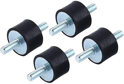

I intend on applying a sheet of alubutyl between the transformer and case to see if something changes. I am preparing myself not to be dissapointed if it changes nothing.
There are rubber washers between case and xformer, that is why i think that anti vibration devices will do nothing.
Also placed some rubber pieces between screw and xformer case, but that also did nothing.

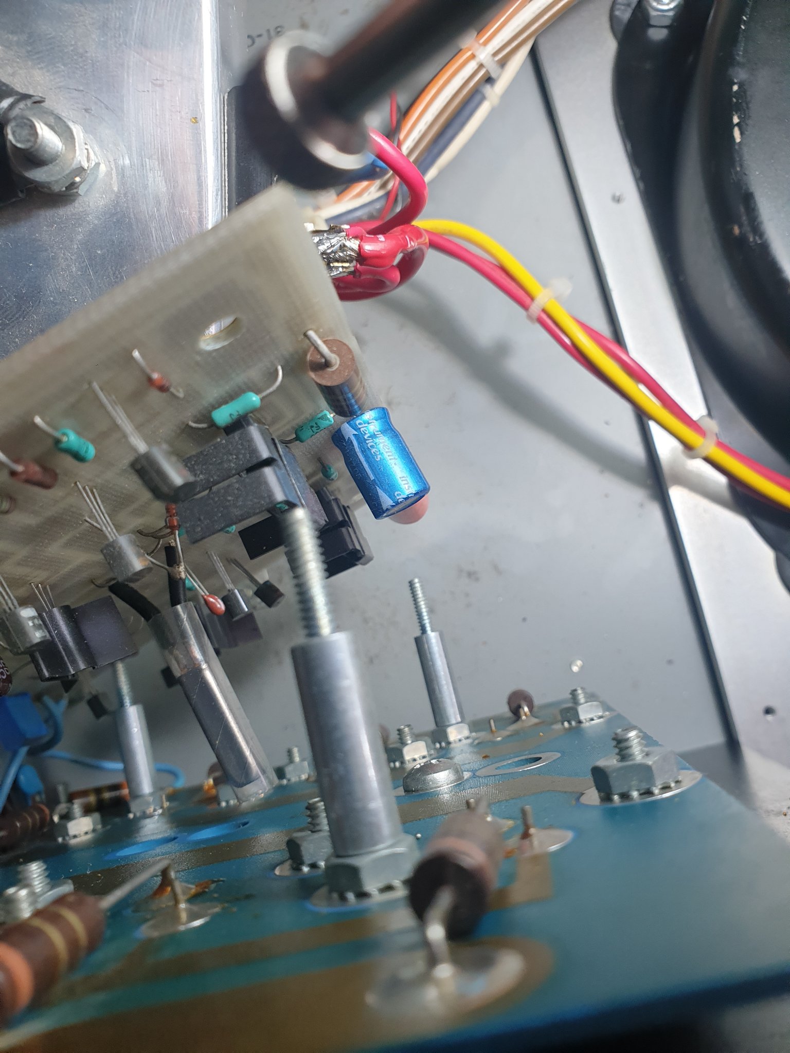

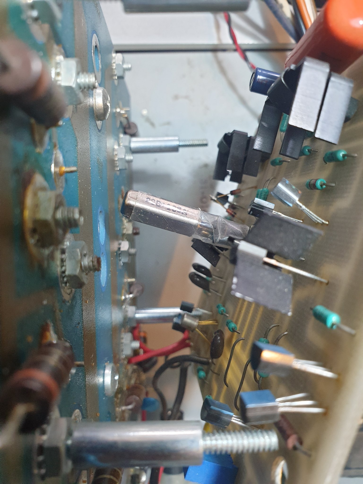

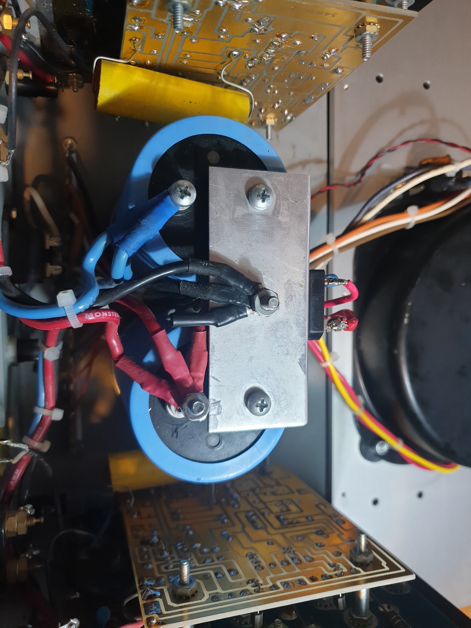

Here are a few fotos. Wondering if the big MKPs are original or some form of tuning?

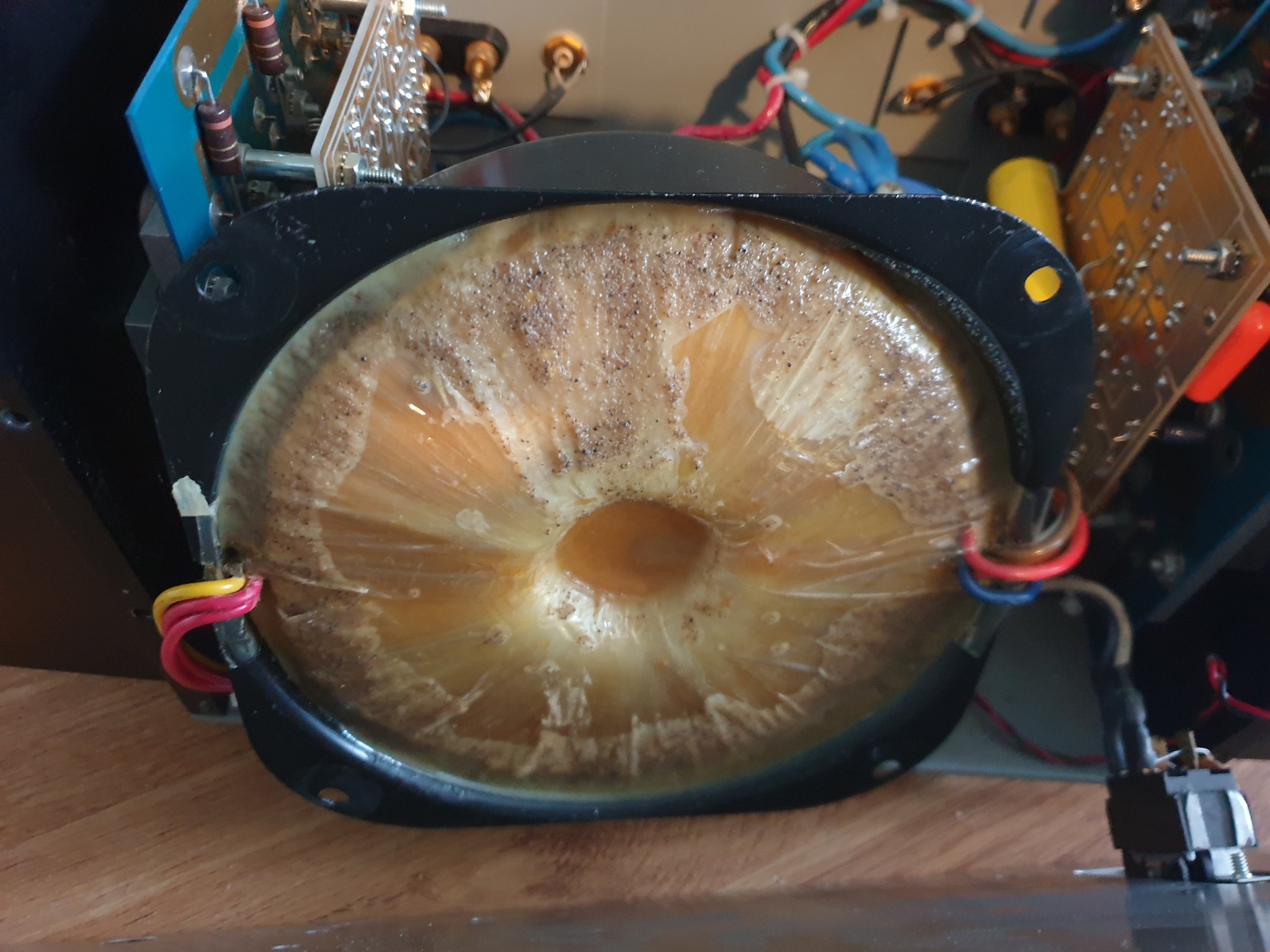

Small update from me, I ordered a 2x38v trafo from Toroidy which came a few days ago. I managed to swap it today.

Also the new trafo has a smaller diameter, so there is more space to the nearest pcb.
Replaced big blue cans with higher rated ones. Also replaced the 2 elcos and tantals iirc and bridge rectifier.
I went with replacements from cheapest to most expensive (also applies to dificulty) to try to eliminate trafu buzz.
I am now certain the trafo was defective due to the observations posted above.

Dunk the old one in varnish, keep in reserve for another project.
