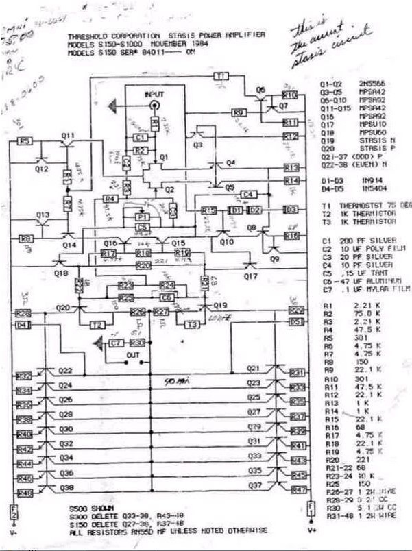

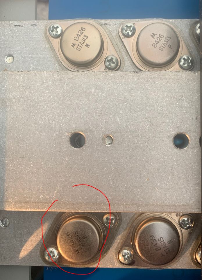

Hi all,
one of my two Threshold S/1000 Series IIs blew off. 🙁
Short circuit on the - rail, left stage. Does anyone know an address where I can get transistors ? especially the first one in the stage has short circuit,
it is a M 8426 Stasis P.
Thanks and greetings all

thanks for your help, have the last few days already much googled in the forum, but nothing found where I can order these. I do not want to rebuild it completely (then I would have the 2nd amp also). But I have now contacted vintageamprepair.net.
"first two" , I meant on positions of first two in OS , being Q19 and Q20 on schm you posted for reference
ideally , Q19 is matched with even numbers group, while Q20 is matched with odd numbers group
though, did they bother with that, only Pa can tell
hopefully he'll chime in, even from Ibiza :clown:
in any case, guy from vintageamprepair.net will advise you properly
