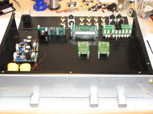

I will try the twisted thing anyway's, at some point! Here is a peek for the keen eyed eagle🙂
Steen😎

Hi Steen, I thought I recognized those green boards. 🙂
I hope it turns out well for you. 🙂 very nice work on it so far! A real beauty!
