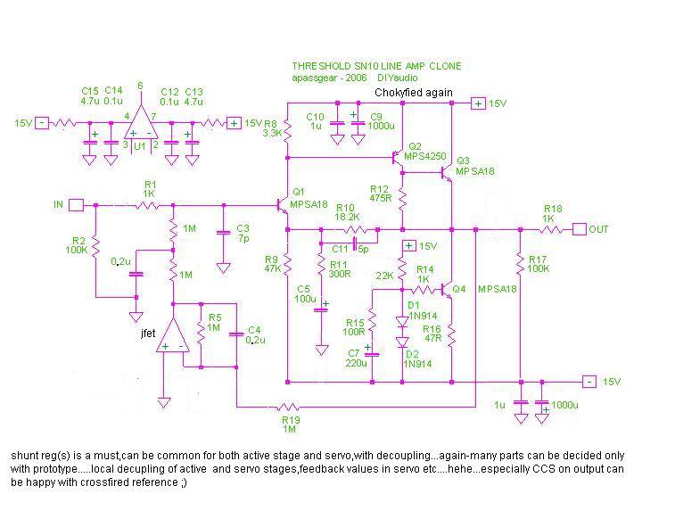

Well now that I am posting anyways, I am thinking if its possible to squeeze a little more performance out of this circuit? The best bet is for sure Apassgears, with a shunt reg supply. Have a look here: http://www.diyaudio.com/forums/showthread.php?s=&threadid=76557
You let me know😉 With a more sofisticated supply and a shorter signal path, I do see some improvement ahead🙂 I am sure this could easily be the best single-ended preamp until date😎

anyway-without refreshing my memory looking at actual NS10 schmtc,I think that servo can be pretty harmless,if executed properly..........not butchered, but executed in meaning of making it 😉
anyway- for nice servo , dedicated supply is important as much is overall servo circ important.....
..............even if I think that +- powered NS10 can be made without servo and without caps..........

On the servo issue I guess it’s used to have a stable bias for both stages and avoid a voltage divider on Q1 base. (less PSU noise?)
After building many preamps during my DIY’ef years I have come to be more comfortable using an output cap on preamps and sans input cap on amps (when possible)…keeps me sleeping well at nights. So my suggestion Steen is to keep that cap there.

I actually worked on a very similar design as a senior project in school many years ago for an RF (1 MHz) amplifier. Find this discussion interesting.
It would be very simple, in a new build of this design, to run on split supplies and eliminate the output cap.
Run +/- 12 to retain the bias points, or higher with a rebias.
Ground in the old design becomes -12 V, however,
+ input to OP amp moves to ground.
OP amp should be modern low offset type, this is important.
Caps off 301 ohm stay at ground.
OP amp can now run off this split supply.
Would want to check for on/off transient noise since they're no longer blocked by the output cap.
Interesting, simple design.

just saw this..........R10 must be 1K82,not 10x bigger
or R10 =18K2....R11=3K....C5=10uF
dunno for noise in that case.......
