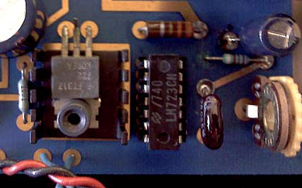

Need help with missing chip
No Service manual ever existed that I know of.
If any one with an NS 10 could look under the hood for me I would be grateful.
I need to know about a 14 pin DIP near the right front of main board. This early unit has a one piece gain circuit PCB. The 14 pin socket is next to a FT 317 w/ heat sink. What is the chip and the orientation? Any help mucho appreciated.
Sorry that I don't have the info.
It may be that the 14 pin dip is a quad op amp used for the offset. You
can find that out by examining the connections of the pins or by seeing
whether the op amp is present on the individual gain modules.

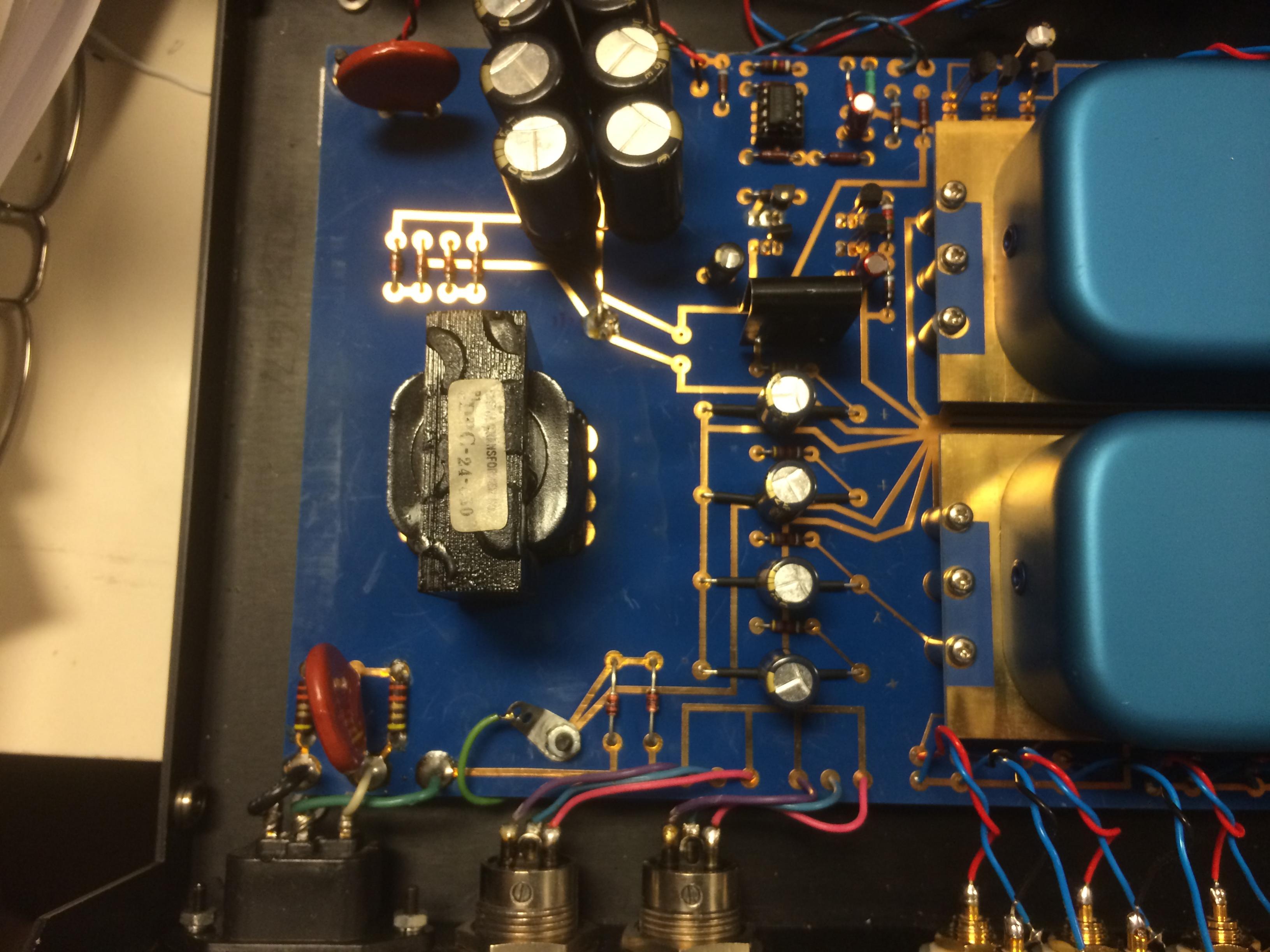

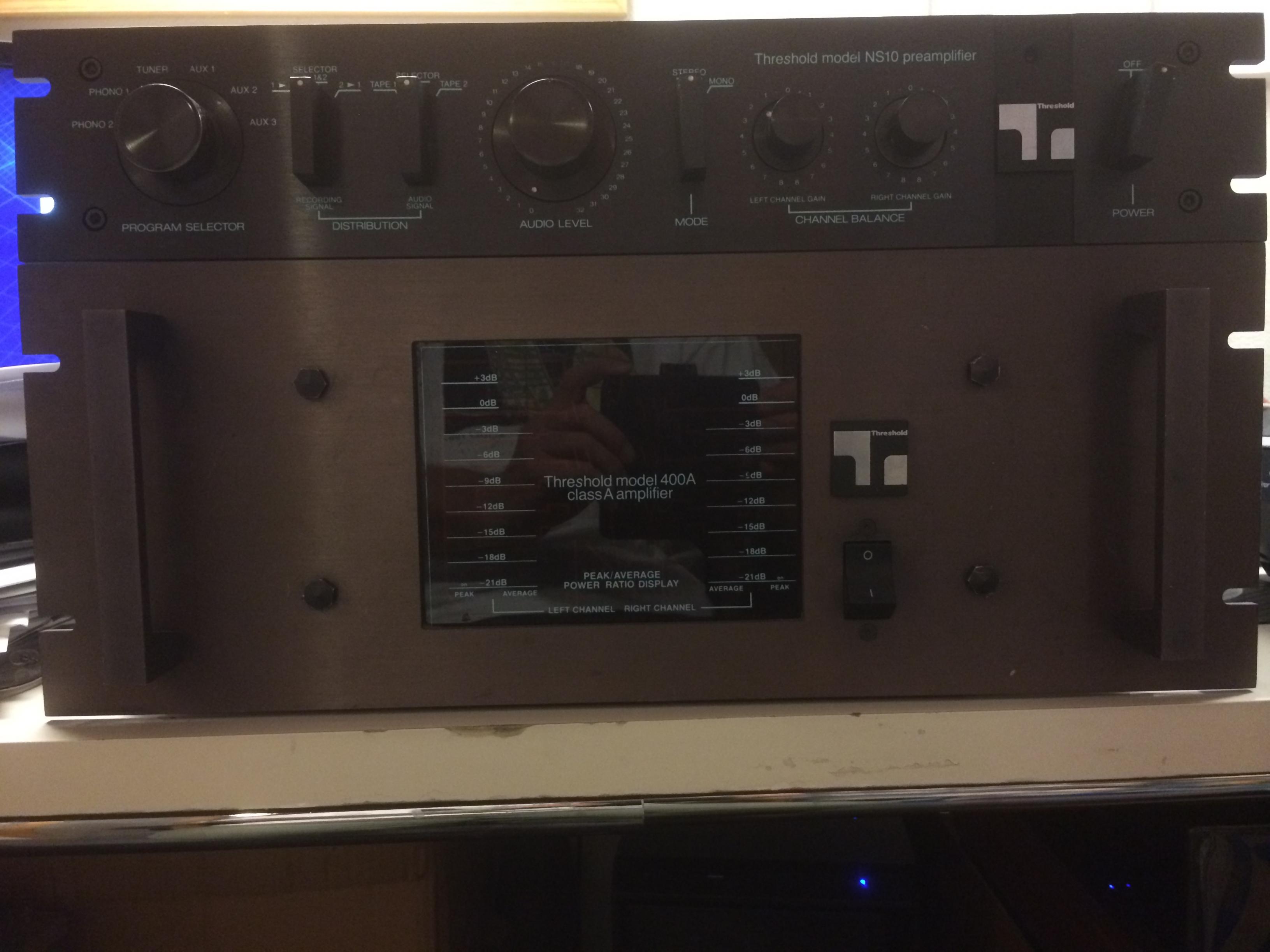

Even more so inside the 400A. I am sitting here looking into it like some doctor of medicine wondering shall I just close it again? Well, I am going to close it. But I will do some surgery on it, maybe replace some vital parts. I'll find a 400A thread and post the pictures maybe.
So the picture of the damaged inside is here: http://www.diyaudio.com/forums/pass-labs/95067-repair-question-re-threshold-400a-47.html#post4034628
- Threshold NS10 Lineamp PCB
