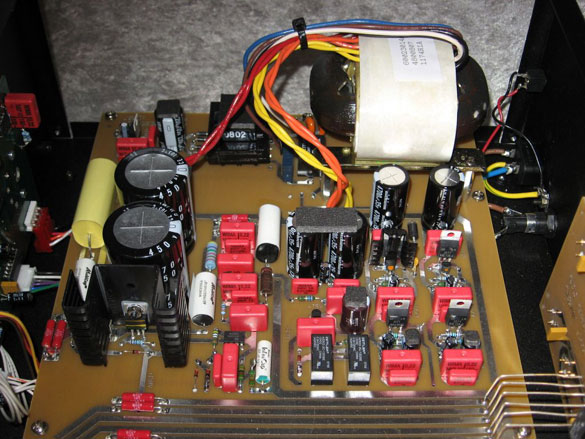

Edit. Come to think of it, Audio Research used something similar to the R-core trafo you linked to. Here is a pic of their LS17 preamp
Re: Re: Resistors for toolereg
steenoe said:
What resistor values are the problem? You can probably just use the nearest value available.
Hi Steen. This is a previous BOM I´m trying to estimate for Toolereg so I may just be a little hurry. It´s exactlly those R4/R104 - 8.7K that set the voltage for NS10. Unless the PCB provides holes or tracks for a parallel array, it´s not a big deal 🙂
