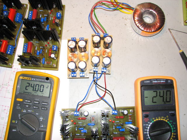

Me too. Incidentally I am adjusting another pair of Tooleregs, right now. The inductors are in the middle of the raw supplies. It is quite easy to wind a few of those. Mine are 25uH.
apassgear said:I have been asked several times for suitable inductors for the CLC filter on the PSU
I’m using the hand wound simple air cores as explained on the Hints file on post 219

That’s a nice pic Steen, lots of Tooleregs there and shows those neat raw supplies with home made inductors… this is DIYaudio at its best.
Yes, I was also about to ask what size of lytics were you using there.
BTW, I see you replaced R4 with trimpots... 😎 easy to set voltage now.
The 'lytic's are 2200uF 50V, but only because i had some in the drawer. 1500uF will be just fine, maybe even 1000uF.
I have populated 5 boards so far, and they all works out perfectly.
My plan is to power everything I can with the Toolereg. My CD-player will have something like 5 seperate reg's of the compact version. I might etch those myself, or wait for the GB. Dunno yet, depends on the time horizon for the GB.
I will post a better pic of the inductors, a little later.
Yes indeed, Tony. Trimpots are mucho easier. I read recently that Papa trust them. Thats good enough for me😉

Hi Dennis, ( I know I am not Apass, but I squeeze in anyway's)
The purpose of the inductor is to knock down high frequency noise, to counter the Toolereg's dropping PSRR at high freq. A CRC wont be as good at that. No harm using a CRC, but it wont help as much as the CLC.
It's rather theoretical, and one can doubt if it is detectable when music is playing😉
This is DIY, so why not use it (or not, if that is what anyone feels like) In any case the result with the L included will probably only be marginals better than the one without them, so feel free to substitue with a resistor
