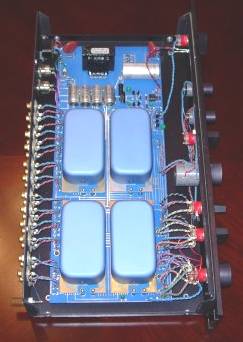

Very nice production unit just sold on Audiogon for $750.00 USD,prices keep climbing on pristine Threshold NS 10.

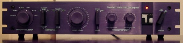

A big thank you to you, for posting on the NS10, by others who see magic in Threshold gear.

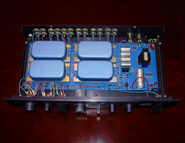

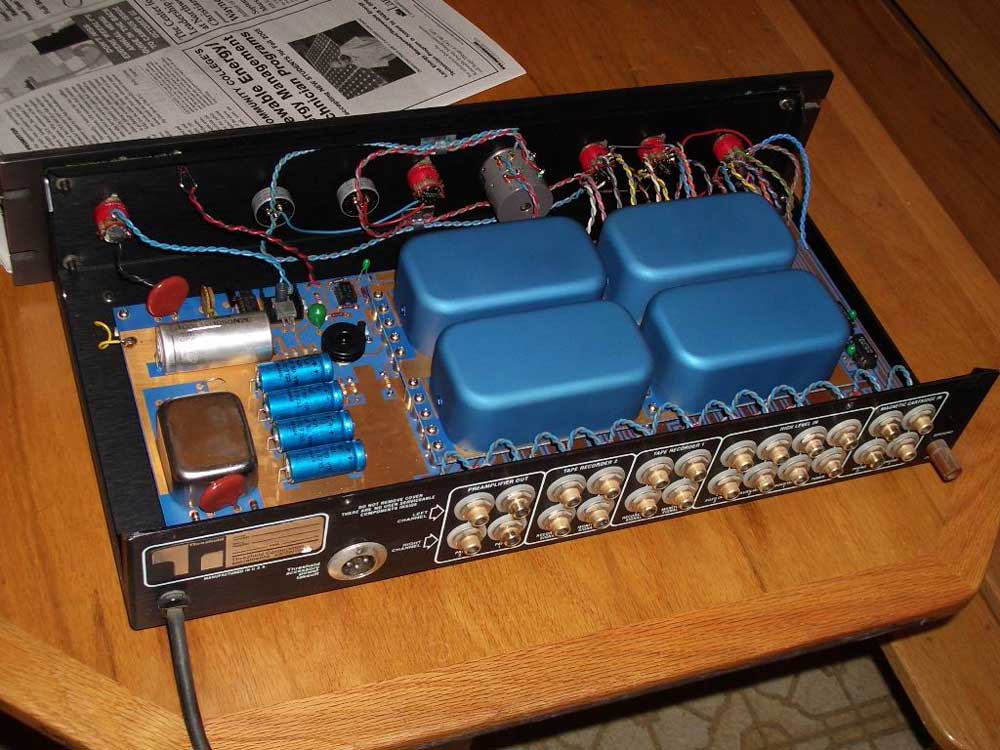

Viewing pictures of preamplifiers with 8 inputs is already a treat, let alone something as rare as the NS10, seeing a pre-production model is unique.
Even though i find it more intrigueing to find out what is underneith a cover, understand and duplicate it, i truly envy you.
Forgering a Renoir is not the same as owning one.
Yeoldstereo
Thanks for kind words. Fact is that I´m not familiar with this preamp and can not resist to ask what are those huge four blocks?
