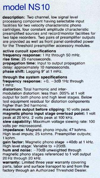

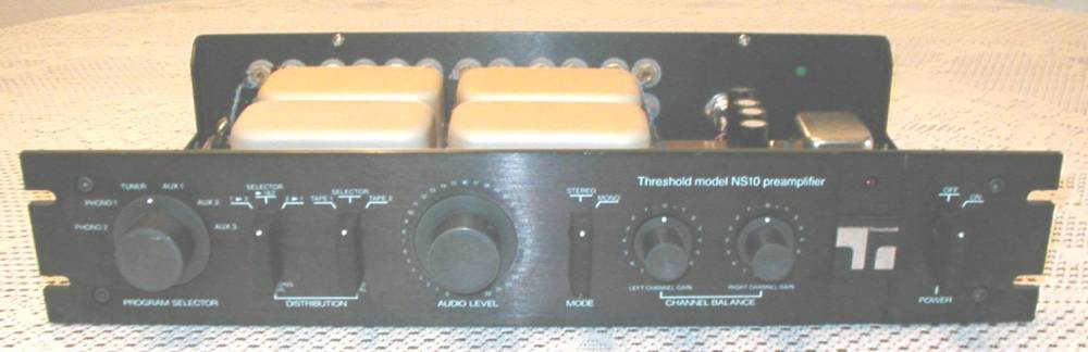

By the photo I see that it was indeed one of the originals, as the
later units had blue anodizing on the circuit shields and did not
also have a mu-metal case on the transformer.
The published specs:
