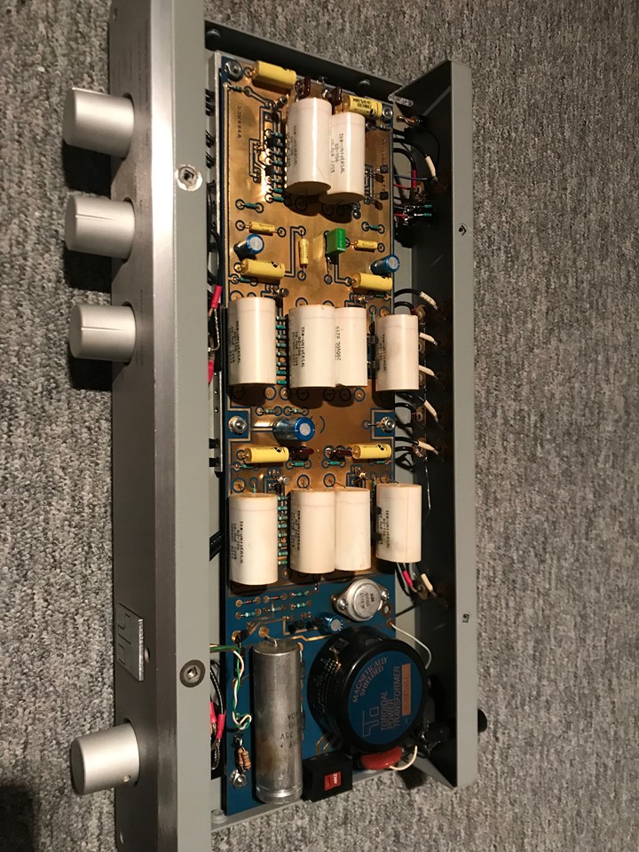

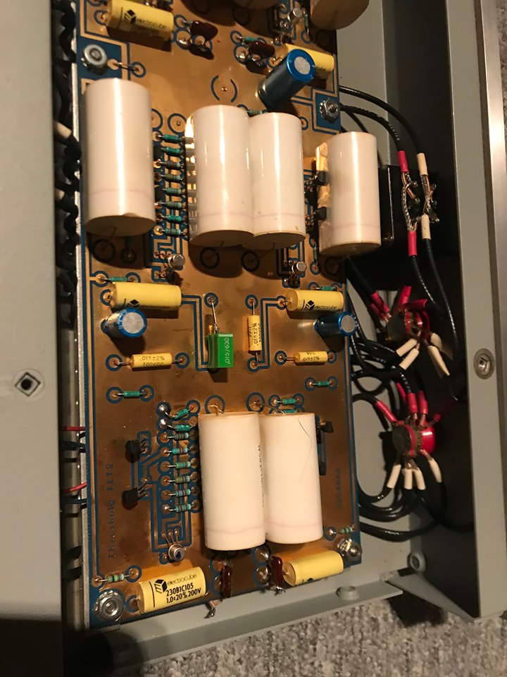

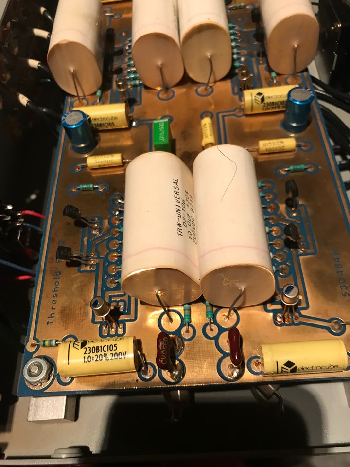

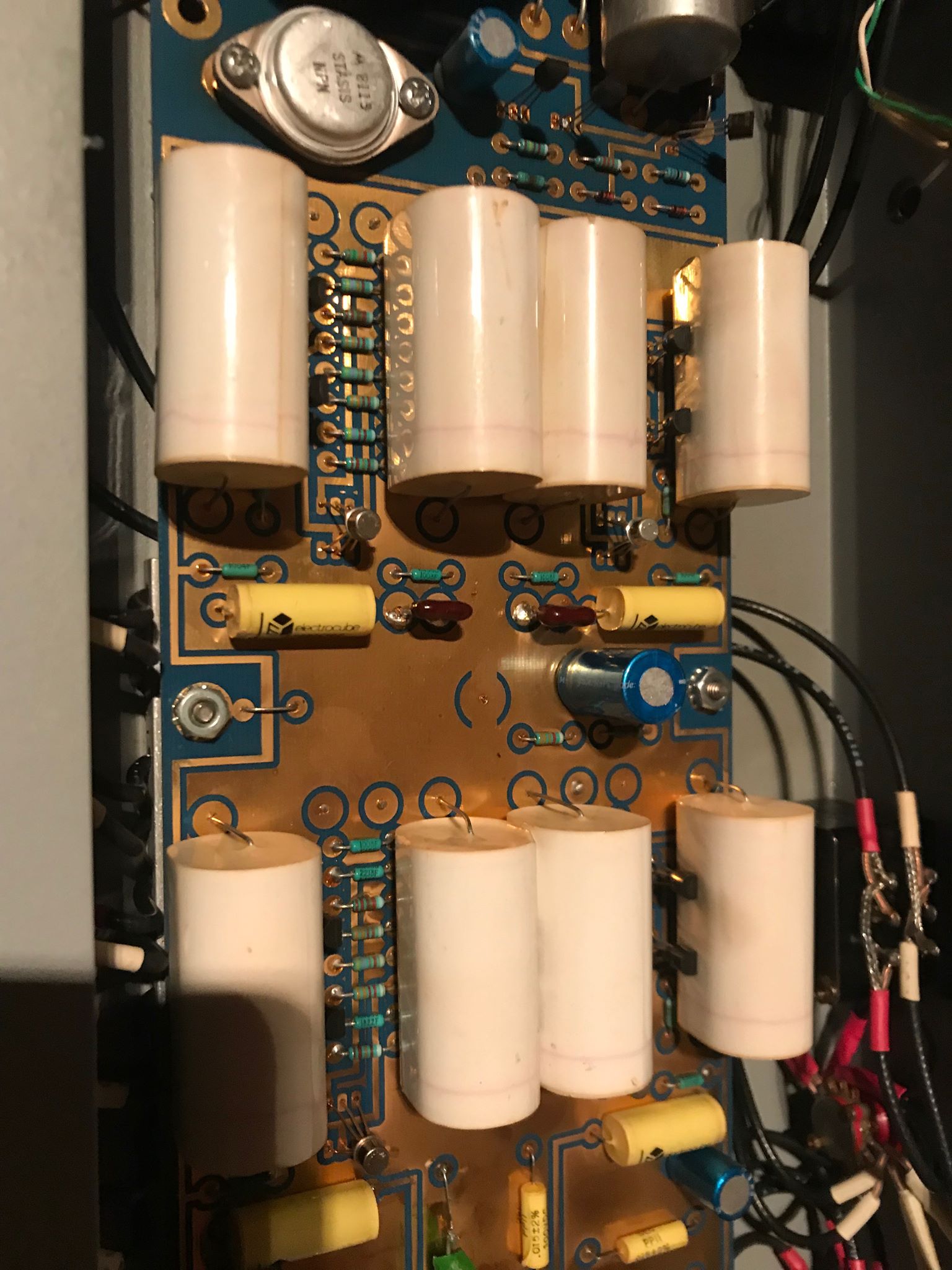

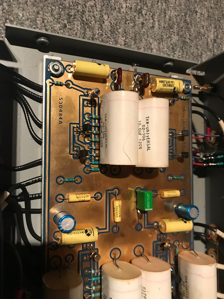

analog_sa said:Huh. My PCB is quite different - also a series II.
That is different! My S/N is 185060365. Is mine newer or older than yours?
Bill
Mine is clearly older - 184030014. Phono connections use much longer internal wires instead of pcb tracks. Funny thing is these wires and the outputs are silver in teflon and all other inputs use standard pvc copper. Mr Pass didn't like cd sound 20 years ago 🙂
Vol pot is Noble and may well be 25k - already put the lid back on.

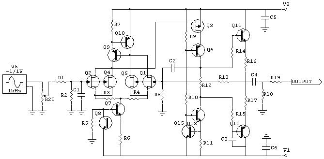

I've been doing some simulation on a similar circuit using 2SJ74 and ZVP3306, with current mirror load and tail current generator slaved to a master current source/reference. The big difference is that I cascoded the input differential stage to get rid of the Miller capacitance, as I'm looking at using the circuit in an RIAA stage.
Due to the cascode and the increased gm of the new devices over the originals, I find the new circuit to be pretty slippery and requiring lag compensation on the output stage to prevent HF rail to rail oscillation. The P-channel lateral output MOSFET used in the original circuit undoubtedly had a much lower transconductance than the newer vertical relacement devices. Both the 2SJ74 and 2SK389 have at least twice the transconductance of the 2N5566. A pair of matched PN4393s would probably be a closer replacement for the 2N5566.
I'm going to continue messing around with the simulation until I get some results that suit me. One thing that I found out right away is that it is necessary to very closely match the current source load current to the expected device current in the differential stage in order to minimize distortion.

I was looking at the picture in post 16 and wondered if anyone could tell me what the grey box next to the transformer was ( I think it says Midland cross on it ). Is it a servo or a reed switch?

analog_sa said:The diode-looking thingies are, of course CCS; couldn't find a more convincing-looking symbol in Protel. J505 - 1mA, J507 - 1.8mA, J511 - 4.7mA.
There is a muting relay in parallel to the output. It has a 10s delay on power-on and a connection to the power switch to instantly mute at power-off.
