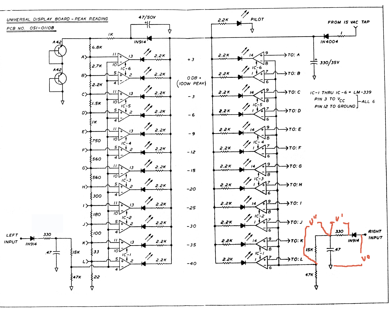

So I have a near perfect CAS2. I have changed all the caps out, including the main PS caps, and it sounds brilliant and has worked without a hitch for a couple of years. Unfortunately, however, just recently the right channel of the level meter has stopped working properly with all the LEDs lit up. The left channel, and the amplifier itself, are still working properly.
Would anyone here have any tips as to what part has gone bad? Is it an integrated chip of some kind or a discrete part? If the former, might it or some equivalent still be made?
It's unlikely to be one of the LM339's if the left channel display is working - best bet is to compare your healthy left signal channel input network with the right. The .47uF zit red tantalums would be the first caps to go - 🙂 ... once you take the face-plate off 🙁

Check the voltage across those A42's. They are being used as zener
references, and might not be developing the voltage you want.
Nevermind, that would affect both channels.
One of the 339's on that side might be bad, injecting current into
the node the - inputs of each 339 have in common. Try shorting that
node to ground.

Thanks Mal and Nelson for the help! I'll start with your suggestions and see if I can't get the amp back into proper fit.
