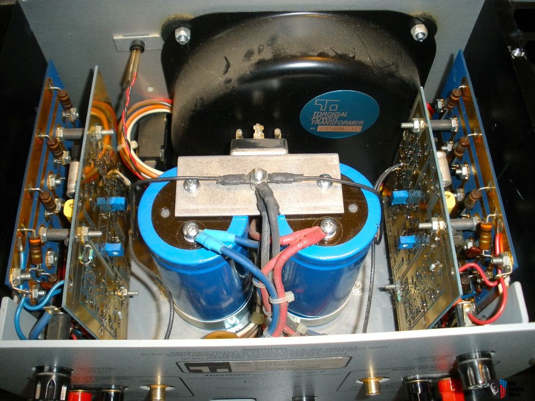

Hello dear friends, I came to seek help from you.
I have a Threshould S150 MK1. I would like to know what is the procedure to adjust the bias. I open it and inside in see no potentiometer or variable resistor for adjustment. Where to measure the voltage?

Hello.
Thanks for the pdf file.

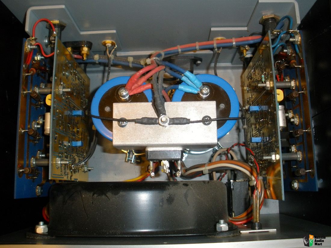

Here are the pictures of the interior. I'm unable to find the points for calibration indicated in the manual.
My amp sounds great to me but I think it is under biased as it is much colder than indicated in the manual. Temperature should be about 42 to 49 ºC but it is not hotter than 30 ºC.

I see blue trimpots
you think you're capable of doing biasing procedure , if you aren't able to recognize trimpots ?

I was already able to find the 1ohm resistor in which to measure the voltage and to adjust it with the blue pot. However it is very difficult to use the method described in the pdf file by measuring the initial voltage. I would rather use the stable voltage. At moment I've settled around 50 mV stable and the aluminum heat dissipators are already warm. I should say around 37ºC. Is this a goo setting, or is it still low?
you have all necessary information about temperature in posted pdf file
however , you can always set it colder , if you choose
