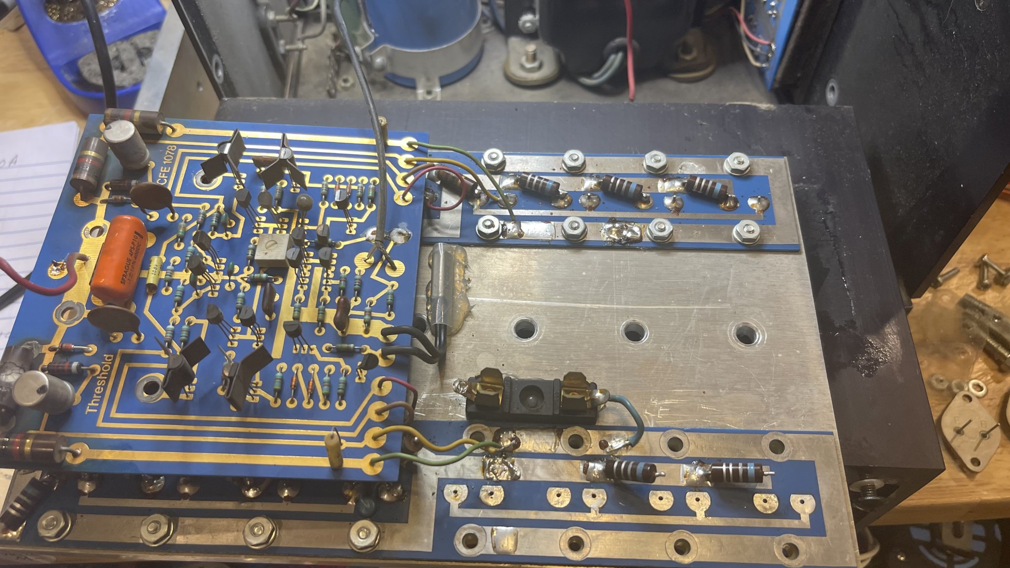

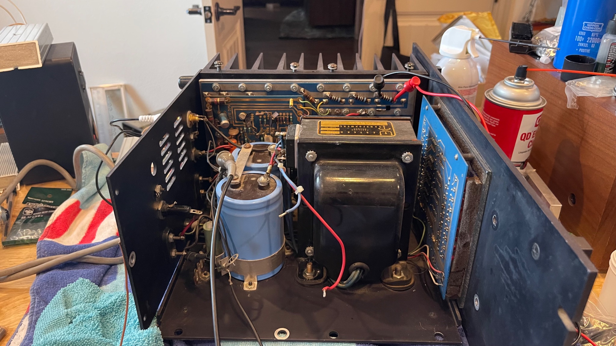

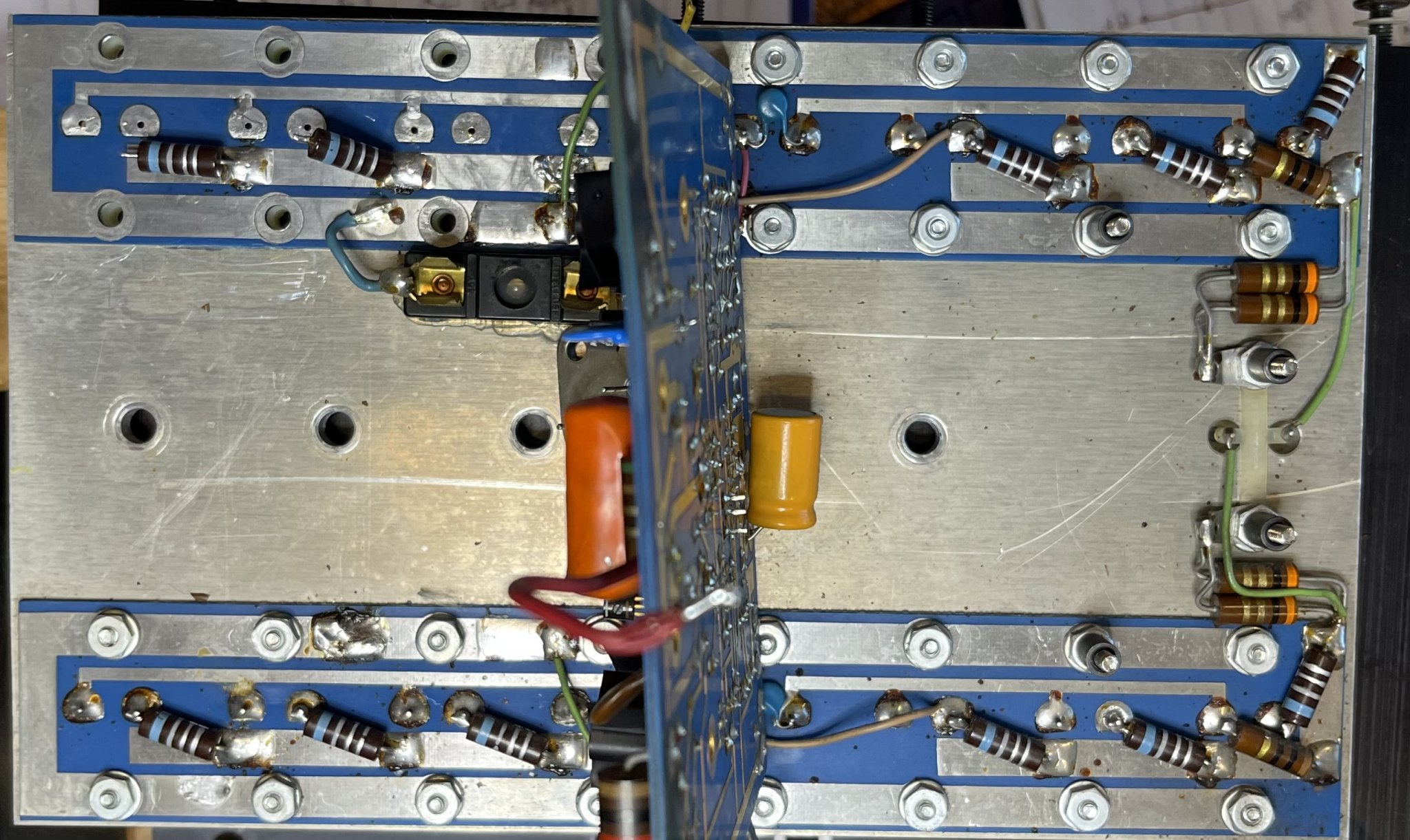

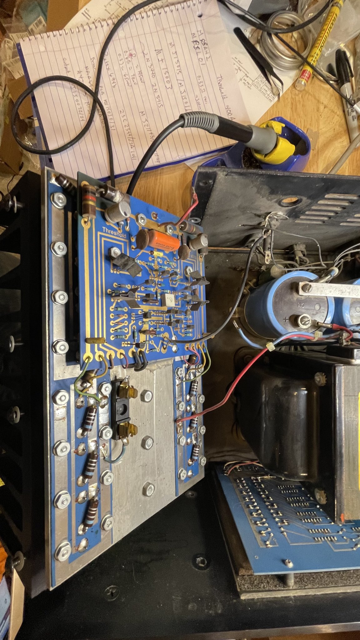

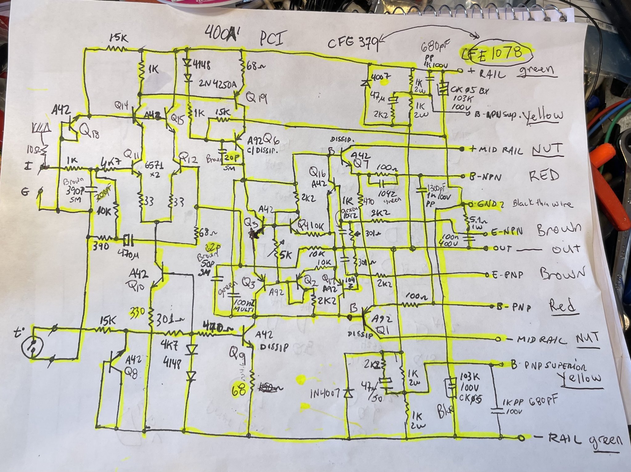

When i first opened for visual, no supply fuse., A toasted resistor divider which goes to lower 4 A6 pnp devices. Did a quick continuity check looking for CE shorts on A6s. Found 3 with BC shorts.
As show in pic, I proceeded to pull all 4 outputs. 3 were shorted as measured in circuit, the single survivor was limping along with ~ 2 mA collector leakage.Of Collector. All four will be replaced. Route cause is unknown as of now.
Pic of backside. Rated E for everyone.

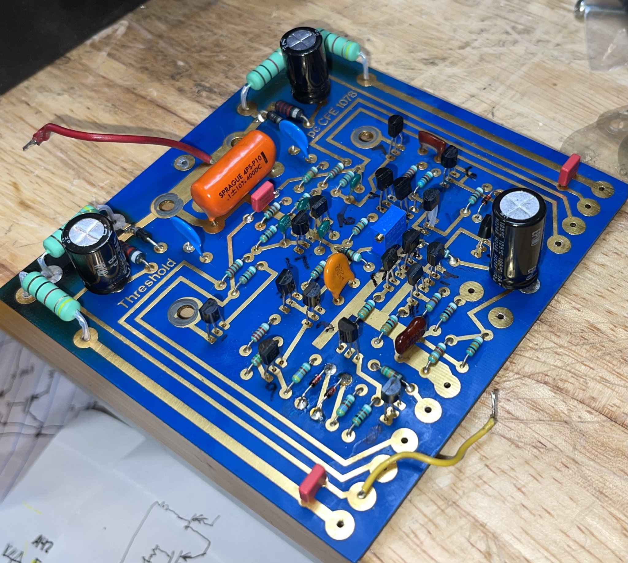

Turned my attention to amp board. At first glance, I noticed the roached resistors. Both appear to be 1k ohm. 1-2W wirewound. I feel they are too closed to the board for my liking. I Will be replacing these with a higher wattage wire wound resistor and lifted further from board for better airflow. There are absolutely no markings on pcb. 🙄 A total of 18 transistors

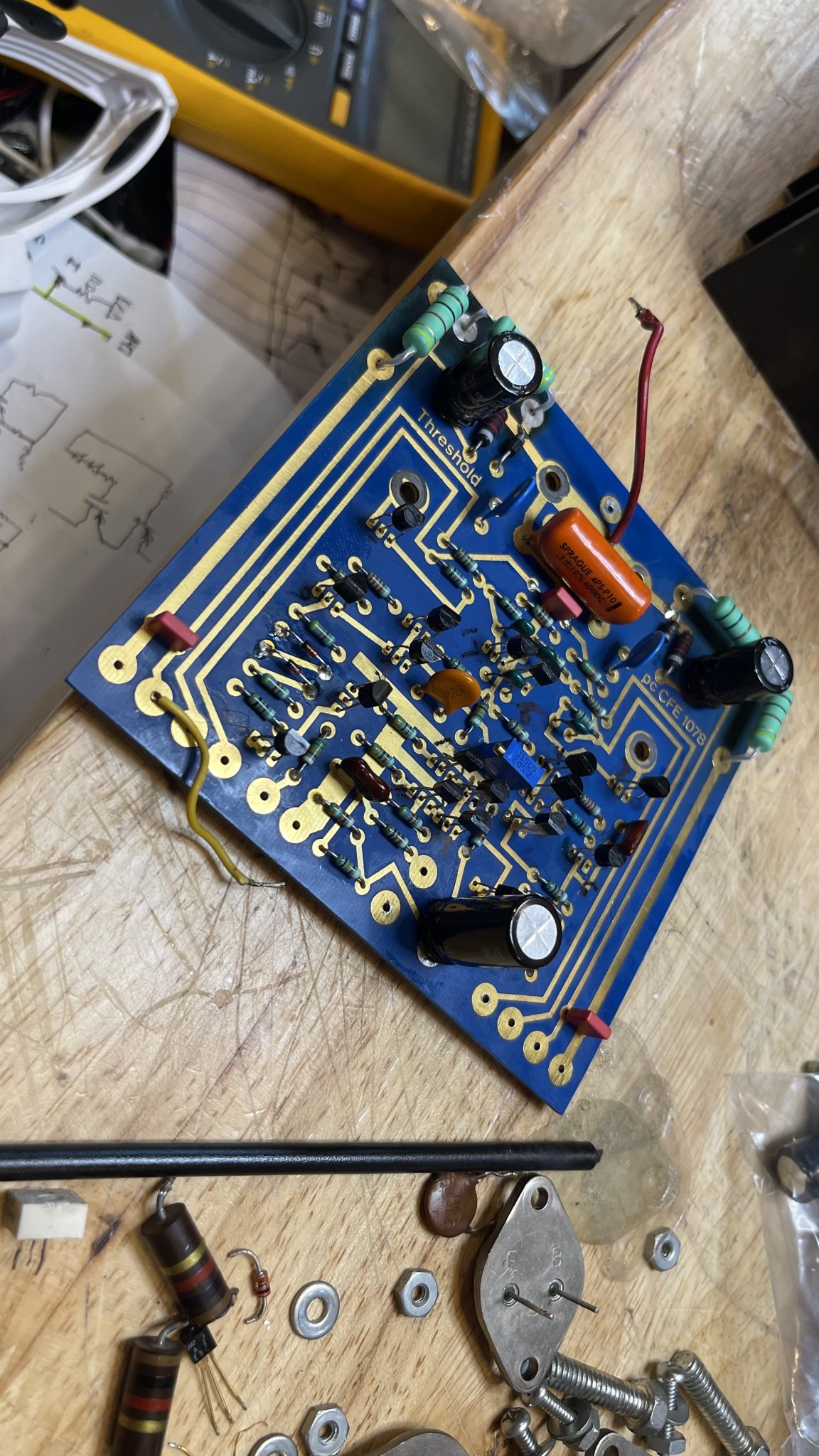

10 x MPSA42’s——>MSP42’s
5 x MPSA92’s———>MSP92’s
2 x MPS6571’s—>ZTX694’s(1100 hfe)
1 x 2N4250—->KSC733C (ECB)
Note all are EBC orientation. I had to bend pins on 733C. Mind orientation.
Use schematic.
Diodes 1N4148x4 and 1N4007 x2
Dozen or so caps replaced. Go through all passives and verify values.
There're a few other pieces of silicon......... consisting of 6 diodes.
3 electrolytics and some film and tant capacitors.
5k bias trim pot. No trim for offset other than front end cascode diff pair and base mirror.
In this version CFE1078 a pair of moto 42/92’s is used as pre driver. Not as beefy as i would have expected.
This unit looks untouched so i suspect I'm looking at original components. Assuming this unit was used hard and has seen Venus type temperatures ….very impressed that it made it to year 2023.
The MPS6571 cascode devices and the 2n4250 concern me. I plan on testing each device. I suspect these have some high beta properties which may be difficult to match with modern replacements (IF NEEDED).
I’ll need to inspect the supporting circuits to see what else is damaged. I did notice the 47uF/50V is now open.

I assume you've seen this version? Would one leave the pre drive as the A42/A92? I was considering KSC3503 KSA1381 but I suspect their gain may be too low.
I've mapped out a new schematic for this version. Couldn't seem to find one. It's a mash up of a couple of the schematic versions of 400A floating around on DIYAUDIO.

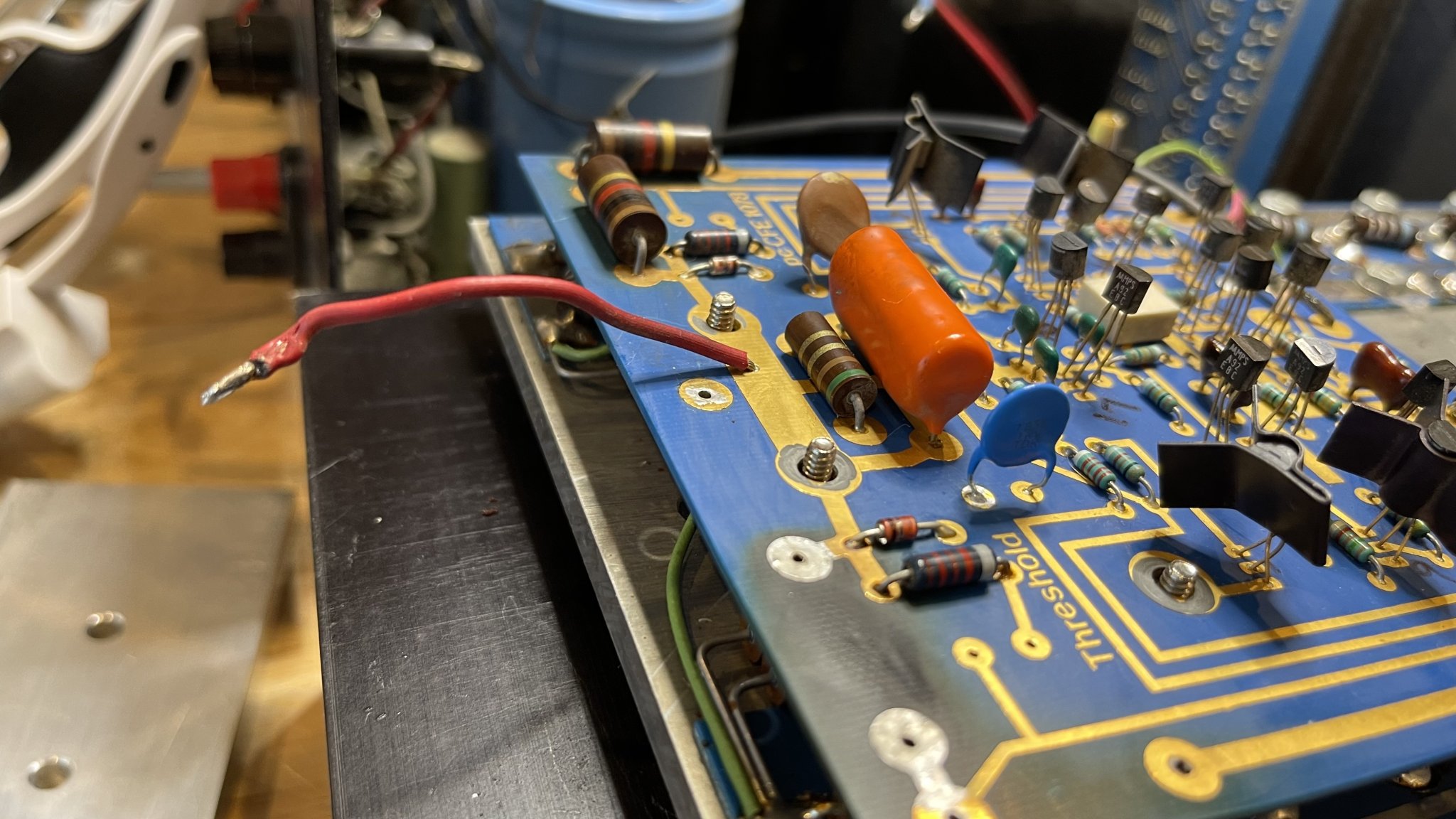

output stage for this version. Other than the emitter resistor values and a few coupling caps , same. Love the collector nut attachments for the bipolars. Just don’t have enough of those nut to board attachments nowadays.
Sorry looking red dangling output connection
That was once attached to RCA jack.
Don't trust the DCA when measuring bigger transistors. They may seem to work measured with 5 mA, but at higher voltage and currents they may misbehave.
Check all outputs, and test all emitter resistors carefully. I have repaired two 4000, one -78 and one -79, totally different VAS and driver circuits.
Everything worked great except those 1k resistors, emitter resistors, cascodes and output transistors, but I did a recap anyway.

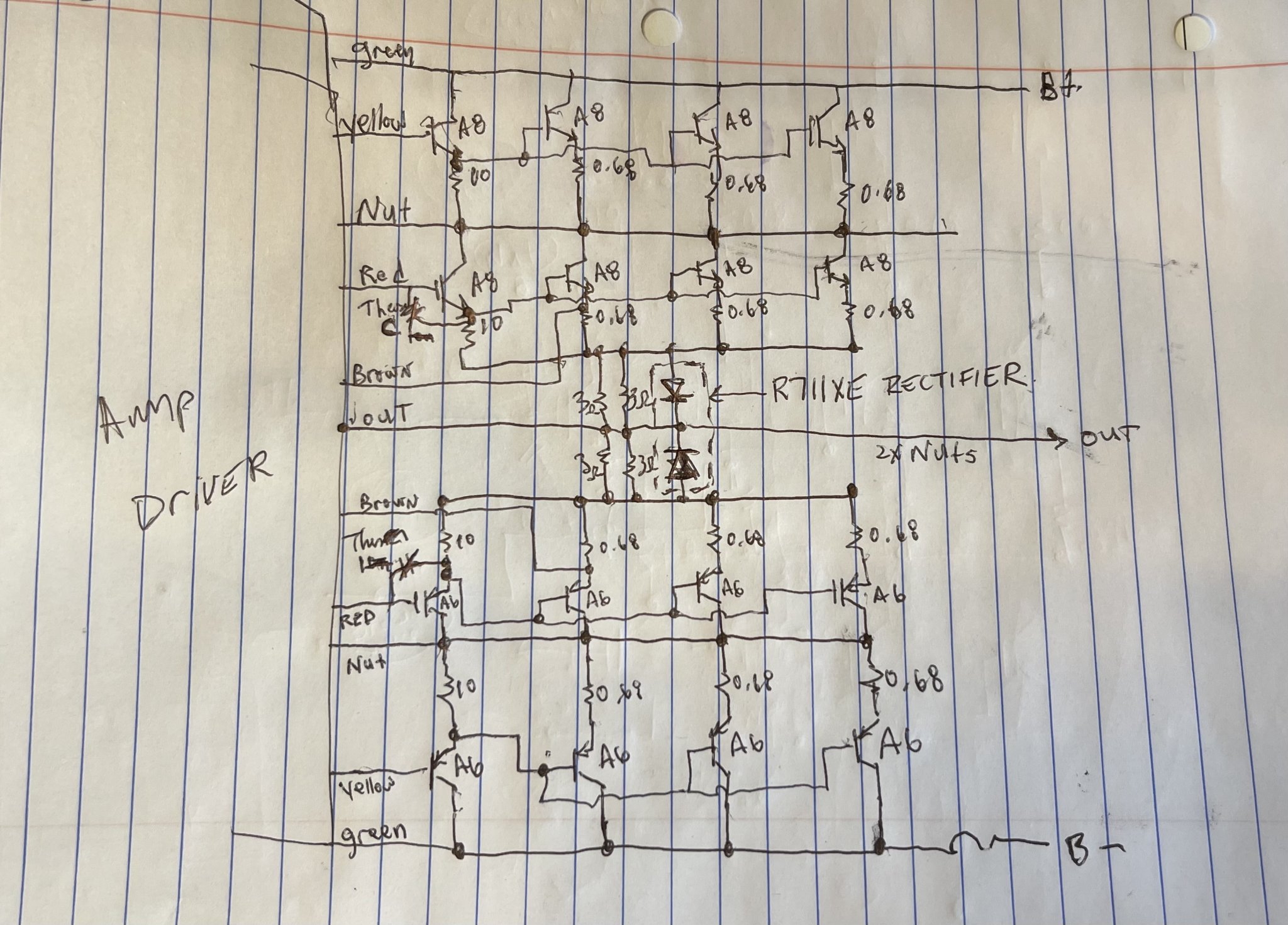

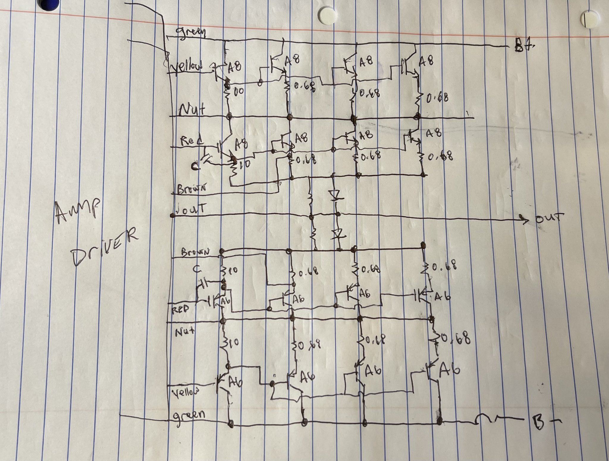

Updated output section for CFE1078 amp board. Rectifier R711XE in TO-3 package included. There is a TO-247 package with shared cathode that works as replacement if needed. The one in this unit is fine.
A DIY’er had a schematic for a version cfg379 of 400A model. Other than a few minor drawing errors it matches for the the cfe1078 board. There are some passive components that differed as well but very minor. It uses the same silicon
MPSA42/92 complimentary pair to stand off higher voltages. 2N4250, MPS6571. Along with 1N4007 and 1N914/1N4148.
(18 transistors total. 6 diodes)
You can label the transistors on the board it will help follow the location of the circuit.

Post rebuild board. All transistors on amp board are EBC. So if you do use alternates stay alert . I replaced all diodes 1N914/1n4148 and 1n4004/UF4005.
The diff pair MPS6571 were 920/420 hfe’s not well match over time. Other hfe’s varied from 10-170 . Pre drive stage had collector leakage. I replaced accordingly.
Bias 5k pot was replaced with Bourns pot . Several other resistors were replace as well

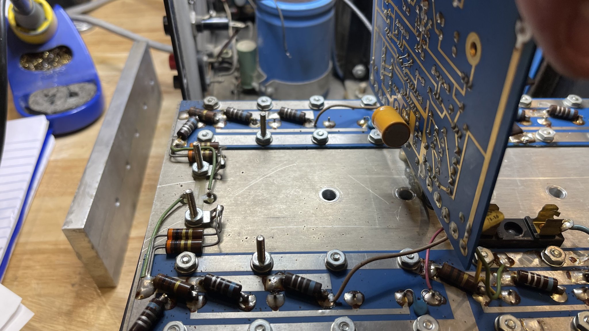

Next step is to rebuild output/heat sink plate. Emitter resistors will also be inspected
All three Ecaps replaced 2x 47uf and 1x 470uf
A few additional caps were replaced accordingly.

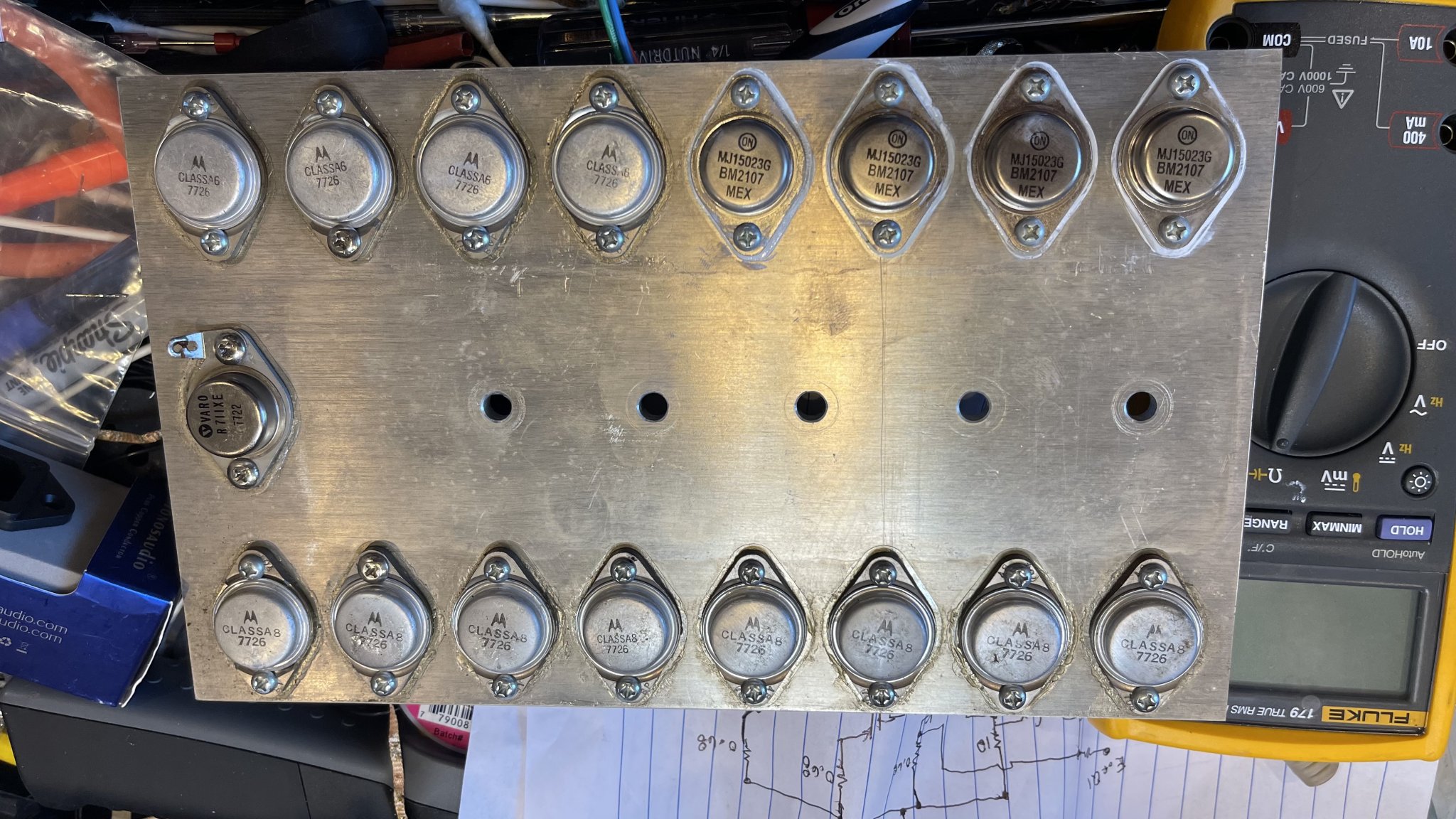

Next up are the outputs. The quad upper right bipolars in pic below were shorted and now replaced with tranny’s , new micas and lube.
Going down the line the betas have drifted enough that i will be refreshing every last one. Beta ranges 20-180 for pnp’s and
40-130 npn’s. None of npn’s were shorted and i could of lived with new micas and lube. But i have opted not to live on the wild side.
Improved pwr disp , current and voltage ratings. Check.
More to come.
