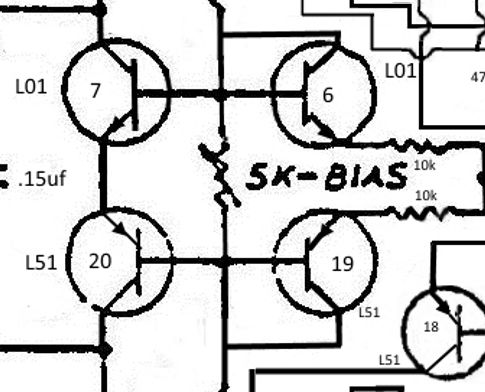

Bias transistor matching
I have gotten tired of looking at this sitting in pieces so I am trying to get it back together. I have read that these transistors need to be matched. I would think the L51s would need to match each other and the L01 would need to match each other. Do the L51 need to need to match the L01? How close should they match?

I wouldn't loose my sleep too much over it
once when in temp. equilibrium , I can't see much of importance in matching

So I have the first channel back together and hooked up to the power supply run through a 150 watt DBT. +61.3/-61.9 on the rails. Draws .4 amps at 115 volt ac and .73 volts on the output. It does produce sound. The transistor I have marked 4 gets hot pretty fast. There is 9.4v at emitter, 10v at base and 29.5 at collector. Does these sound right? Should I go full power?

730mV at output - that's DC offset?
if yes , that's too high
say that 100mV is highest you can allow, in temp. equilibrium
replace all old electrolytics, same as these nasty tantals - use modern electrolytics instead
regarding transistor you marked as 4 - which one is it on schmtc (it's too small in resolution , so I can't de-cypher)?
