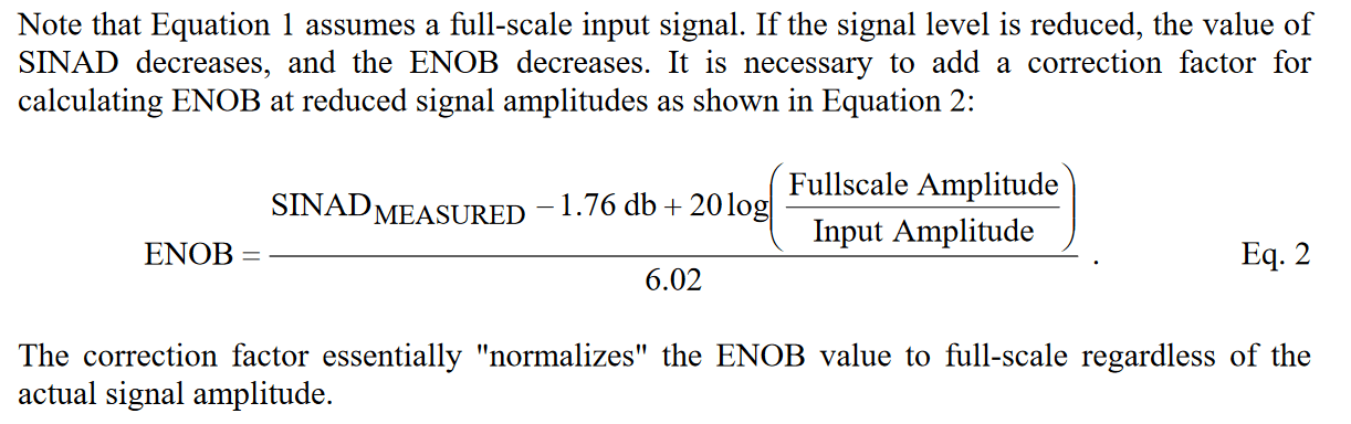

Is this formula for calculating the ENOB of a DAC correct?ENOB is calculated at 0 dBFs.

This calculator does not take into account the reduction in amplitude of the DAC output signal when measuring SINAD, which makes it difficult to find ENOB that is tied to the entire measurement scale.You can use calculator:
Here they write like this.
https://www.analog.com/media/en/training-seminars/tutorials/MT-003.pdf

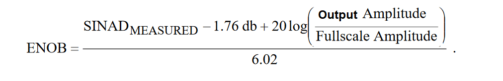

I thought carefully and realized that this formula is not correct, since when the output signal decreases, the measured SINAD will decrease and at the same time ENOB itself should not decrease. According to the formula that I gave earlier, such a condition cannot be met, since the correction term will be negative when the signal becomes less than full scale. In that formula, you need to swap the output voltage with full scale.You formula is also correct.
I'm not sure I'm understanding you here as you seem to be agreeing with me--did you mean increase rather than decrease?This is for analog signal, but for the D/A conversion, THD decreased with digital attenuation because less bits are working.

What I mean is that higher digital attenuation will result in higher THD because there are fewer bits involved in the conversion.I'm not sure I'm understanding you here as you seem to be agreeing with me--did you mean increase rather than decrease?

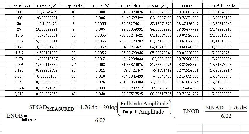

Exactly, an increase in harmonics with an increase in the signal to 0dB is not always associated with a decrease in DAC bit depth. However, for some reason, you interpret such an event as a reduction in DAC bit depth and then proceed to reduce the number of bits in ENOB to decrease volume. In my view, doing so is hasty; this arithmetic does not accurately reflect the real situation.Many audio ADC/DAC have THD rising near 0dBFs, but this is not because of "bits'".
I conducted measurements of THD+N at different levels of digital volume in the DAC and calculated ENOB using two formulas, one without normalization and one with normalization.
As evident from the measurement results and calculations, the ENOB full scale remains relatively stable when reducing the volume. Looking at the ENOB full scale, you can observe that the bit depth decreases due to the characteristics of the DAC power stage, not due to a reduction in bit depth during volume adjustment. This is something you also mentioned, but you seem reluctant to consider it in your reasoning. When discussing the impact of digital volume on ENOB, simply discarding bits from ENOB is futile because bits are discarded at the input of the DAC. If the DAC has a 24-bit input, reducing the volume involves subtracting bits from the 24-bit stream, not from the ENOB.
The last column does not make any sense to me as it can be considered as cheating 🙂 ENOB is only defined for full-scale signal.
That is true, digital attenuation has nothing to do with ENOB of the DAC. One should only consider SINAD/THD+N.If the DAC has a 24-bit input, reducing the volume involves subtracting bits from the 24-bit stream, not from the ENOB.
Sure.The last column does not make any sense to me as it can be considered as cheating 🙂 ENOB is only defined for full-scale signal.
Alex.
The last column clearly shows that the decrease in ENOB is not due to a reduction in the bit depth of the signal. This fact illustrates that predicting a decline in ENOB by subtracting bits from ENOB when reducing the volume is meaningless.The last column does not make any sense to me as it can be considered as cheating 🙂 ENOB is only defined for full-scale signal.
Agree.That is true, digital attenuation has nothing to do with ENOB of the DAC. One should only consider SINAD/THD+N.

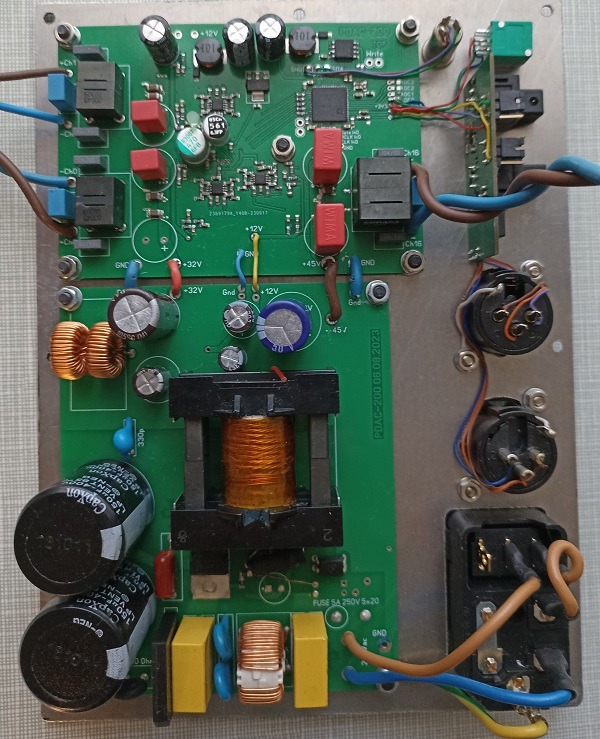

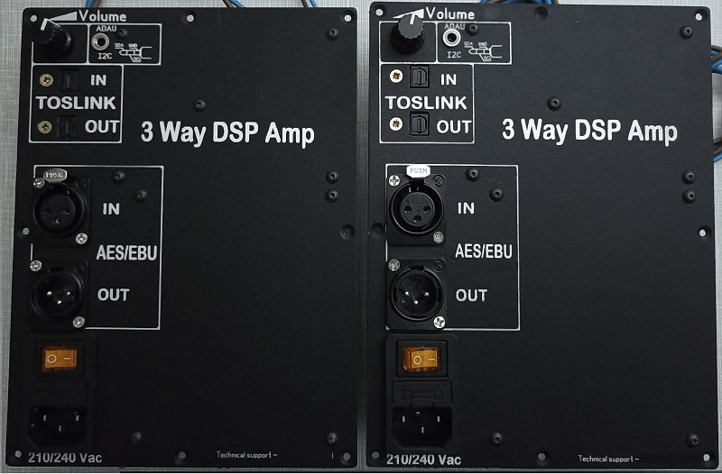

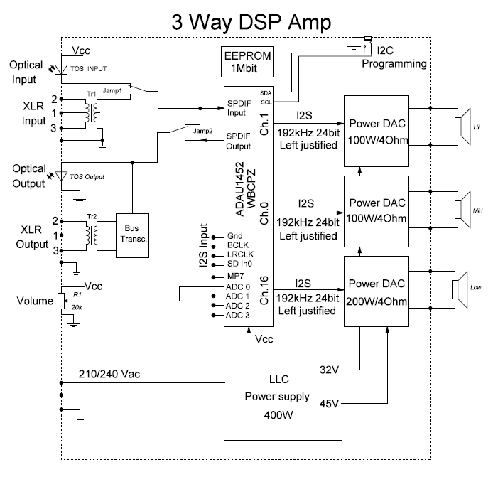

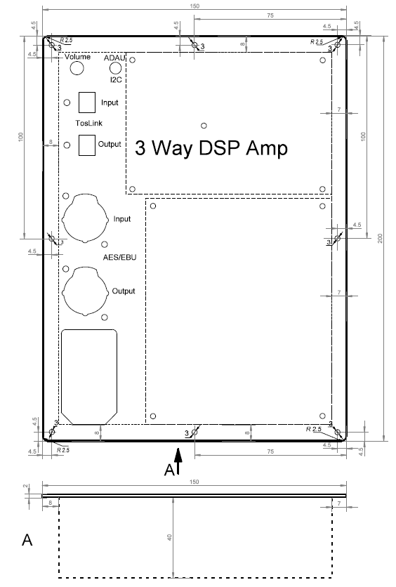

I think it's time to show the implementation of my idea in hardware.
Module dimensions in millimeters.
Power consumption of each module at idle is 14W.
The level of voltage-weighted noise at the amplifier output is no more than 300μV.
There are no clicks when turning the power on and off at the amplifier output; modules can be turned on and off in any sequence.
The module has protection against overheating and excessive current consumption; also, the absence of DC current is monitored at the amplifier output, with a protection response time of 150 milliseconds.
If anyone is interested in applying these modules to their active speakers, feel free to ask questions, and I'll respond.

- Digital Line Level
- Three-way powerful PWM DAC with DSP ADAU1452, for implementation active speakers
