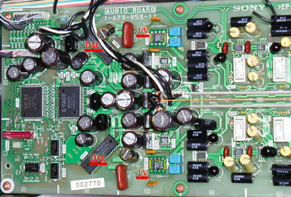

Removing I/V
Thanks eagle 1...
Removing the I/V sounds like a new level to a DIY newbie like me
Never built a circuit, but sounds like fun though.
If I am to understand Jocko's original post then, this means it is better sonically to build one of his I/V circuits on a daughter board and connect is in place of the my cascoded current loaded ad8610s as I/Vs....interesting!!!
I attach a link to the description of the I/V stage of my SACD player.
http://www.audioasylum.com/forums/hirez/messages/93363.html
any comments?

i'll take a stab:
1. improve your clock quality (lower jitter, low noise power supply, clean up the power supply grounds, etc.)
2. use a good DAC in a well-executed circuit, with oversampling - lots of fighting about this one, i'll bet
2. improve your I/V converter (use a no overall feedback design. discrete will probably is easier, unless you have some stock of or access to some special NLA ICs and are clever)
"let the games begin" or "here we go again" - take your pick ...
