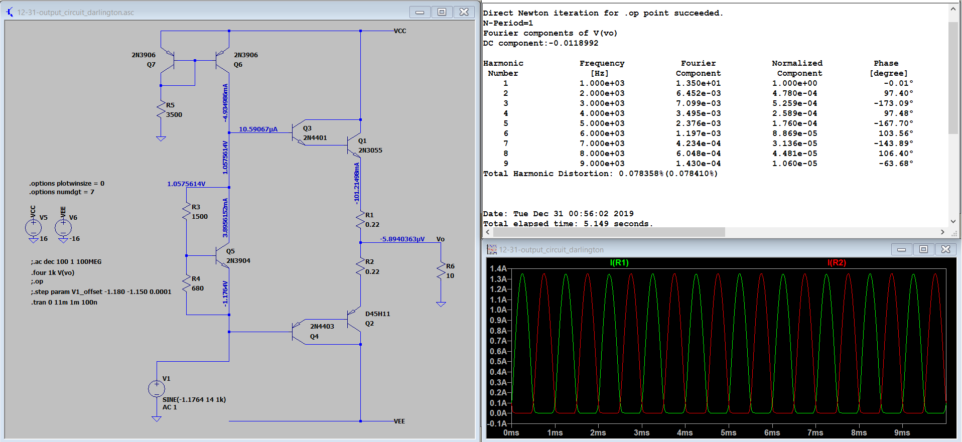

100mA quiescent current is ok or is it too much?
There is very low distortion right now.
I have Rin=19.2kohm which is good (with the simple circuit was less than 400ohm which is bad I think).
I still have to fully understand how the preferred values you were talking about works so some values aren't still standard.
I haven't found a real formula, now that I have a Darlington configuration, to choose the voltage across Vbe multiplier. That value determines the quiescent current, right? I started from 2V and I changed resistors values in order to obtain the desired Icq... Maybe there is the formula Vbb=Vt*ln(Ic/Is) that I have used with the simple output stage that I have posted some posts ago, but using the Darlington config I got confused...
  • 12-31-output_circuit_darlington.asc

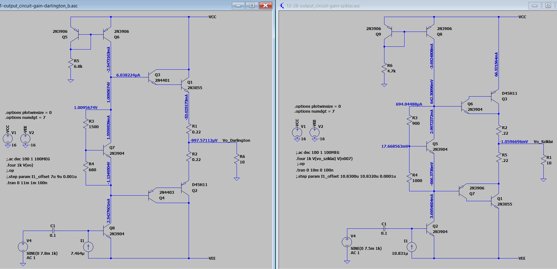

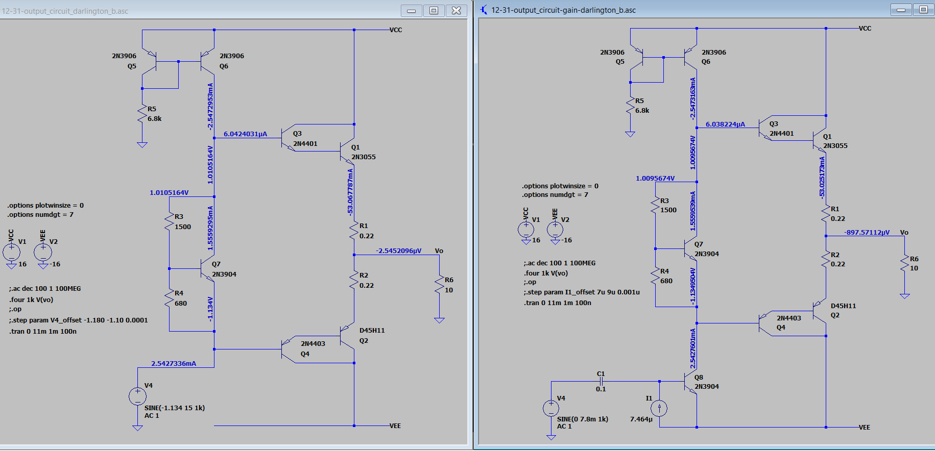

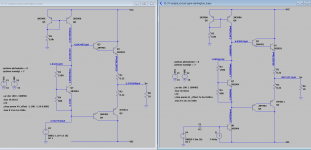

Hi all
I've lowered the quiescent current a little bit, I've used some preferred values for the resistors and I've added a CE stage...
I can't understand why I cannot have the full +-14V swing at the output now...
Have I done something wrong? How can I improve the situation?
I attach the last stage schematic where I can have the full swing at the output and the output stage + CE stage where I cannot have the full swing.

You reduced both the output and current source quiescent current when you increased R5 from 3500 to 6800 ohms and so reduced the available current drive to the pre drivers . Restore R5 to 3500 or 3300 ohms and reduce R3 to achieve the required output quiescent current . This should restore the max output voltage although with a Darlington output stage it is going to be close as it takes away another VBE voltage drop of available output voltage .

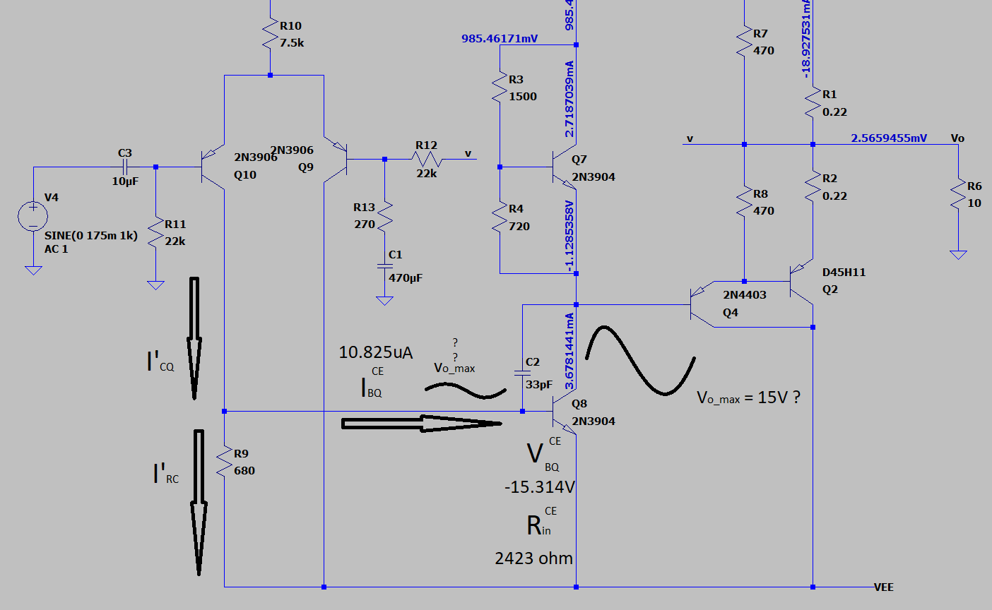

Hi all
When you project an amplifier like this one, what's the order of actions you follow? Do you project one stage after the other fixing the behaviour of each one before proceding with the next one?
I arrived at the input stage starting from the output stage.
It looks like I can obtain +-14V output voltage sweep. Good.
I have tried to adopt formulas used in class with ideal bjt (constant parameters) in order to find out the collector resistor value of the input stage but I got a negative resistor. I tried to consider the maximum voltage sweep that the input stage has to guarantee to the gain stage. I obtained this value dividing the voltage sweep at the input of the output stage (+-15V) by the voltage gain of the gain stage. Then I applied kirchhoff's node law.
Dropbox - formula dubt.docx - Simplify your life
I even asked in another forum about this problem: I was told to adopt 1mA in the input stage branches...
I did it but I still haven't understood why the method seen in class doesn't work in this case.
Dont' I have to consider voltage sweep in my computations? It looks to me that the method of considering 1mA is focused on quiescent voltages and currents. Am I wrong?

The output of the input stage is a current, not a voltage, in other words the input stage is transconductance amp (voltage in, current out), the VAS is transimpedance (current in, voltage out). At all but the lowest frequencies the transimpedance of the VAS is determined by the Miller compensation capacitor, not the transistors, since it sets up local feedback around the VAS transistor(s).
The transimpedance of the VAS at DC is affected mainly by its loading, which is why its typically given a constant current source load (very high impedance).
It illuminating to look at some typical voltage and current levels in the various stages:
The input might be 1Vrms with 50k load - thats 20uW at 50k ohms.
The signal fed to the VAS at HF, 7mV rms and 1mA rms, ie 7uW at 7 ohms (less power than the input, power loss factor 3 (-10dB), voltage loss 140, current gain 50)
The signal from the VAS to the OS: 30V rms, 1mA rms, ie 30mW at 30k ohms (power gain 4000 (+72dB), voltage gain 4000, current gain 1)
The signal from OS to speaker: 30V rms, 4A rms, 120W at 8 ohms (power gain 4000 (+72dB), voltage gain 1, current gain 4000)
Thus the VAS does an extraordinary job for a single transistor. The input stage's job is mainly to be differential, not to amplify.
